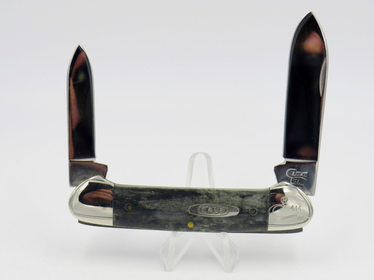

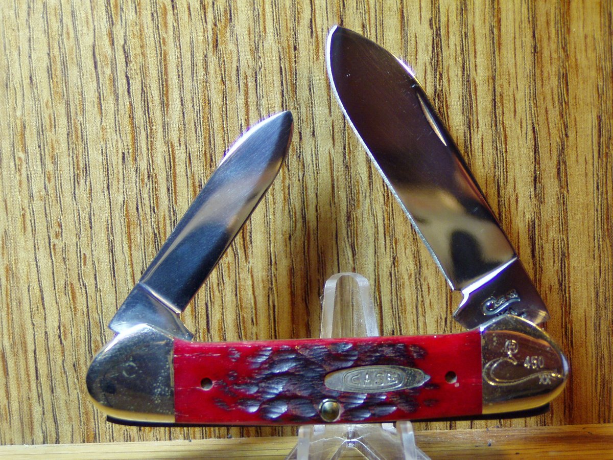

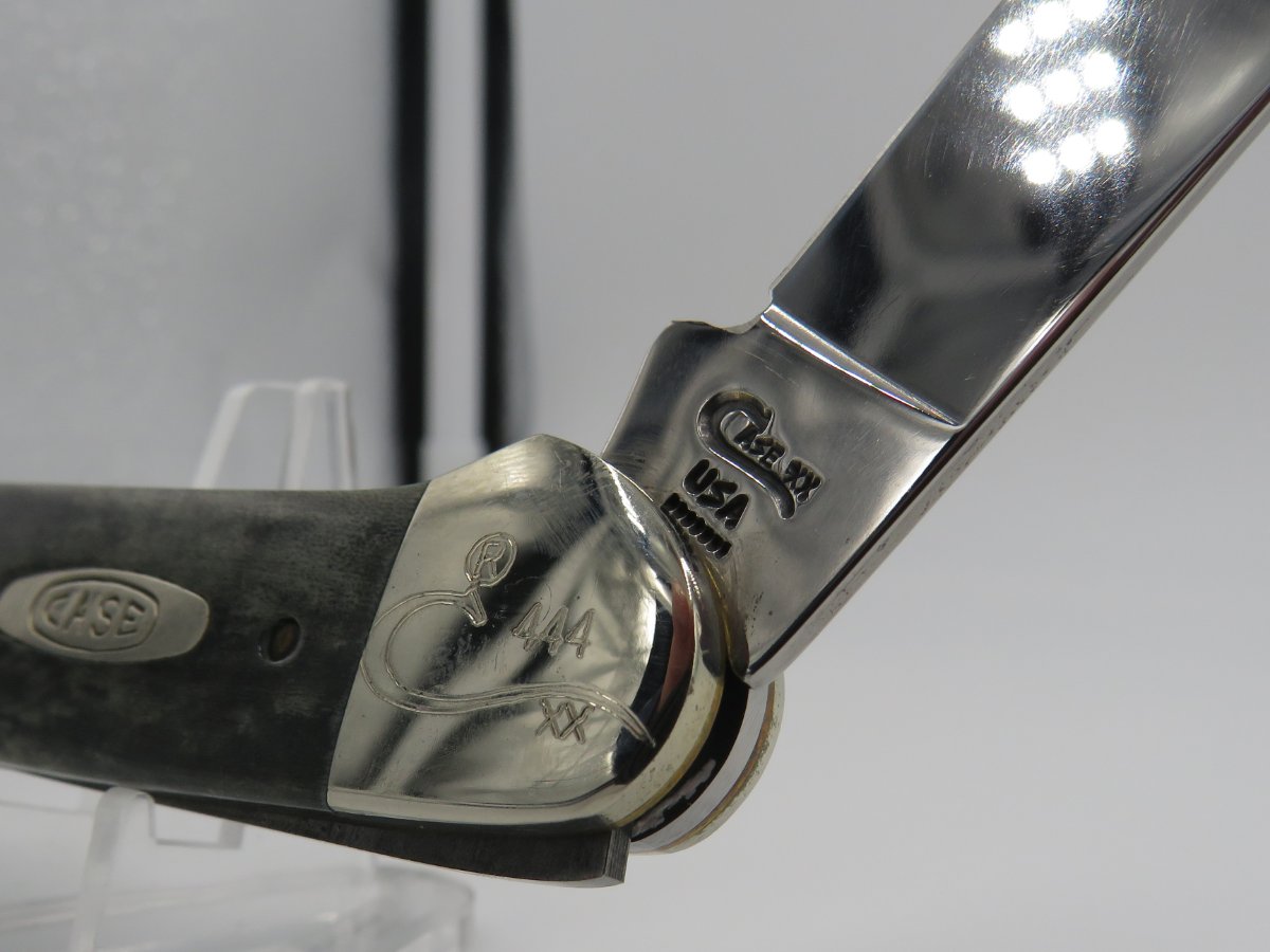

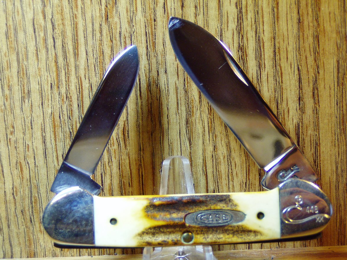

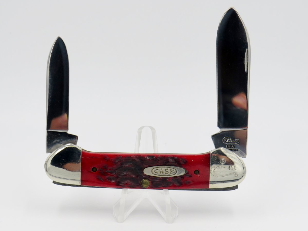

Gary is correct with accurate information about the lost Dot Series. Here's some pictures you may like to see of those tang stamps.

- 1967redrider
- Posts: 21571
- Location: Alexandria, VA
Re: Missing Archive of Case XX
Isn't this knife of Jerry's an example of the lost dots tang stamp? Or am I not understanding?
Not exactly. I’ll try to explain it as I understand it. Beginning in 1990 Case changed their date code stamping from the 20 years old “dots” method. Dropped the dots and instead stamped the year of manufacture on the tang.
19 USA 90.
They did this in 1990, 91, 92 and part of 1993. Then they changed back to using dots again. Then they decided to produce a limited run of knives having the “missing dots”, in other words a run of knives having 10 dots (for 1990), 9 dots ( for 1991), and so on. These knives all had serialized bolsters. In other words, as they would have been had they been produced in those years. These limited runs were called the “missing dots” series. Which is kind of confusing because those limited run knives do have dots on them. So if you see a 1990 knife without the 19 USA 90 stamp on it but instead it has 10 dots and scrolled serialized bolsters, it’s a missing dots knife. See the examples JSC posted earlier in this thread.
The quote from Case Historian Katie Shonts lists the patterns and quantities produced.
19 USA 90.
