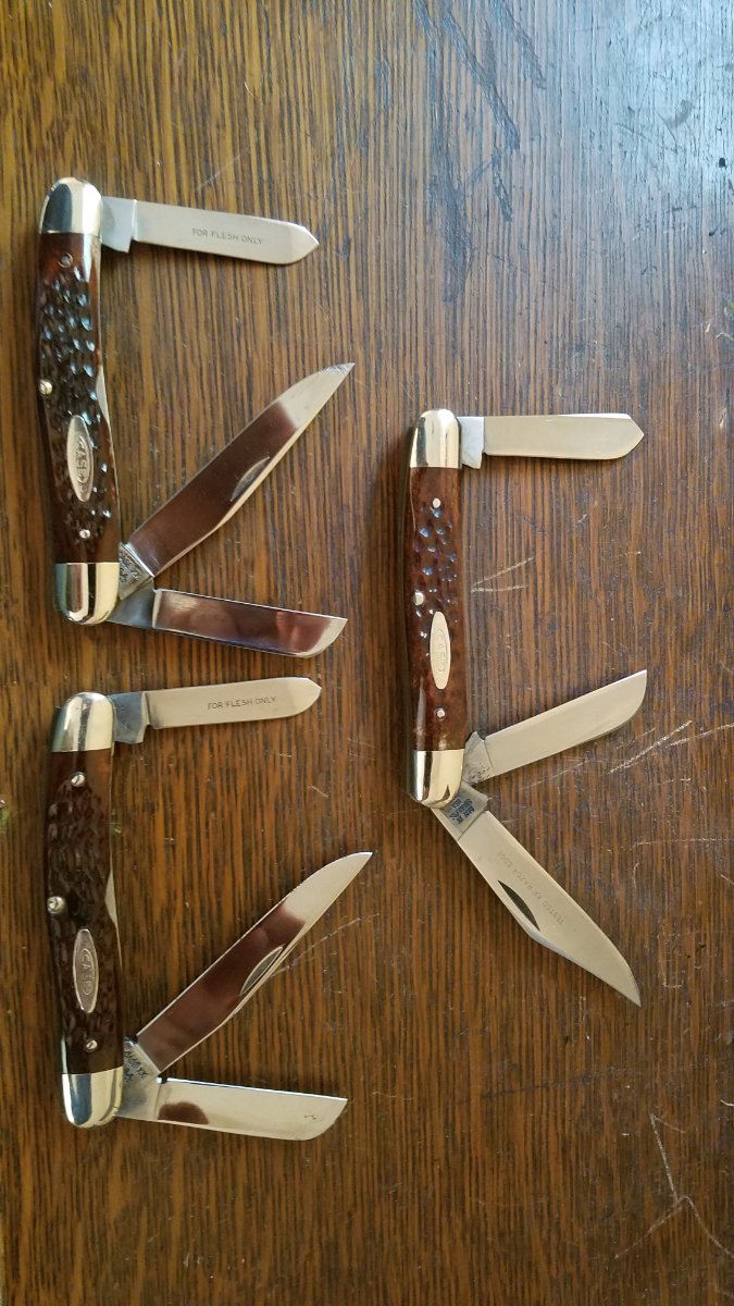

I have 3 70s 63047 patterns that all measure 4 inches closed....I've seen some for sale that say the measurement is 3 7/8....are there variations within the same pattern number?

You are correct in that a 63047 is 4” long. But a 6347 is 3 7/8” long, that’s probably what you’re seeing.
Additionally you’re 047 knives have a more slender California clip blade, while the 47 patter has a traditional, wider clip blade.

When I carefully measure each pattern, I get 3-7/8" closed for the 6347 and 3-15/16" closed for the 63047.
So they really were made on different tooling though with a similar appearance.

One thing I got into was I had a 64047 with a bad back handle. I bought a 6347 with bad blades thinking the handles would interchange and they will not. One is just a bit shorter than the other. You could make it work with some effort but they aren't the same.

Thanks everybody.....enjoying this forum...hope the pictures show up
- treefarmer
- Posts: 15167
Re: Case xx 63047 measurement closed
Yes Sir, the pictures showed up! Great lookin' Case knives.

Had a similar experience with 6332 pattern....my 1972 is 3 5/8 and have a 79 6332 that is 3 1/2....same as a couple of my later 63032 patterns

Explanation for that...when Case changed the tooling for the 32 pattern from the original style 32 to the new 032, about 5,000 to 6,000 of each (two blade and three blade) were made with the new tooling but with the old pattern number (6232 and 6332), before Case started stamping the new (62032 and 63032) pattern numbers. So the ones with the new tooling but the old number are "transition" knives.
