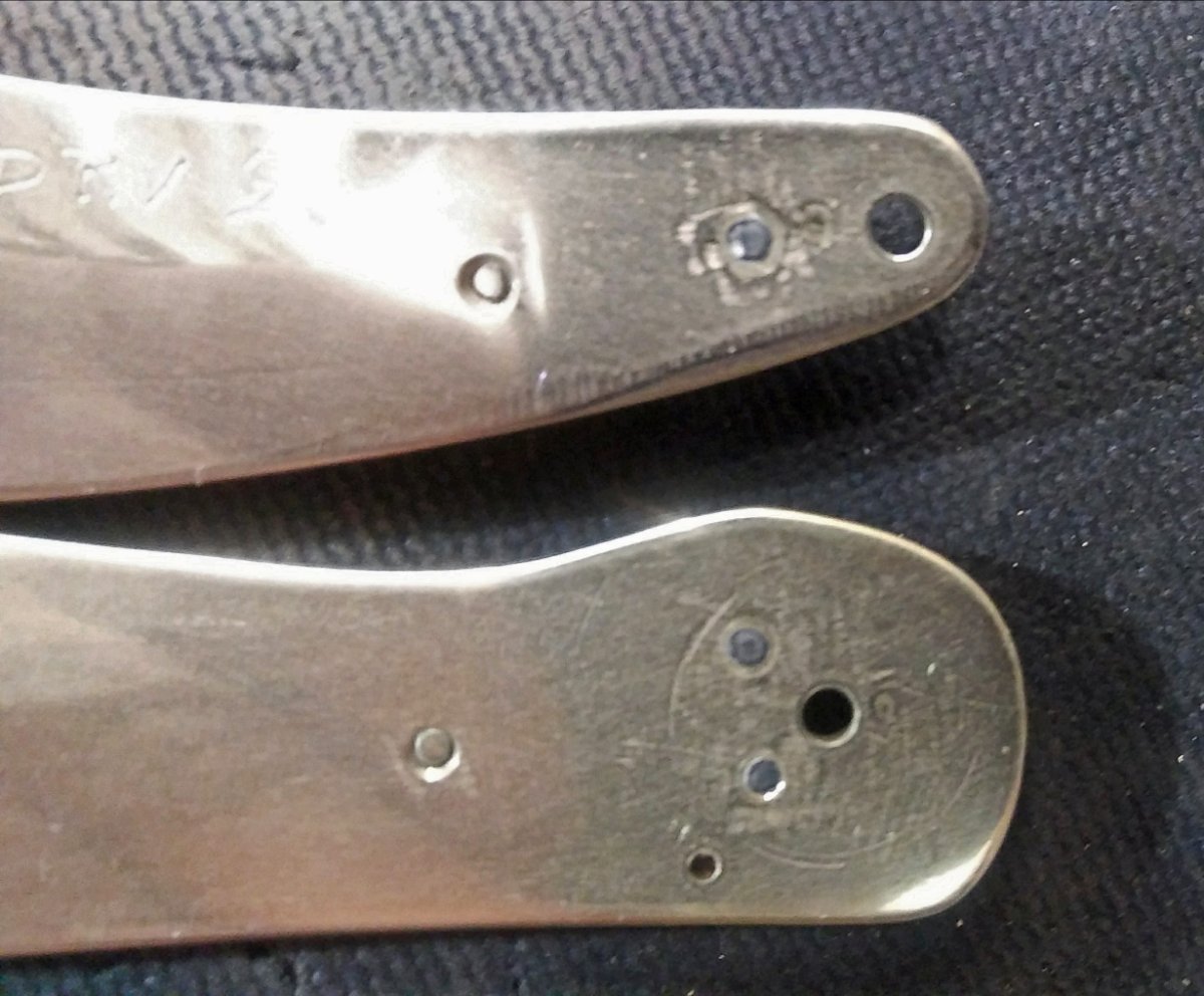

Jeff,
Here are the insides of the bolsters that fell off of the Boker folding Hunter. I attached them using 1/16" pins.
I drilled the 1/16" hole into the bolster and then used a tiny ball burr to widen out the bottom of the hole so the pin could mushroom out and hold tight.
I used two pins in the front bolster which was much wider and thicker but only one in the rear bolster.
They are quite secure.
