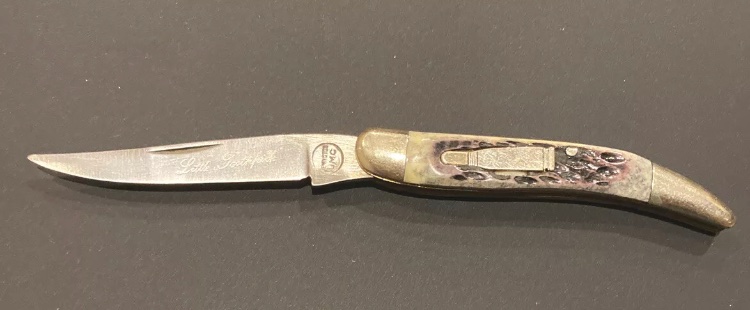

Two knives. What do you guys think? Real or Fake?

Unquestionably fake. The knife with the bullet shield is a gunstock pattern. The original bullets did not include a gunstock pattern. The bullet shield is wrong. The tang stamps are not authentic. The bone is very wrong. It is a very egregious fake.

Don't look right to me. Too rough. J.O'.

Two of the worst fakes I have ever seen.

Ditto what Steve said,really horrible fakes. ::td:: ::td::

I'm not an expert, but:
The hafting on the handles is crude, so is the jigging. Shield is poorly placed. Blades obviously cold-stamped. I've seen knives made in Pak E. Stan of better quality.

The pictures are a little fuzzy, but it looks like the tang on that Toothpick was sanded heavily before it was stamped. Someone was probably trying to remove the original name.
