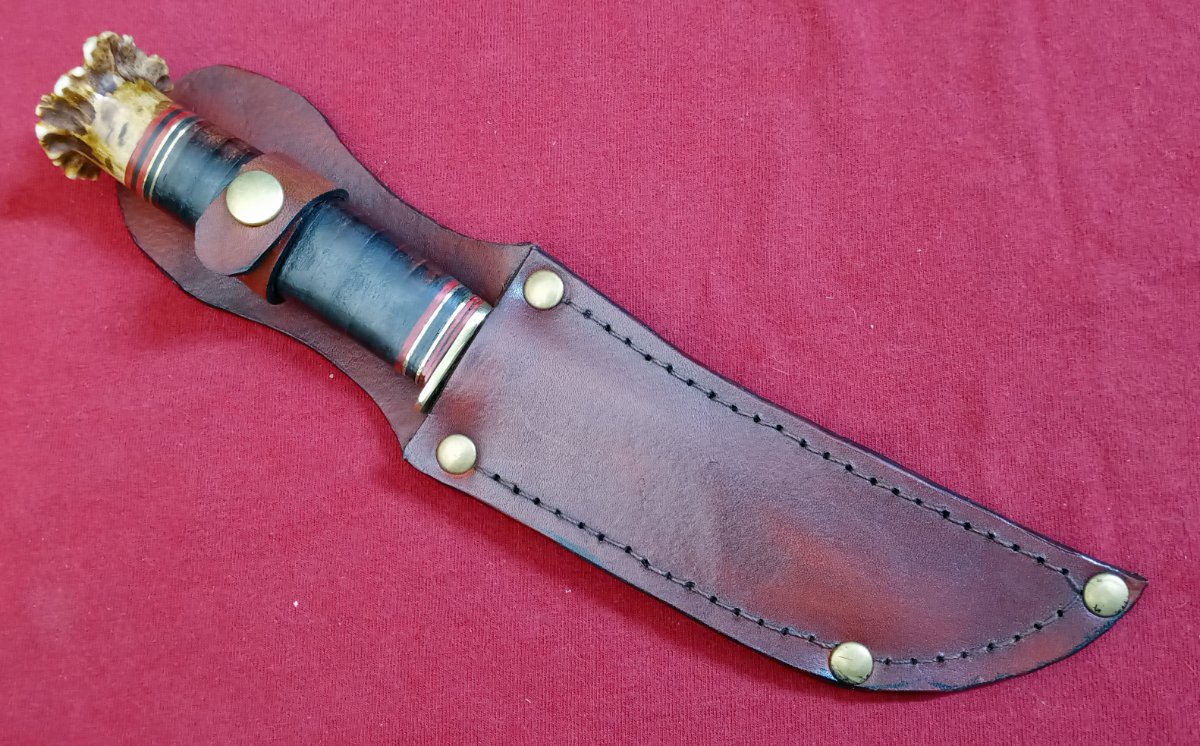

Here's an old Marbles Gladstone, Michigan I have been working on. It had a Bakelite pommel on it which was in several pieces. If I am correct in my understanding the Bakelite pommel was used in World War II as a substitute for a more durable metal pommel.

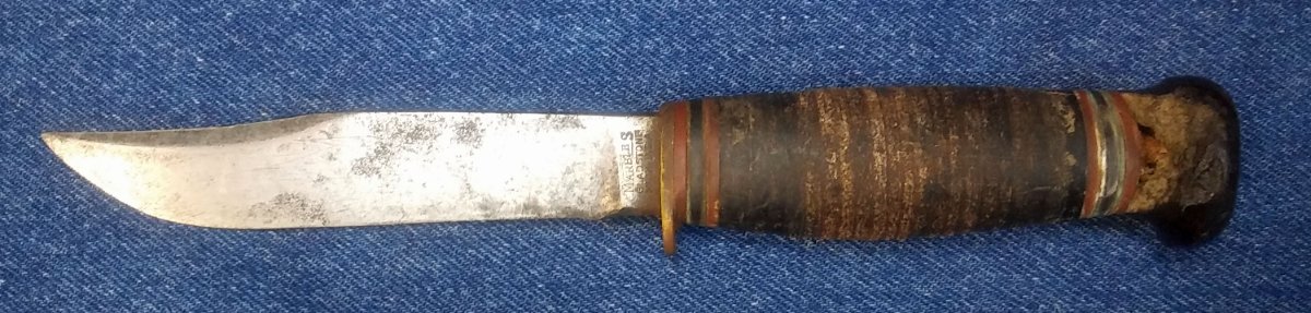

This is what the knife look like when I got it This was my first remove and replace all of the spacers on a stack leather ring handle. I learned quite a bit had in the process. And while I didn't have thick enough colored spacers I had to glue. I don't think it's a perfect job but it was certainly a learning experience and a lot of fun to do. I have another Marbles Gladstone I'm going to try something a little different with it.

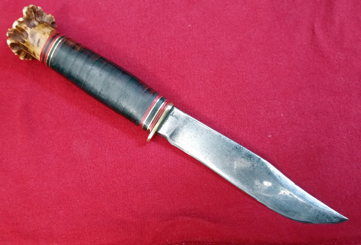

As I said is not perfect, but it will give somebody a lifetime of service. I also made the sheath and hand stitched it. It's quite a bit heavier leather than is usually a found on old knives.
I used a deer antler crown because some of the newer Marbles had Stag or bones pommels on some models.

Wow Dale, that’s great! I really like the crown pommel! Excellent work!

Morning Dale. Your restoration work on the Marbles knife is very good. Really liking that crown pommel. Oh! And your sheath is looking like a perfect fit. Very nice as well. Thanks for showing us. Steve B.

That is a BEAUTIFUL....... right-handed knife you have dressed up there, Dale!
I love the way you turned the protrusions on the base of that crown to make it comfortable to a right-handed hold.
Wonderful work as usual!
AND.... yes, that sheath is VERY nice!!

Really nice work Dale! I really like your choice of an antler crown for the pommel. Much more creative and in-keeping with the style of the knife and much, much better looking than a plain old blob of aluminum.

Like everyone else has said that is some expert work. I wish I had the talent and knowledge to work on knives like you do. Thanks for sharing and I hope to see more of your work.

The crown pommel was a bit of a challenge, this is first time I had used one. Mike, you are right buddy,
it is a right handed knife. I did a lot of checking to be sure it was comfortable in my hand.
David, you could do this, it isn't hard. I didn't know anything about fixing knives, so I bought some cheap, broken knives and started trying to fix them. Soon you figure out what works and you build on that knowledge. Don't by afraid to fail. Often I lessen more from failure than I do from a success!
Thanks Byrd, I enjoy working with the leather, both the rings and the sheaths. I am fortunate to had a shoe repair shop in my town that carries a nice selection of leather, leather tools, dyes, polishes and leather treatments. They sure do improve the look of the leather on the sheath and the handle.

Looks great to me. Love the antler crown. Great job Dale.

WOW Dale, that is excellent work! Great choice of crown stag, you really did this knife justice!
