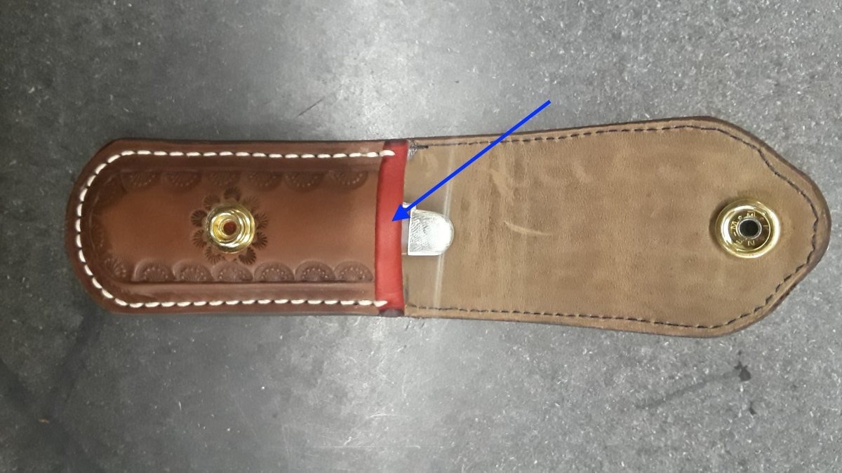

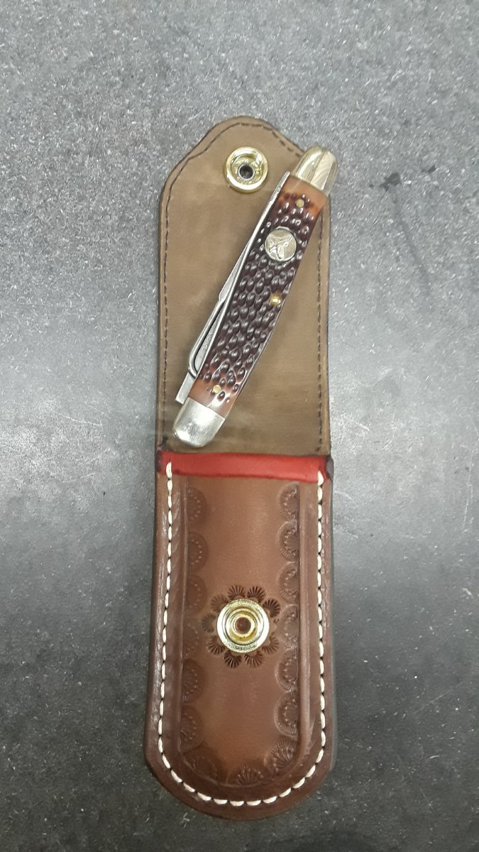

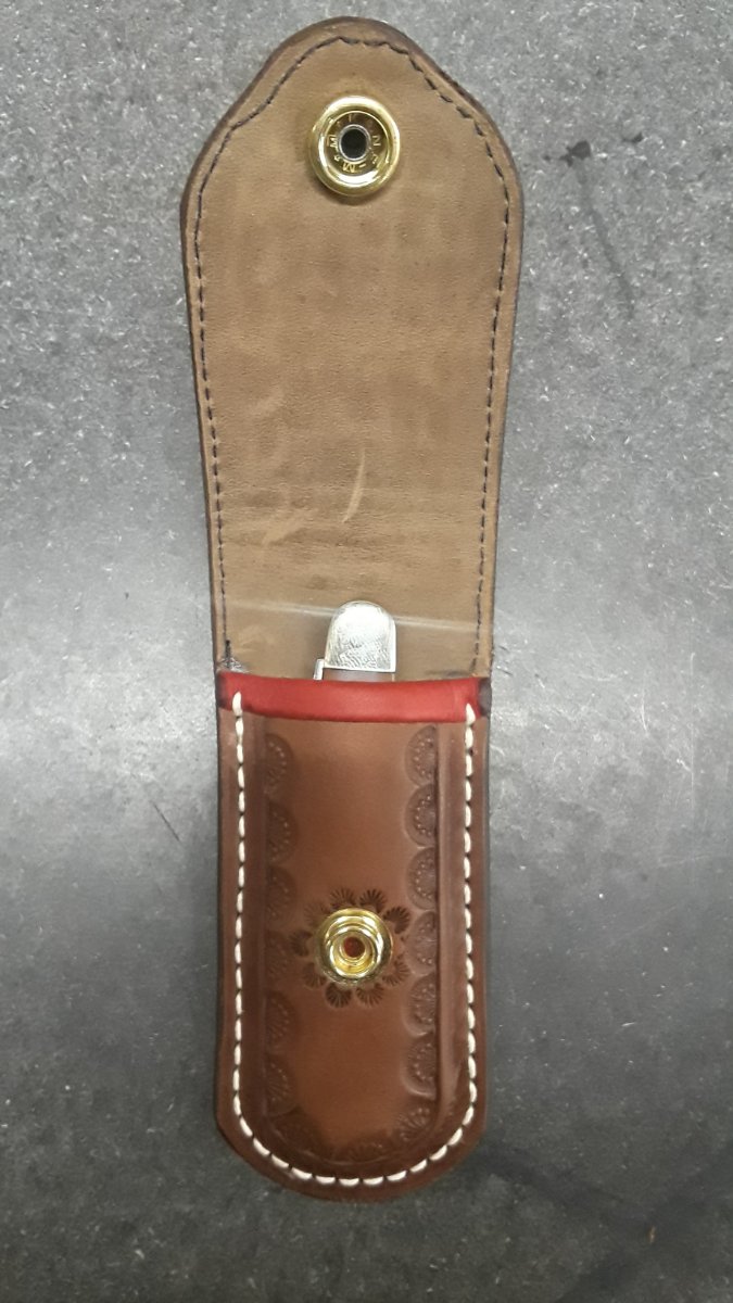

I played around and made this one up today. Belt loop pouch sheath. I had the Remington R-1 around the shop. Box had 1988 written on the back so maybe it's that year. Near as I can tell it was never used. Sheath has some stamping work lined with red leather and the back has oil tan on it figured I'd try it to see how it worked. Open to thoughts as always.

The flap is a little wide for my taste but it's a very good looking sheath. Stitching looks solid and well spaced. I also like this red strip to cover the top. Nicely done. ::nod::

It's funny the pics make the flap look much wider but in reality.its just about the size of the main body. Proportion is so important in my opinion and I appreciate the feed back.
The red is leather rolled over and lining the Inside it's also stitched in place under the rolled and then glued.

Lol I just responded to that! No worries the red leather which I think is deer skin lines the entire other side. You cant see it obviously. I learned how to do this from Paul Longs videos about sheath making. He is a master sheath maker. I dont know him and have no affiliation with him but his videos are really informative. That red liner is stitched then contact cement and rolled over the whole back. I put the stud and snap in prior and cover it with the liner thus protecting the knife!
