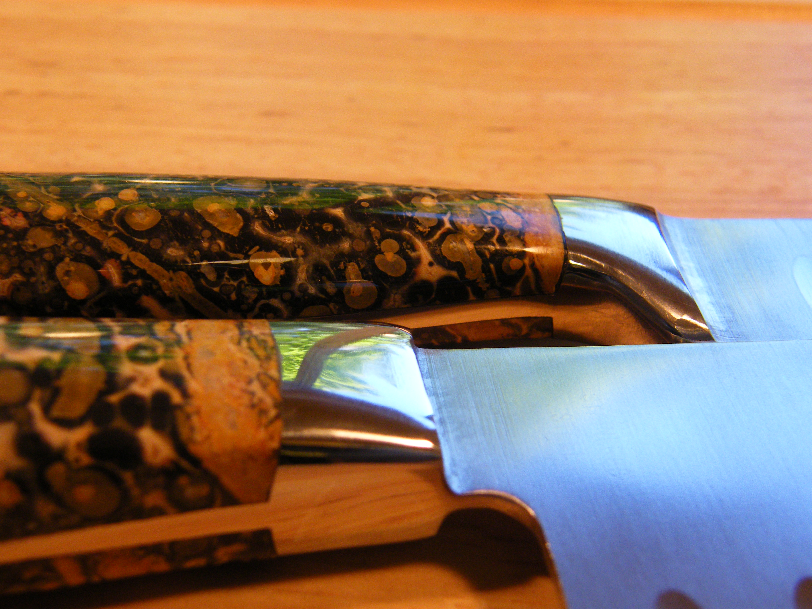

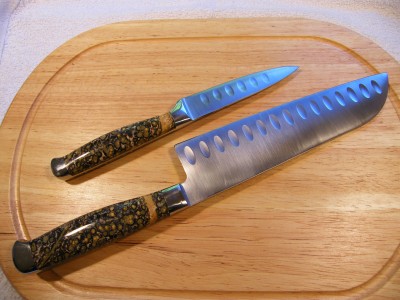

Here are a couple of pictures of a kitchen knife set I did recently. I am doing two 6 knife sets for my son-in-laws for Christmas using Viking Knives (Gude) from Germany. The stone used is Leopard Skin jasper from Mexico.

Very nice Redrummed!
I hope we will be able to see a lot more of your work in the future.

My wifey puts all knives whe uses in the dish-washer.
Would your stone handles hold up to that ?

I would say that the stone handled knives are not dishwasher safe. They would bang around and potentially chip plus if water found a way to get behind the scales they would eventually come loose. When I need to remove them I put them into a pan of cold water and bring it to a boil until the adhesive weakens. I use loctite 324 and 325 which are designed to weaken for removal at about the point of boiling water.

Oh,and by the way,real nice work!
