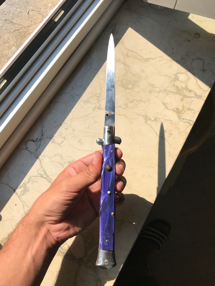

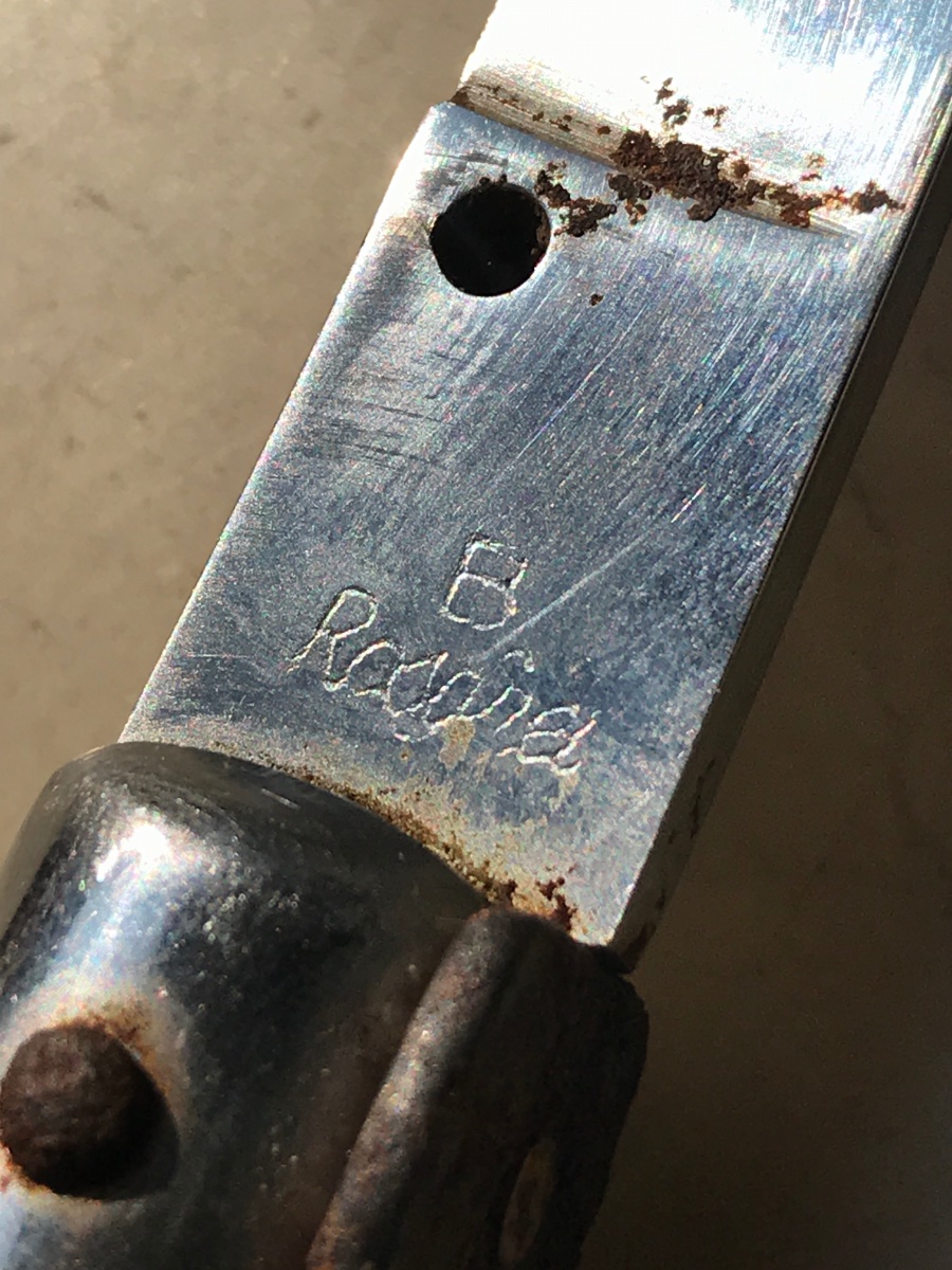

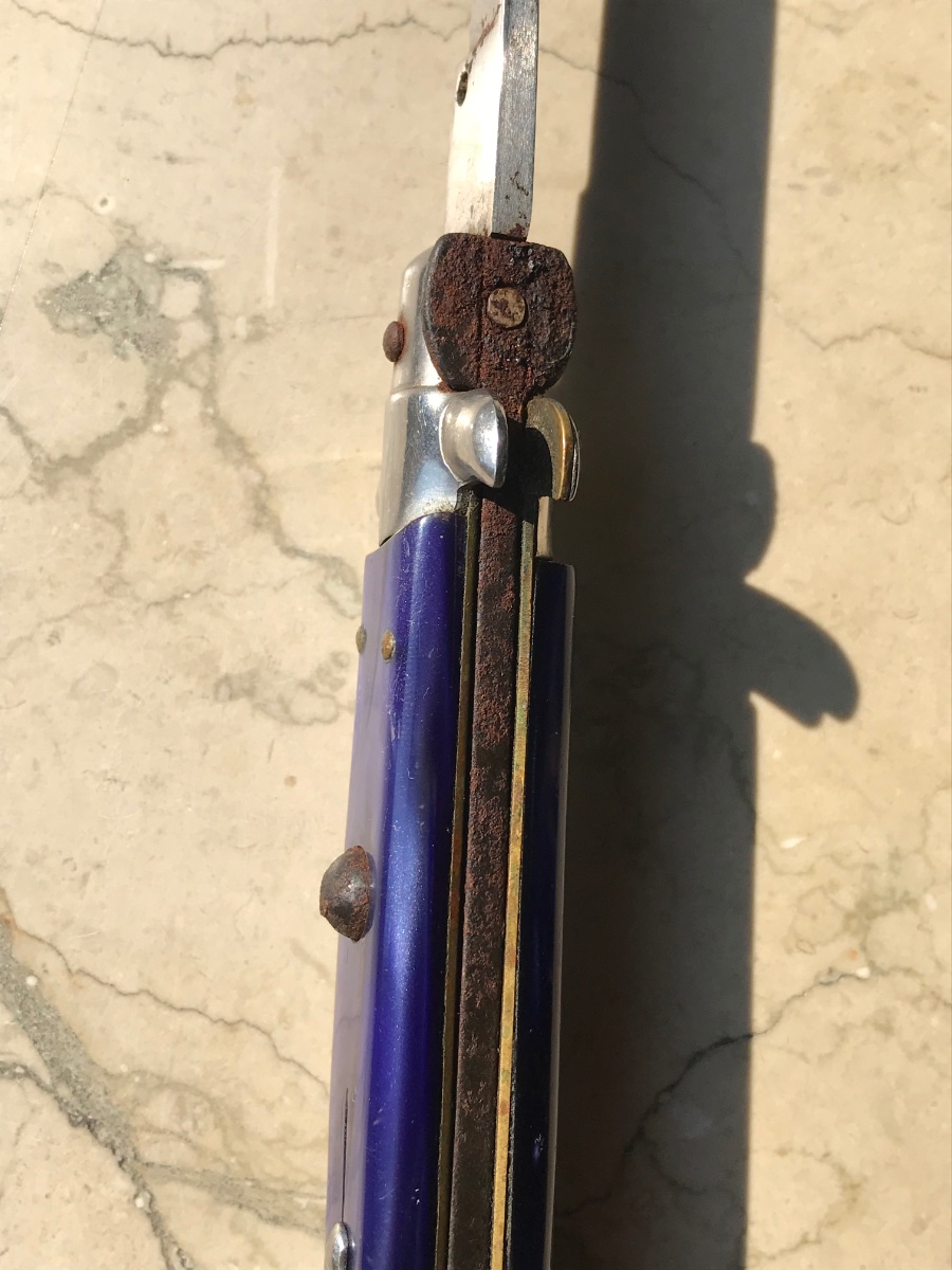

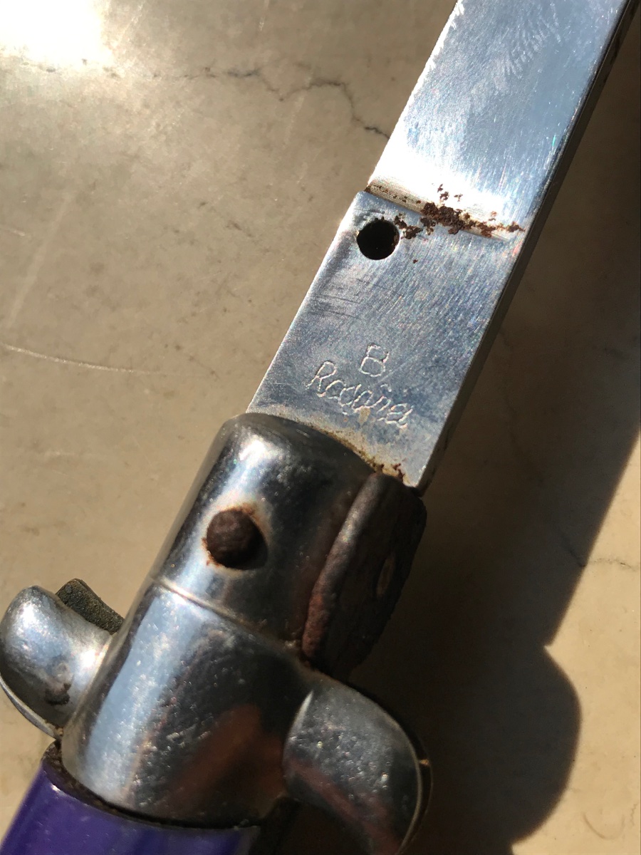

Hello everyone , I found this knife in South of Italy , at the vintage market. It’s a real one or fake ? How can I clean it from the rust ? Thanks

Well if it works it must be a "real" switchblade!! It is not a really old one since it has the rocker bolster to release the lock and the acrylic scales. To remove the rust from the blade a little 0000 steel wool and light oil will do. I'd use a fine cut file on the pivot pin and the push button will be harder but the steel wool will likely be best there too. Tape off the acrylic so the wool doesn't dull the finish while working on the button.

Gunsil! What makes you say his knife is a swivel bolster release? Could it not be a picklock? Thanks!

The front left bolster is curved, this is a swivel bolster. Pick locks will not have a curved bolster. Unless yours is frozen due to rust if you pull back on the top of the front guard (on the curved bolster side) the bolster will lift the lock bar. Also no antique pick locks had acrylic handle scales. That rust on the backspring will be tough to remove, likely need a file there too.

Thanks Gunsil! I never knew how to spot a swivel bolster from a picklock, and your points make it clear! I'm looking at a S/B and a P/L in my collection right now and I definitely see the difference.Gunsil wrote: ↑Fri Aug 21, 2020 10:11 pmThe front left bolster is curved, this is a swivel bolster. Pick locks will not have a curved bolster. Unless yours is frozen due to rust if you pull back on the top of the front guard (on the curved bolster side) the bolster will lift the lock bar. Also no antique pick locks had acrylic handle scales. That rust on the backspring will be tough to remove, likely need a file there too.

You're welcome sir. If the bolster were square cut it could not swivel.

That is an Italian swivel bolster with a set of blue acrylic scales. It is an intereting collector's piece that should be a wonderful first knife for any collection. I hope that you gently remove the rust and lube it properly so that the cancer (rust) doesn't destroy the blade, back and kick springs.
