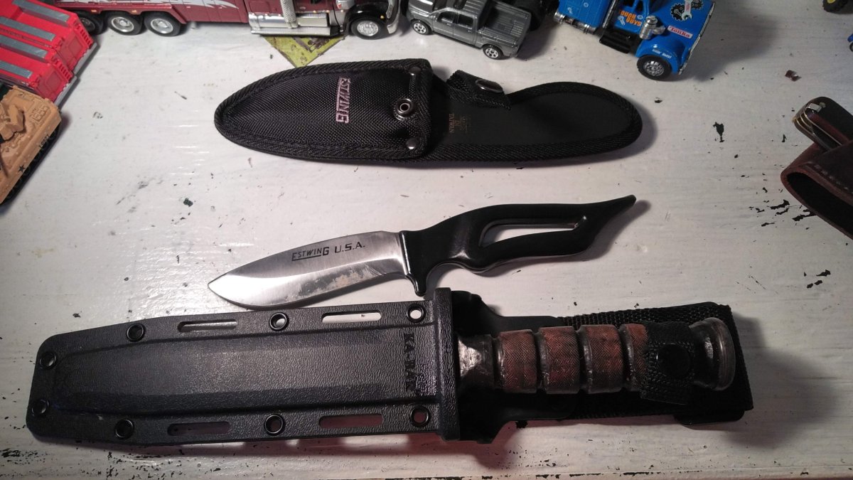

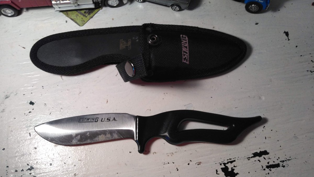

The knife is as heavy as heck. My Kabar weighs less IN ITS KYDEX SHEATH than just the knife, despite my Kabar having a 3" longer blade, and a longer handle. Main reason--whole thing is forged in one piece. There is no real "tang" at all in this thing.

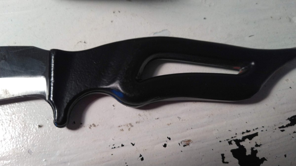

The handle itself. Feels OK, but I would have completely eliminated the protrusion towards the butt. Looks like Estwing took a little too much inspiration from Gil Hibben; with over-stylized designs. The protrusion prevents me from using the butt as a hammer, and it sticks into the side of my forearm if I'm resting my hand at my side. May just fire up the Dremel and reshape that part to my liking (a completely flat part where the protrusion was should work fine). The black part is just black powder-coat paint. Another area where I may improve, by stripping that off and dipping it in Plasti-Dip. That will make it gripper, as well as give it a bit more insulation from extreme heat and cold. I can see this thing being a pain in the backside when winter comes due to the handle being part of the actual blade blank.
Blade thickness is about the same as my Kabar. Couldn't find my caliper, so I haven't measured it yet.

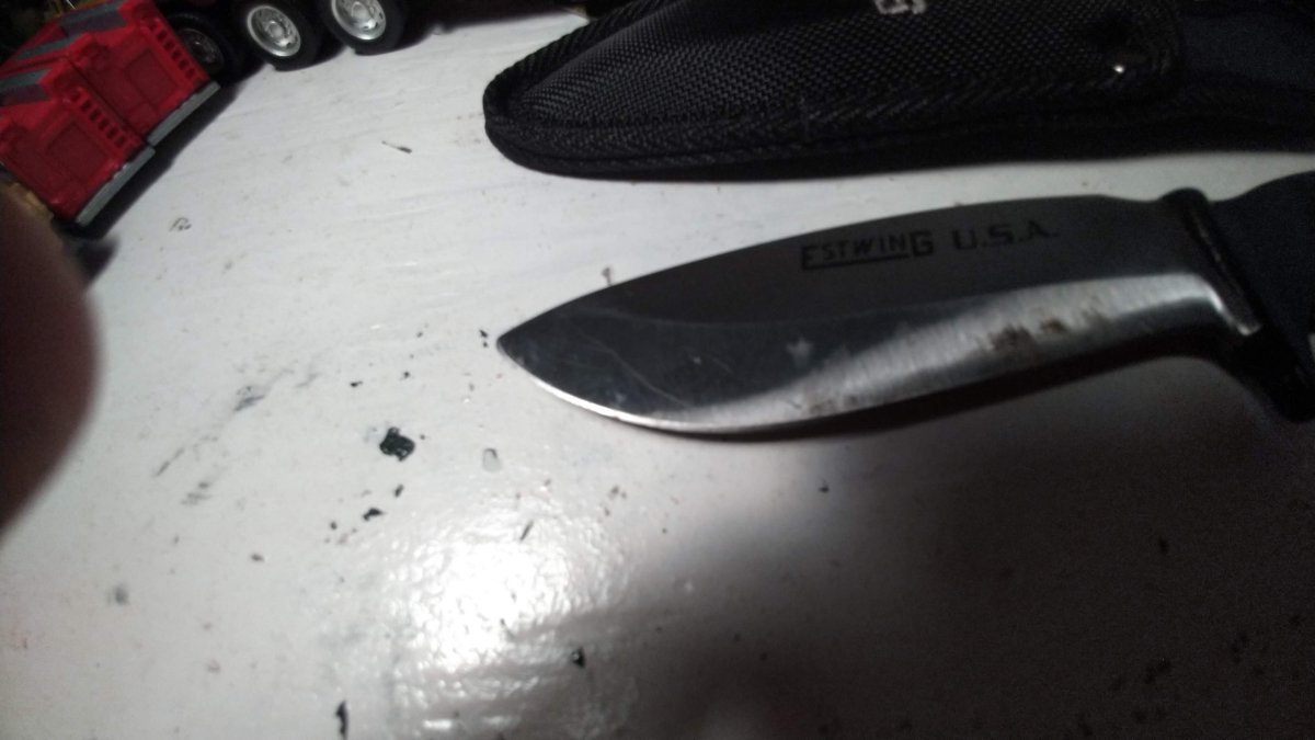

Grinds may be a little iffy. The tip is blunt, but blade is acceptably sharp for what I'll be using it for. I used it to open a few other packages I got in the mail today (one of them being a 20 oz. Estwing hammer--yes, that's what Estwing is known for, and does best).

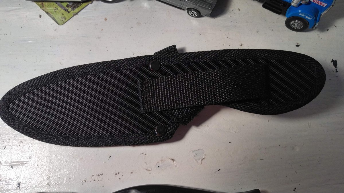

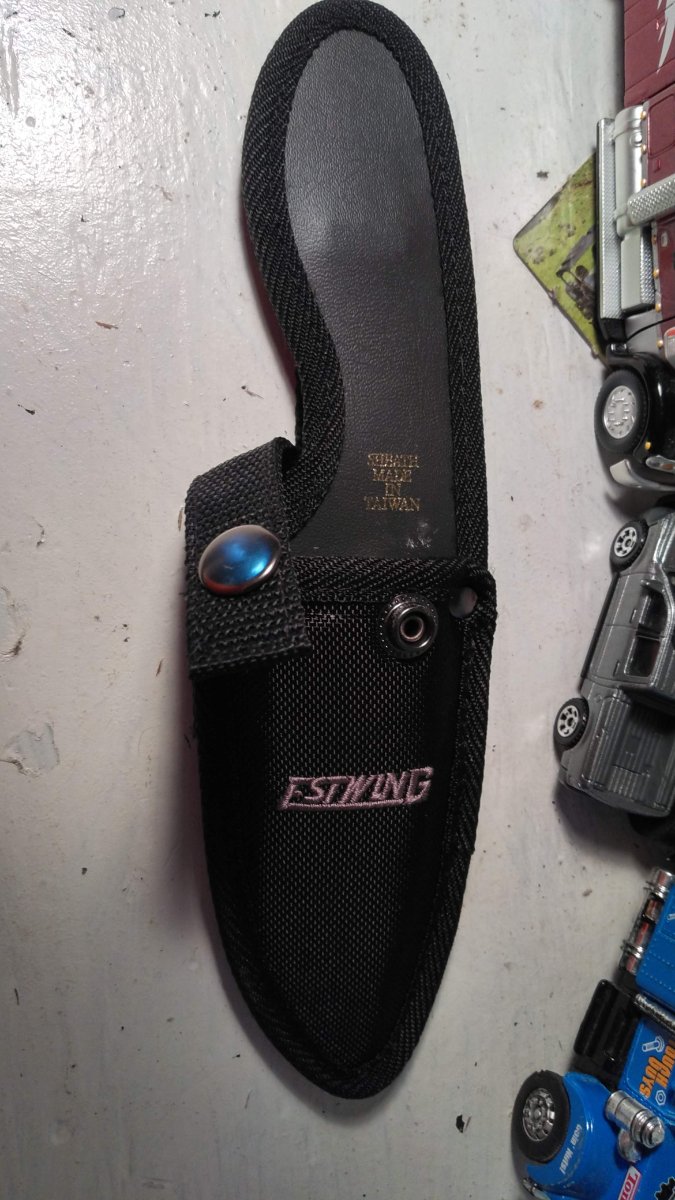

The sheath is the exact same Taiwan-made ballistic nylon affair as the hatchet will come with. My hatchet's been on my belt, in a pack, behind the seat of a UTV, and thrown in the bed of that same UTV alongside my chainsaw stuff, and used to cover the edge while I used the back of the head to hammer in a fencing steeple or a wedge. But, the sheath still looks pretty good, and holds the hatchet tightly. Nylon sheaths don't work well with me, yet the sheath has held up. But, this sheath isn't as good. Not to mention, the top part is stiff and hard, and digs into my side. Does not hold the knife well at all. I will likely look into a leather option.

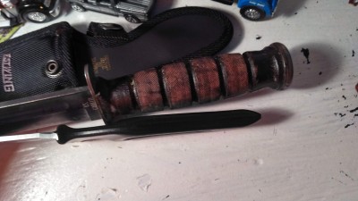

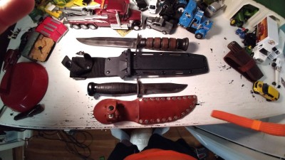

My go-tos for hard use will remain the Camillus Marine Combat Knife (previously mentioned as being a Kabar) and a just after WWII-made MK I Deck Knife. They are better balanced, look great, are very comfortable to use for extended periods with their stacked leather handles (and notice, for some reason, the Camillus has a diamond-shaped texture added by a PO to the handle; which makes it really comfortable), good for just general knife stuff, but just as strong for chopping and cutting. Plus, the Marine Combat has a steel pommel for use as an emergency hammer, and the current MK I Deck Knife, by Kabar, has a steel pommel as well; and I plan to add one soon. The old Camillus has a Bakelite/Tenite pommel. And I'm sure both knives have some interesting stories to tell. The Marine Combat appears to have been owned by a SEAL before, with modifications they often made having been done to it.

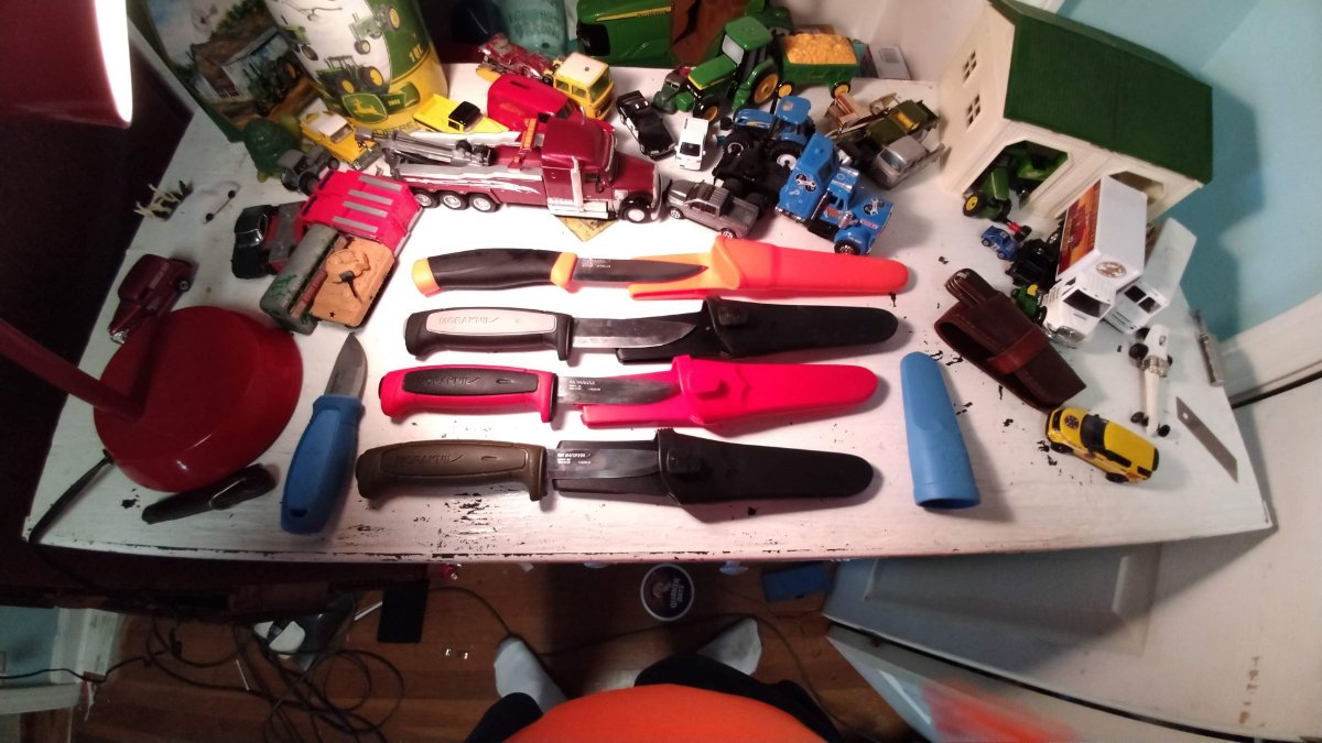

And for general use, most Mora models are more comfortable, but just as strong. Also, most are really lightweight. I have a couple of Basics (all carbon steel), a Robust (rubber handle, thick 3.2mm 3.75" blade); a Companion (stainless, non-HD thin blade), an old Scout knife, and an Eldris; as well a Bushcraft (with a thick 3.2mm blade that is 4 1/4" long) that is in the mail. The Bushcraft, I am almost certain, will be a much better all-around knife than the weighty Estwing, with a thick blade out of a carbon steel that does resist hard use well. This is pretty much all I own but the Scout--which needs a new handle and a keeper strap on its sheath.

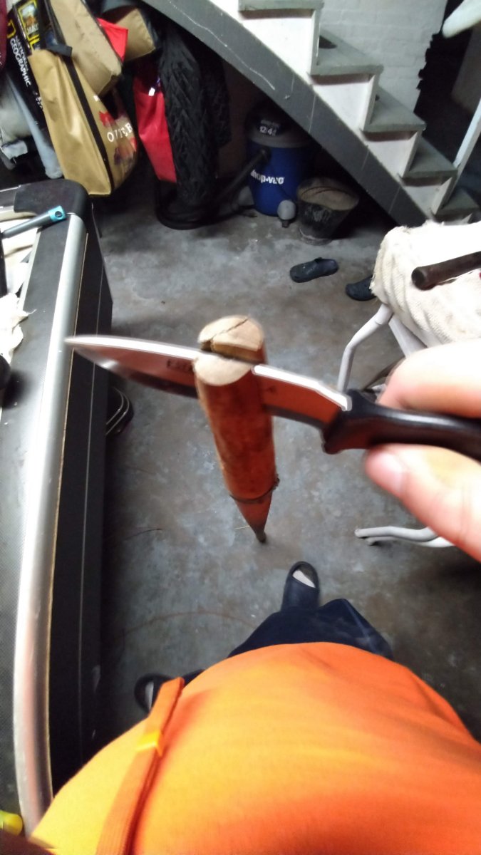

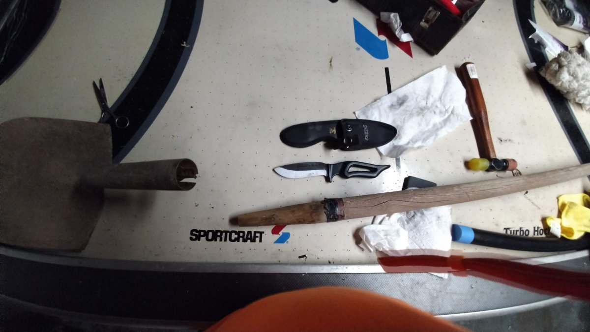

Well, shovel handle popped off an old beater shovel, and I needed to put wedges back in. To split the handle, I decided to use the knife. Something I often criticize others for doing with their knives is batoning, but I couldn't find the Mora chisel I typically use for jobs like this, and this knife seemed strong enough. I didn't use a big hammer (my Harbor Freight dead blow is in the tractor toolbox, as that's where it sees the most use--knocking pins; need to buy another. NEVER USE A STEEL HAMMER. This one has soft rubber and hard rubber (or soft plastic) inserts and is a roughly 10 year old Craftsman made by Vaughan. Really handy for not marring up what you're hitting.
Didn't take much.
I didn't note any edge damage. Steel, again, must be what the hatchets use. And because I used a mallet, I limited damage to the spine.
Didn't take much.
