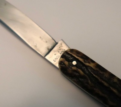

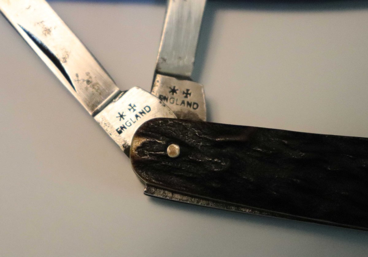

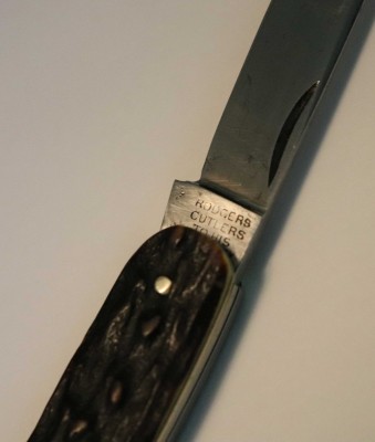

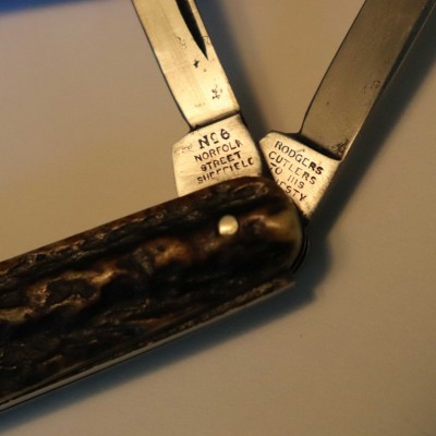

Hello, my grandfather recently came across this knife and bought it. All my knife ID & Price guides don't cover the Rodgers England knives. I'd like some help estimating when it was made, and perhaps a ballpark value? I've found somewhat similar knives and tangs online and in AAPK but would like confirmation from those with more knowledge.
closed length is 3.5 inches
3 blade split-back whittler
stag covers, bare-head (no bolsters)
all blades stamped front side and rear side
Main Blade front "RODGERS CUTLERS TO HIS MAJESTY" and rear "ENGLAND"
Small blade #1 front has Star & Cross and rear says "RODGERS CUTLERS TO HIS MAJESTY"
Small blade #2 front has Star & Cross and rear says "NO. 6 NORFOLK STREET SHEFFIELD"

With those marks it would be made between 1910 and 1952, hard to narrow it down further. Edward VII was 1901-1910, George V and VI 1910-1952. I have seen Rodgers knives from Edward VII with a crown and ER indicating his reign so I think the "to his majesty was more likely used during the two Georges but no way to tell which one. No idea on value, the early Rodgers (pre 1891) are more highly valued than the later ones. Maybe somebody else will chime in with a value. I usually look up similar knives on ebay and go to "sold items" on the left toolbar to see what they have actually sold for. It is possible that it was Edward, but with the "England" on the blade it can be no older as that mark was required after the tariff act of 1890 and Victoria ruled until 1901 and it would have her royal warrant mark and/or "Cutlers to Her Majesty". Pretty knife!

This is either a Sleeveboard or Senator whittler. Is the depth from top edge of stag to bottom edge exactly the same at either end ? or is there a slight taper ?
It is a very nice knife, quite collectible but not high value. The condition looks to be 'top notch'. I think this was made between WW I & WW II. The high value Jos Rodgers knife are those made prior to WW I.
Prices for most vintage folding knives are down at present. I have a friend with an extensive collection of some of the best Sheffield folding knives made from 1830 to ~1910. He has been wanting to sell a few but cannot get even 1/4 of what he paid about 5 or so years ago.
I doubt ebay has sold enough Jos. Rodgers knives of similar age and condition to establish 'market value'.
I like it !
Ballpark value ? $200 in my ballpark. Others might guess higher or lower.
You could price it high and see what happens. If no takers lower by $50 at a time and at some point someone will grab it.

As others have stated the dates could be anywhere from 1901-1952. I am going to go out on a limb(without a saw)and say that it is probably the earlier date.I am only basing this on the appearance of the stag handles vis-a-vis the relative side to side matching and the coloring. The newer stag handles just do not have that look.JMHO

Thank you all for all the helpful information. The knife does indeed taper slimmer at one end than the other, making it the sleeveboard shape. It has such nice looking stag, and no flaws in the handles at all. Pretty cool considering it's age.
