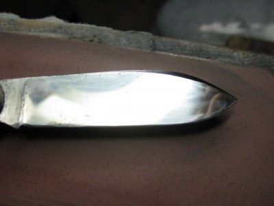

Sorry guys,those old India,Arkansas etc.oilstones are just wastin' away in a bin in my garage.I now use Shapton ceramic Glass Stones and pro waterstones.Real clean cutting,good feedback(feel)and usually lessens the need for stropping with the finer grits,especially when you are sharpening woodcutting tools.
Greg
Picture 027.jpg (94.4 KiB) Viewed 2259 times

dudleythetogi wrote:Sorry guys,those old India,Arkansas etc.oilstones are just wastin' away in a bin in my garage.I now use Shapton ceramic Glass Stones and pro waterstones.Real clean cutting,good feedback(feel)and usually lessens the need for stropping with the finer grits,especially when you are sharpening woodcutting tools.
Greg
How much do the ceramic plates cost more or less?

philco
Posts: 15552
Re: HOW DO YOU SHARPEN A KNIFE ?
Post by philco »
gcrinnon
I've seen your photo and I understand your wife! :P :P
dudleytheogi
What is that camp knife in those pictures? How bout posting a pic or two of it on my Boy Scout knife thread, I'd like a better look.
I too would like to know more about those ceramic plates. I'm curious.

dudleythetogi
Posts: 412
Joined: Tue Jan 08, 2008 1:17 am
Location: N.J.
Post by dudleythetogi »
The 500 is about $35,1000 little over $40,the 3000 I just picked up for a little over $50.
They are mostly used for Japanese sword polish and hold up real well.Some of the earlier synthetic stones i used were the King stones,a little less expencive but dont work as well on the swords.
Philco,that knife is a real beater but looks old,can just make out"MADE IN USA" on the main blade..
will gather them up an take a few shots for you though.
