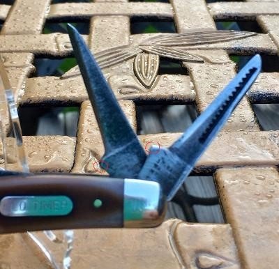

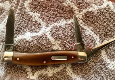

I picked up this well used Schrade and trying to fix the "proud" 2 blades.
I have filed the kick (I can see some metal has been taken off )but it seems like
the "proudness" has not gone down any.
There is no rust/dirt in the well and all blades have moderate snap. I realize if I file
too much the nail nicks will sink and become worthless.
I know this knife is not worth much but just spending some time experimenting.
Do I need to be more aggressive or is further filing a waste of time? I hope I am filing
in the right place (circled on the last 2 pics)!!
Bob

Looks like you are going the right place, but that will take more than a few strokes of a file cut that down enough so those blades aren't proud.
Take 2 or 3 strokes than check to see how far that drops the blade.
Repeat until the tip is no longer proud.

Bob that's not a blade anymore, it's a piece of metal with a nail mark lol. Wow, someone really liked that knife, it's cool to see those well used classics. You'd want to be a little aggressive at first on that one since you have a ways to go. At some point you wind up bottoming out on the spring but I think you still have a little room there.

Looks like taking down the kick enough to get the tip in the well will result in losing access to that nail nick.

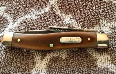

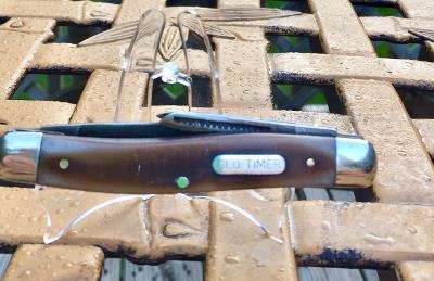

Thanks for the comments.
I filed it down so now it looks a little better. Nail nicks still accessible.
Well used knife that improved in appearance.
