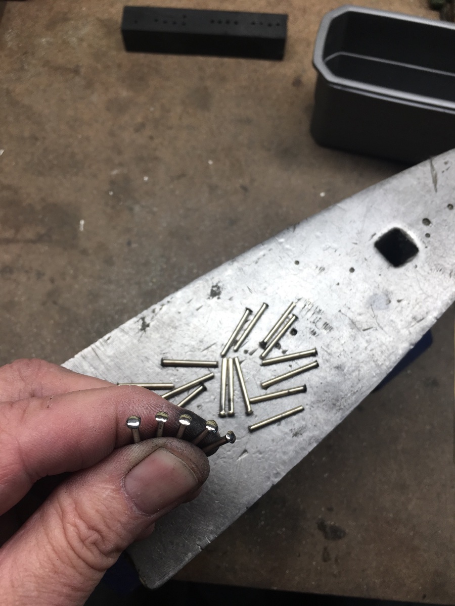

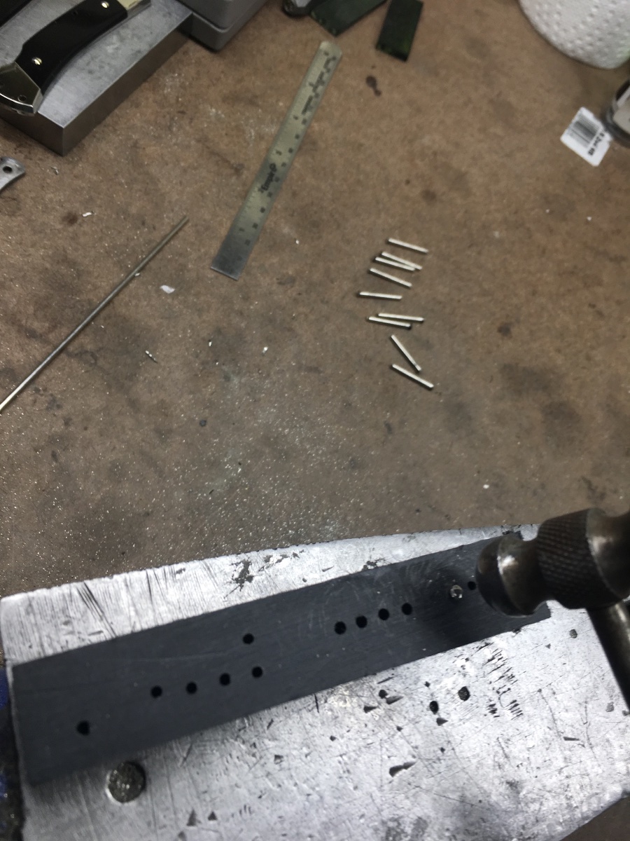

It’s always nice to have one head on a pin for ease of assembly. I buy some of the pre-peened pins and use them from time to time because they can save some time and some grief (one less pin to peen when working in fragile handle materials). Some of the guys here use pin spinners. I’ve owned a few and just didn’t get the results I liked so I do mine by hand. I’m not knocking pin spinners, they just weren’t right for me.
The biggest issue when pre-peening pins is supporting the pin so it doesn’t bend while you’re tapping away on its head. You can use a vise for this but I switched over to a delrin block with some appropriate sized holes drilled in it. It’s inexpensive and works well. You can see that mine has numerous holes in it. This one is 3/4” thick; The process is pretty simple. Install a pin in the hole with a bit protruding and file the top flat; Then use your favorite pin peening hammer and peen the pin until you get the pin head mushroomed over. Light tapping and moving the hammer head around all sides of the pin will keep everything somewhat symmetrical; The pin will look a little beat up at this point, but a few seconds on the polishing wheel and it’ll look just fine; A little time spent in the shop and I’ve got enough pins for my next few projects; Hope this helps.

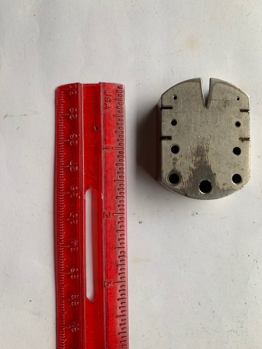

Here is a jeweler's nickel plated steel block for making rivet heads. They are available.

This is something that, as I gather tools to start rebuilding some knives, I have completely overlooked. Something like this makes the job so much easier to put in a pin. It seems that a lot of the English cutlers still use hand-peened pins; while American ones use spun.
Great job! I'm not sure whether (given how bad I am at a lot of the job) I should make or go with the factory-made jeweler's block.

I didn’t know the jewelers block was available or I probably would have just bought one. But since I had some delrin laying around (you could use Micarta scraps or hardwood too), I just made something that fit the job at hand.

Jeff,Jeffinn wrote: ↑Wed Jul 08, 2020 4:47 pm It’s always nice to have one head on a pin for ease of assembly. I buy some of the pre-peened pins and use them from time to time because they can save some time and some grief (one less pin to peen when working in fragile handle materials). Some of the guys here use pin spinners. I’ve owned a few and just didn’t get the results I liked so I do mine by hand. I’m not knocking pin spinners, they just weren’t right for me.
Hope this helps.
