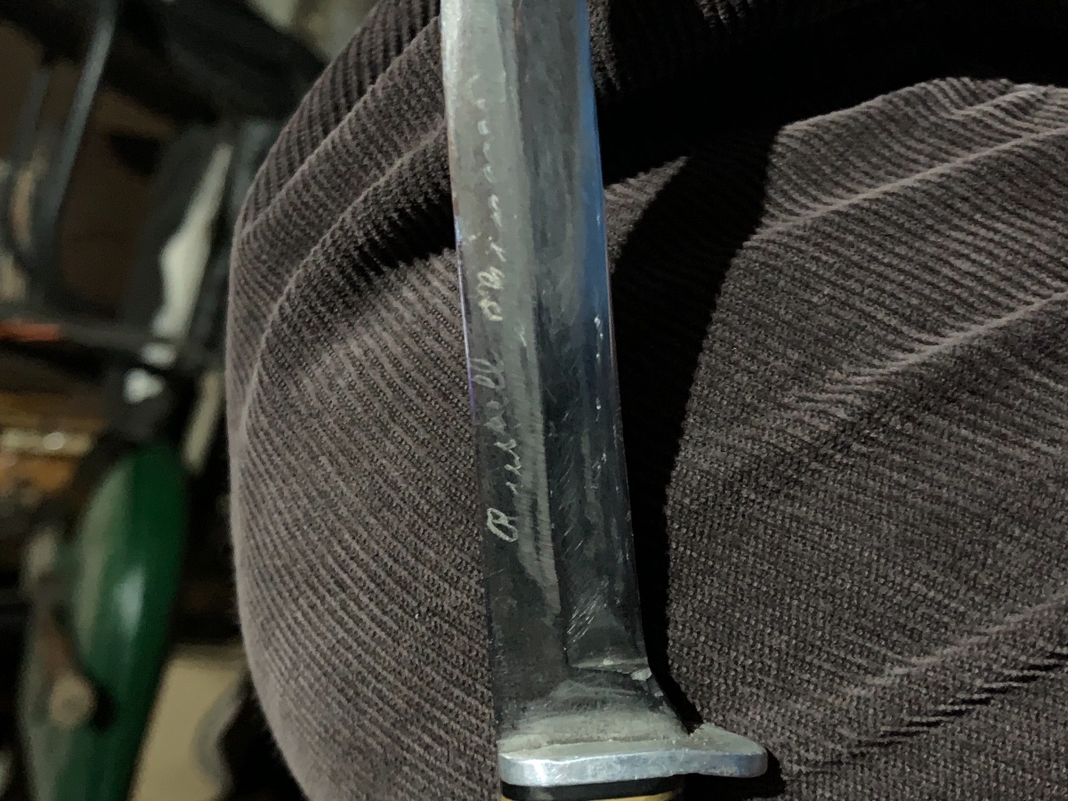

Picked up this new to me western today overall right at 8 inches..thinking maybe a Bird and Trout model not sure though.

The guard is non magnetic, upon looking at the knife in lower light it seems someone engraved their name on the blade..can kind of make out Russell? Possibly not sure..was this a common thing for people to do?

Non-magnetic means that it is probably nickel/silver, occasionally used as guard material pre-WW2.
Names etched on blades is not as frequent as names carved in sheaths, but it happened. Heck, it still happens. There are 2 primary reasons blades from the 1930s to 1950s have names engraved on the blades - Boy Scouts and military.
Some engravings were due to more that one Boy Scout in a troop having the same knife, whether because they all had "official" BSA advertised knives, or because one kid got one and the copycat brigade struck because several of the troop members liked it, or maybe that was all that was available at the local hardware store.
Engraving the owner's name on the blade endured that the right knife got back to the right boy.
Ditto with the military - I have several knives from WW2/Korea/VN that have the owner's name engraved on the blade in efforts to TRY to prevent a knife from growing legs.
