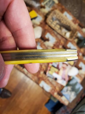

I just took a look and I have several stockmans with double liners, both on the side where the sheeps foot and spay come together. Shown is a Camillus 179.
Camillus 179 stockman
Outer most liner is cut down
Actually it's the inner most liner cut down :oops:

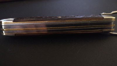

Moore Maker stockman

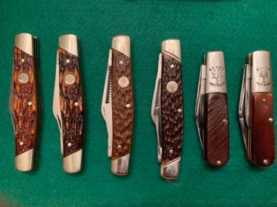

So it tuns out that one of my other 9885’s has this same double liner. I’m not sure why I had not noticed. On the outside it is not quite as apparent to these tired eyes. I have attached a picture of my Bokers - four 9885 stockmans and two 493 Barlows. The two knives in the center have the double liners. The two far left knives are identical. The one furthest left has been my daily carry for several years. The one beside it has never been carried or sharpened. Notice how much more attractive the carry knife has become. I think I have them lined up by age but I would appreciate any help you all can give narrowing down the dates. There are differences in shields, bolsters, nail pulls and swedges. The three pin Barlow is bone. Again feel free to make any observations or give any opinion. Thanks to everyone that set me straight on the double liner. I’m already smarter than when I started.

Roger59 wrote: Tue Jun 09, 2020 2:53 am So it tuns out that one of my other 9885’s has this same double liner. I’m not sure why I had not noticed. On the outside it is not quite as apparent to these tired eyes. I have attached a picture of my Bokers - four 9885 stockmans and two 493 Barlows. The two knives in the center have the double liners. The two far left knives are identical. The one furthest left has been my daily carry for several years. The one beside it has never been carried or sharpened. Notice how much more attractive the carry knife has become. I think I have them lined up by age but I would appreciate any help you all can give narrowing down the dates. There are differences in shields, bolsters, nail pulls and swedges. The three pin Barlow is bone. Again feel free to make any observations or give any opinion. Thanks to everyone that set me straight on the double liner. I’m already smarter than when I started.
A very impressive collection, Roger.

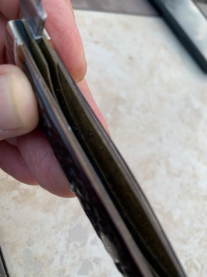

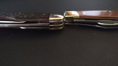

None of my Bokers have it, but my stockman is a new one.
I did find this on my Ka-Bar stockman and on my Ulster boy scout knife.
Comparing it to others, it just seems like a way of fitting multiple blades in with just 2 springs, which seems a better solution than going with thinner and/or bent blades to make them fit.
Ideally, I like my Buck 301 that just goes ahead with 3 springs. Thick steel, lots of room, no need to get creative and makes for a nice heft in hand. ::tu::
Here are the Ka-Bar and Ulster if interested:
