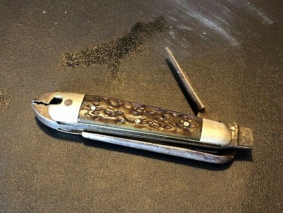

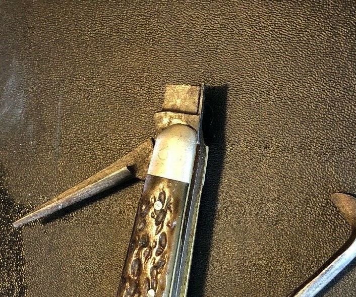

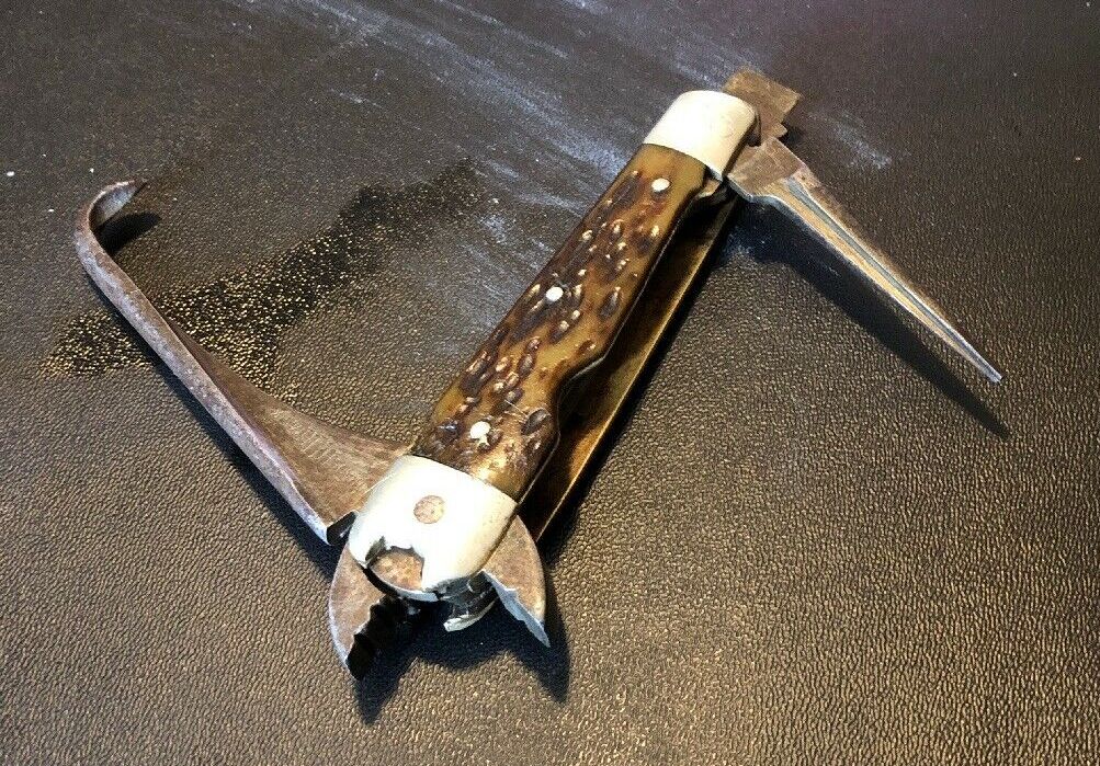

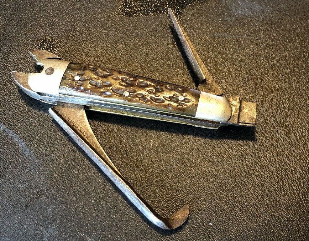

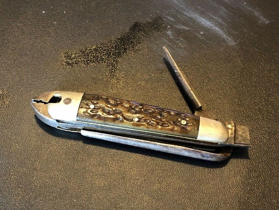

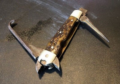

I got this pliers knife off the bay a little while ago. One reason I got it is because I have had one on my "want list" for a while now. This one was VERY affordable because the knife blade is broken off. There is also a couple of chips knocked out of the scales but all-in-all, in pretty good shape. SO.... here is my dilemma.....
I was thinking I would just keep it "as is" with the broken blade...... but, now that it is on its way to me, I think I might fix the blade.
NOW... I don't want to try to EVER pass this off as a complete original knife so any restoration I do will be strictly for my happiness.
That being said.... you knife mechanics.... what would you do?
1). try to graft a piece of a blade onto the stub that is left so the "O Barnett" tang stamp would still be shown....
OR
2). make a new blade and put it in. It would not have the "O Barnett" stamp so then no chance of passing it off as original.
Without further ado.... here she is...... (seller's pics)
I intend to put this repair / resto in line next after the Camillus.
What y'all think?
::shrug::

That's an interesting project you have there Mike. ::nod::
To weld a blade on that broken tang, and to do it correctly would require a laser welder like jewelers use. I have priced them, and even the used ones were several thousand dollars beyond my budget when I price them several years ago.
I know collectors that use that technology. One friend who does use it says it's very difficult to find someone who can do it properly and it's also quite expensive and usually takes a good bit of time on turnaround.
That might be worthwhile if you had a knife that was worth a couple of thousand dollars, but obviously that's not the case. If I were doing it, I would try to find a blade that fit that frame, or could be modified to fit (the most likely scenario).
It is my preference to replace handles when I can rather than patch them, so that's probably how I would proceed on this one as well.
99% of the time I mark the liner of each knife I work on with my initials and year of the repair or I put my etch on the blade or the bolster of the knife. Almost always I mark the liners and the blade. ::nod::
That's the way I do it. That's not the only way, just my way.

Personally, I would put a whole new blade in, rather than welding one on. There is much less chance of a susequent owner passing it off as original (by accident or design). As Dale said, it should be discreetly marked as Repaired, for the same reason.
I had wondered about grinding down an old broken tang and making it into a shield for a repaired knife with a new blade. It may be too much trouble, but I may try it on a cheaper knife. I will post results if I can make one that looks decent.

Yep, I think y'all are right. A "new" blade is the way to go.
Dale.....
I highly respect your advice and I am glad you pointed out how blades are welded back on. I guess I just thought a wire welder would work for putting a new piece on a blade stump. I can see that a welder of that type would probably heat parts up too hot and cause a problem with the temper of the blade.
I need to start thinking about marking knives I work on I guess. I'm not good enough to be "dangerous" yet. I knew a guy that built flintlock rifles that was "dangerous". He could restore old RARE and EXPENSIVE pistols to a point where it took a LOT of examination to see it had been restored. His artistry was second to NONE!
New blade it is.....

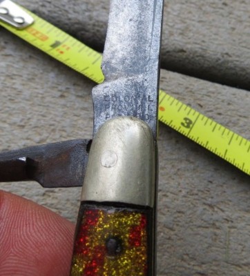

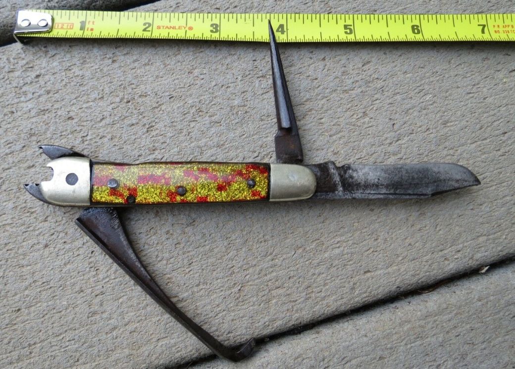

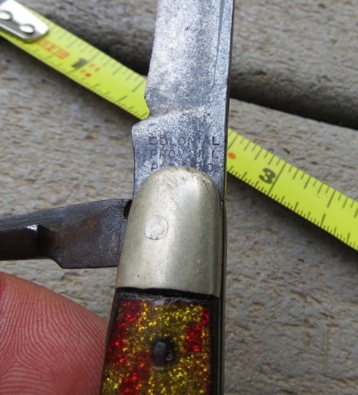

SO..... any other stamp on the tang other than Barnett is just a fabrication of parts by somebody......
Like this one.....
You can make it yours for only $456.50....

Yep, that clip blade is a dead giveaway that the blade has been replaced, even if there was no tang stamp on it. Goins says O. Barnett Tool Co. went out of business in 1915, more history about that company would be interesting. I wonder what else they made?

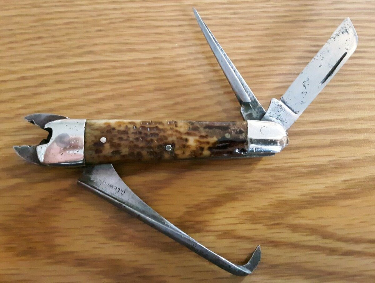

BTW- there was never a sheepfoot blade in one of these originally, the seller does not mention this;
https://www.ebay.com/itm/Vintage-Antiqu ... 1438.l2649
A very poor tang stamp too.

Also forgot to mention on the sheepfoot knife, it looks to me like a scale patch job. And not a good one at that. ::facepalm:: The seller doesn't mention this either.
