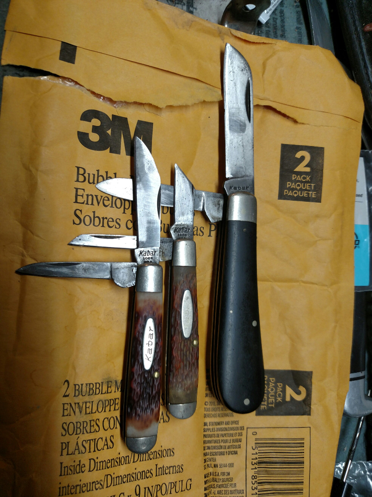

I use the end of my smiths diamond stone and push (stab) the blade length wise. Then I lay it flat and go the long way on the stone. This gives it a cross hatch effect and seems to help the process. It thins it removes high spots and really smooths it out. I don’t get there all at once. But each time it gets sharpened I do it a little more. If nothing else it thins the blade as you sharpen down into the thicker part of the edge.
I do the same on my kitchen knives especially the pairing knives.
A big word of caution beware of the sharp corners on the spine of the blade. It can become very sharp. Always round off the corners of the spine.
It’s very difficult to capture in a picture. But these were all sharpened like that.
