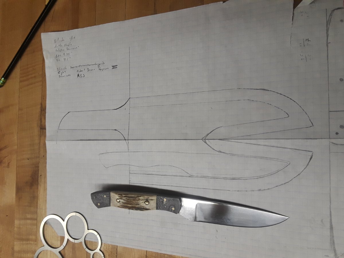

Ok then I will keep adding to this thread over the next few days and do my best to explain. I want to point put again a lot of this process I learned from the video tutorials of paul long who is a master sheath maker in my opinion.

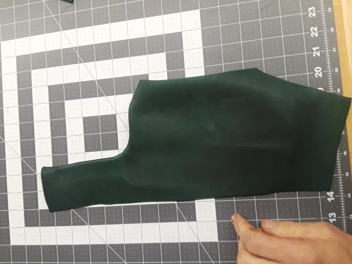

Ok so after the pattern I layed it out on my leather. Using and awl I push points into the leather around the pattern then I cut it out.
I'm using wicket and Craig 7 to 8 ounce leather skirting pre dyed a color.
After that i cut out a block of the deer hide for the lining. Note its layed good side to good side when I do this. Hence the non colored leather.
Note if you arent using a liner you just use the cut out leather part and skip the deer hide.

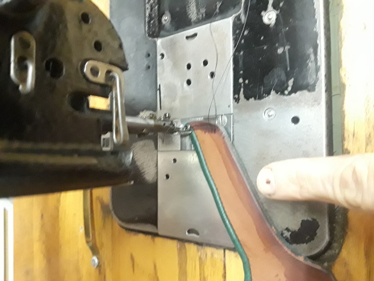

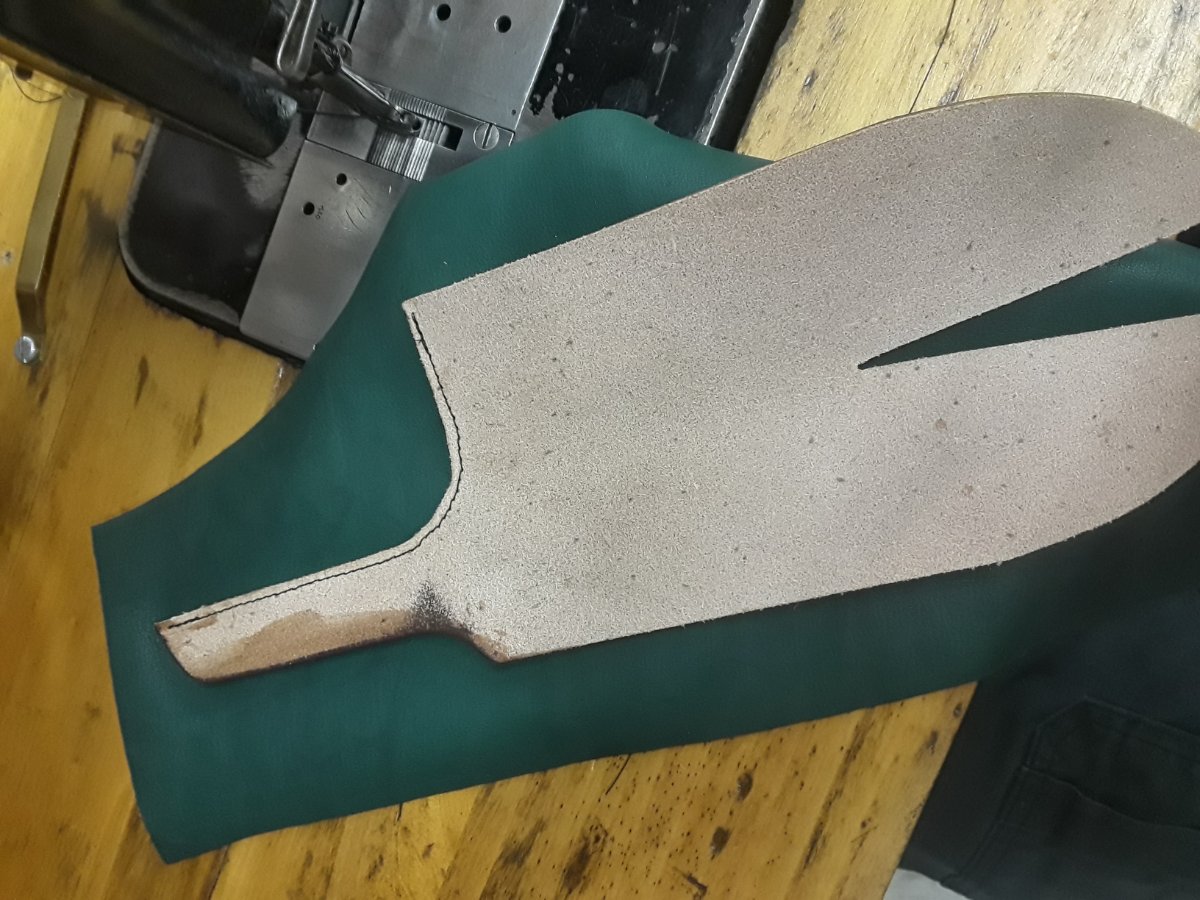

Next up I take and sew the liner to the saddle skirt leather. (Im using a machine because I have one and it.makes it faster. That being said this could be hand stitched as well) Once that is done i.cut away the excess to the edge. Put contact cement on each side and once it's ready I roll the edge over and it is cemented in place. Then I trim away the excess around the edges

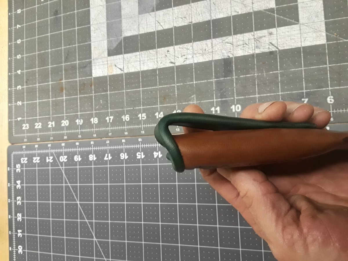

Ok so back to the sewing.machine I stitch down the other side of the belt loop. Then I fold it over and head to a different machine to stitch the belt loop over. Finally I add on my makers mark. Again I use the machines cause I have them but you can and Inhave hand sewn before

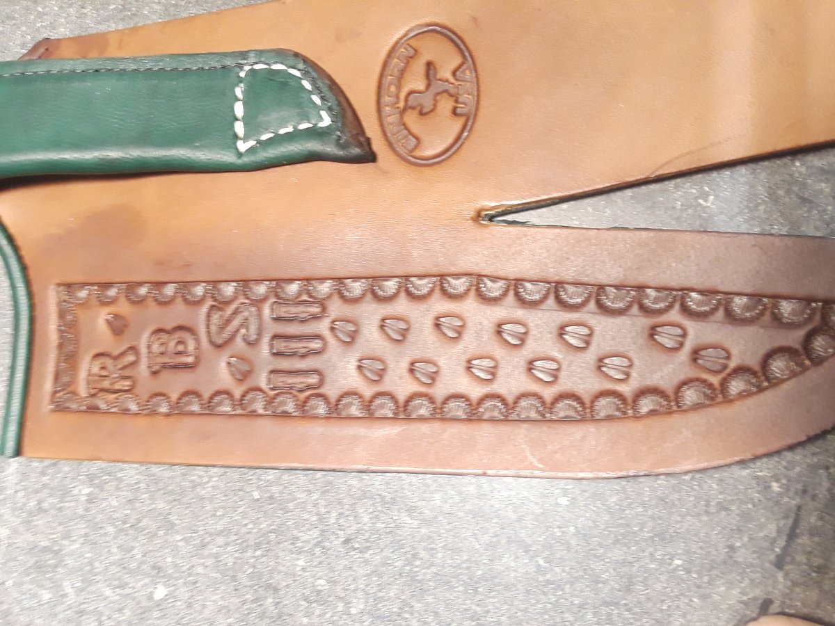

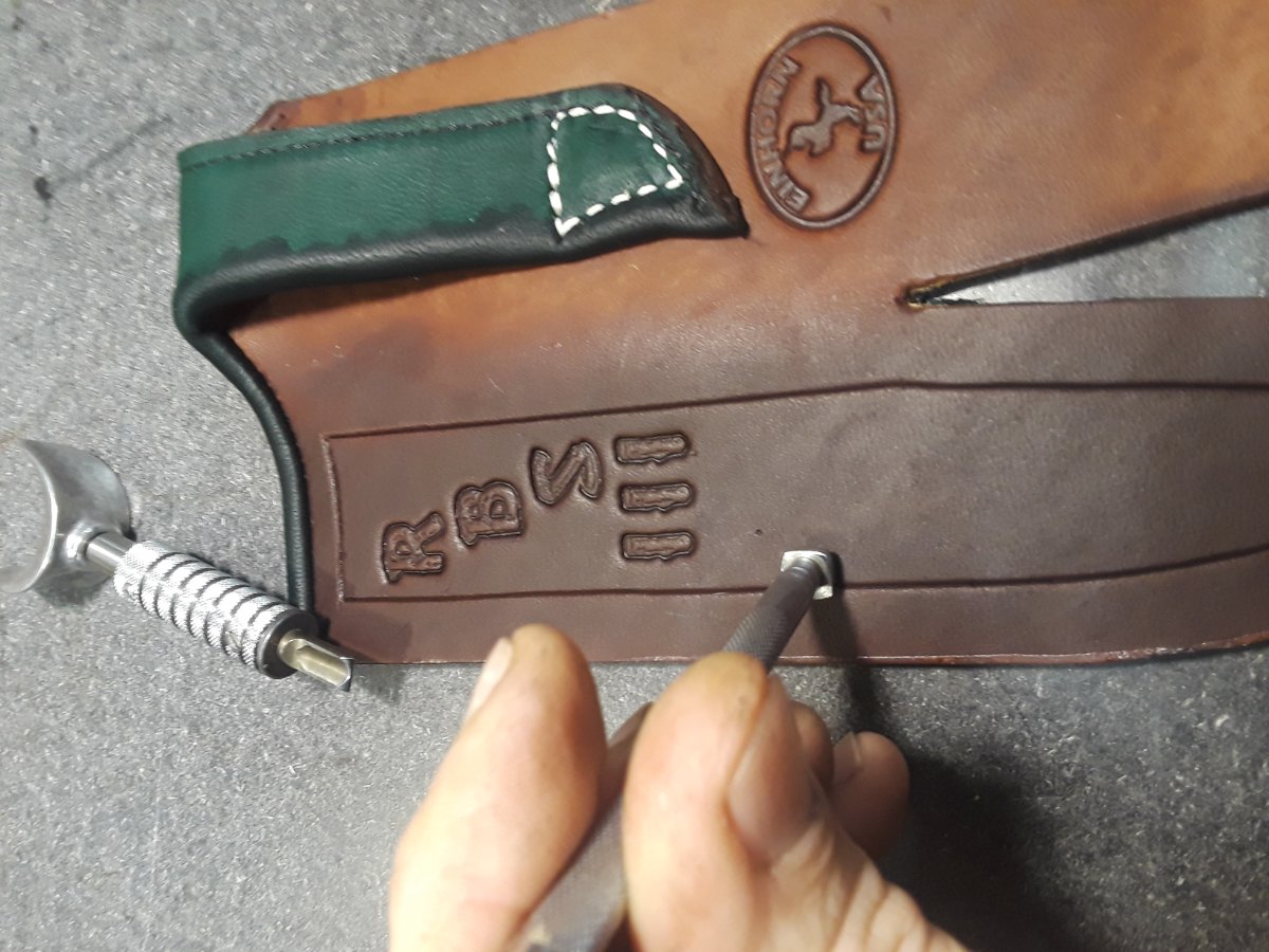

Time to add some stamping. I use a divider and make a line about 1/2 inch in from the edge. This gives me room to stitch later. I also then make one on top and on the far side. This shows me where I can stamp or carve some designs. In thos case I cut the border l8 e with a swivel knife and then beveled. Client wanted initials stamped and some basic stamping. Note the practice piece. I do that often to see how things look before moving forward. Next will be adding the welt and stitching the sheath together

I like the hoof prints up the front. I have a sheep's foot print that I made years ago to mark leather work. I have made many sheaths with the prints walking up the sheath.
The leather lining looks great and gives a great finish.
How is the deer lining finished? Have you ever found that to tarnish metal in any way?

There is much debate in the leather world about chrome tan leather and it hurting metal. I worry about this, however I've seen little evidence of issues. Discussions from others that have far more experience then I seem to feel the same. That being said most knifes i recommend storing long term outside of the sheath since all leather can hold moisture and cause rust. Meaning If u arent going to use them for 6 months I'd keep em separate... not that I follow my own advice well. They do veg tan deer also I've read but I have no idea what type the one I have is as it wasn't stated. So I assume its chrome tanned. Supposedly veg tan is not an issue to metal. Hope that makes senseTony_Wood wrote: ↑Sat Feb 29, 2020 2:01 pm Nice work, sir.
Those machines are super nice!
Nice looking knives u make as well. Oh and that stamp is a hackbarth leather stamp hackbarth made stamps in Arizona for a long time I got it with a bunch of craftool I bought it's a fun one

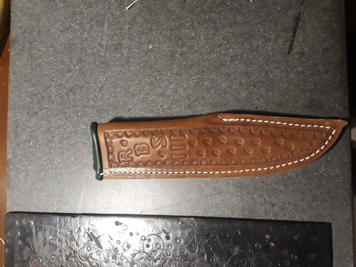

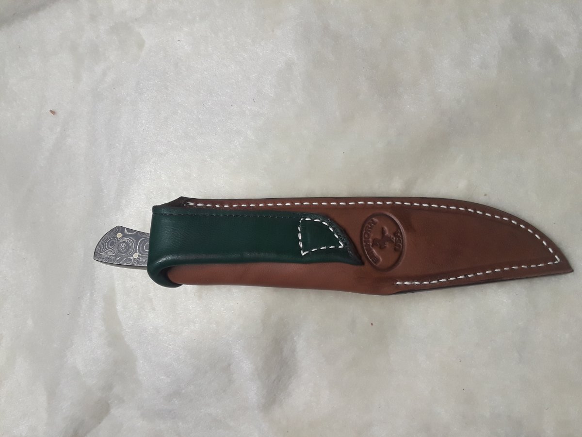

Almost done now. Next a welt is added I will again use my pattern to lay it out. Cut the welt then glue in place. But I do skive the deer skin away so the edge isnt as bulky and the deer skin doesnt show. Yes it's a rough skive job sometimes I get it nice sometimes its chewed up looking. It's part I'm still improving. The welt panther to help protect the stitching. Once I glue it the sheath is folded over and ready for stitching. I will teue up the edges on a sander at this point to make them uniform and smooth. Indo also run some dye down it to match color.
Einhornllc Custom knives and leather.
Come stroll around my AAPK store sit a spell maybe buy a knife or two
https://www.allaboutpocketknives.com/rossr
Rossr
- Posts: 575
- Joined: Sat Feb 22, 2020 12:08 pm
Re: Would anyone want to see the progression of a sheath?
Ok so I now stitch it on the needle awl machine I have. Again you can hand stitch and it will work fine. I really want to impress u can do nice sheath work with some basic hand tools it just takes longer. Sewing machines are expensive but nice if u have them on hand. Once its stitched I burnish the edges so they smooth out and get a nice finish. I will add pecard leather dressing to help protect it. I also press the knife in and make sure I have a snug fit. Theres a bit of learning on the spacing when you draw it out to make sure I get a nice fit. Comes down to how thick the handles are etc and making sure you arent too big on the layout or too small.
So that's the overall theres a lot of small steps I probably forgot to add but that's the basic idea. Hope folks enjoyed the photos ...get some leather and give it a go fun stuff

The sheath looks nice, Ross.
The leather lining is a great finish feature. I always encourage folks to store knives outside of leather, especially for long term storage.
Keep up the good work!
