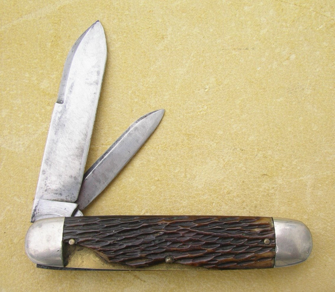

Here is quite a nice older knife, Schrade Cut Co., 4 1/4", 2 blade Equal End Jack with full blades, excellent snaps and most attractive peach seed bone handles. The back handle is missing a piece of bone.
It is a very collectible pattern and except for back handle, is in very good condition.
What is the best thing to do with this knife ?
If someone has SCC jigged bone handle slab of this size and successfully installs it, does it change the knife's value ? i.e. now it will have been worked on ?
Or, are some collectors accepting of knives with correct handle replacement on back side ?
Of course if a correct handle was installed blades could be sharpened for a special EDC knife, a treat for a collector to carry & use.
I would like to hear your thoughts on this knife and suggestions as to who might have the correct handle piece (peach seed bone ~ 3 1/8" x 7/8").

A correct replacement would be a long shot. If it was mine I would send it to Olde Cutler in Sioux Falls for a patch, and I would put it into my pocket.
- btrwtr
- Posts: 5484
Re: Schrade Cut Co Jack; Handle Repair Advice
As said finding the correct handle material and getting it repaired would be a long shot. In my opinion a good repair would ad value to the knife but depending on the cost it might be prohibitive. It would be a repaired knife and should be represented as such. Repair work is always a matter of what the specific collector finds acceptable. If it were my knife I would epoxy patch it and try to get it as presentable as possible.
Wayne
Wayne
- herbva
- Posts: 2074
- Joined: Thu Oct 11, 2018 7:18 pm
- Location: The Old Dominion
Either way -replaced scale or a patch job, it will forever be a repaired knife. Even if you do somehow manage to find the exact matching scale from a "donor" knife, and do a an absolutely perfect transplant job with none of the little clues indicating that some work been done, it should be presented as a repaired knife. Judging from your picture, if that was my knife, I would patch it in a heartbeat. I have many patched knives in my collection and I actually like working with epoxy. The thing I like most about working with epoxy is - if you don't like the way the patch comes out, it takes only a few seconds to heat it up, remove it and try again.
Herb
Herb
- Doc B
- Posts: 3700
- Location: San Antonio
The bone on that is beautiful and original. I'd rather have it patched and preserved, IMHO.

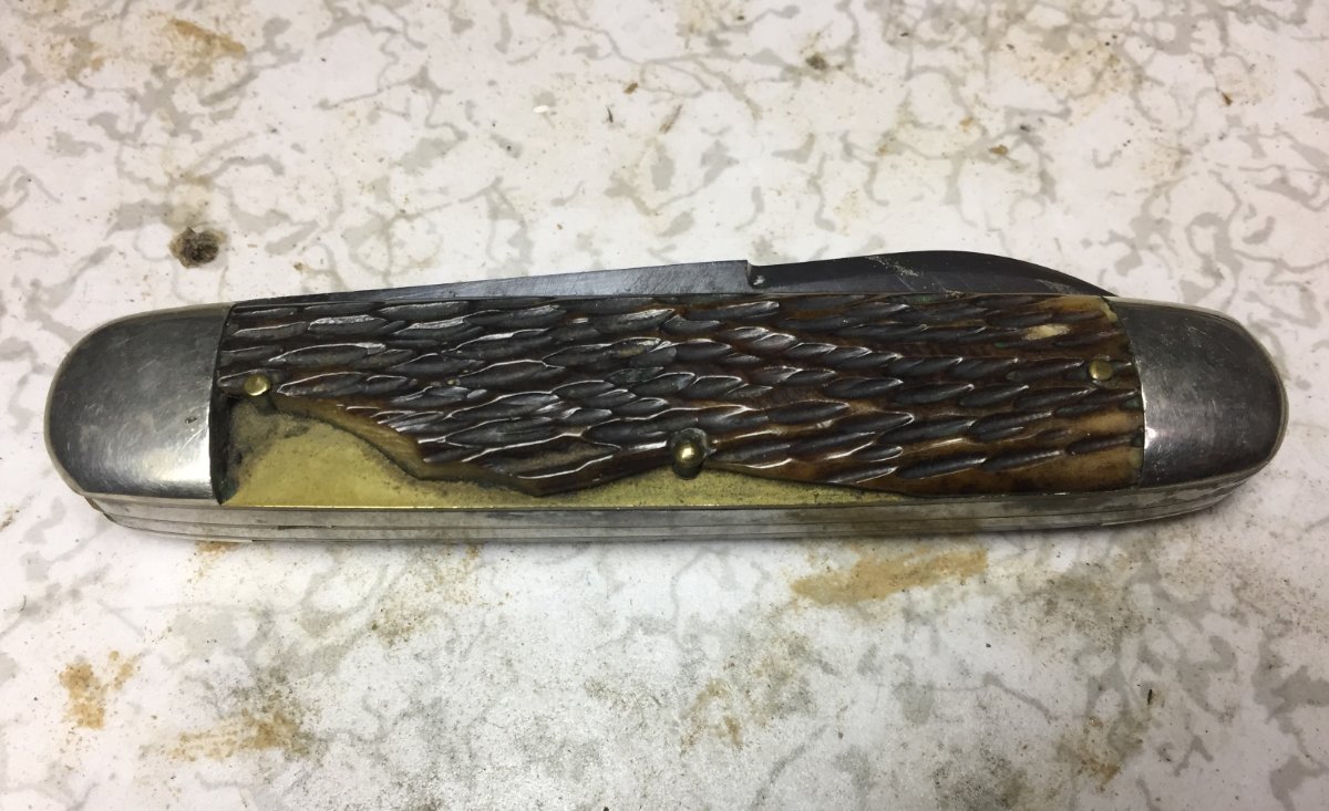

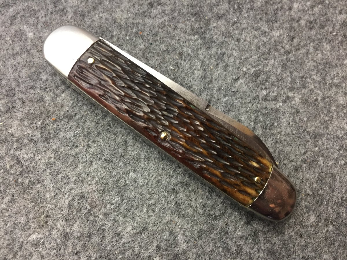

I had PM'd KJ and offered to repair this knife but with shipping costs to and from Canada it proved a bit too pricey. KJ was kind enough to sell and send me the knife and I had promised to post the repaired knife when the handle patching was completed. I do like these big 4 1/4" closed length cigar jacks.
For me patching can be a process that involves many steps to get to what I consider a decent repair. It is never a quick one and done process. Sometimes I have to remove the patch entirely and start over from scratch if things don't go well. In hindsight I could have done a better job of matching the jigging on this old Schrade but I was reluctant to start over since the color match turned out as well as it did. I have included a before and after picture.

GOOD GOLLY..... that looks GREAT!!
You did a beautiful job!
AGAIN.... WOW!!!!
AGAIN.... WOW!!!!

Impressive, Wayne!

Remarkable buddy. That looks fantastic.

What do you use for color matching?btrwtr wrote: ↑Wed Feb 05, 2020 1:11 pm I had PM'd KJ and offered to repair this knife but with shipping costs to and from Canada it proved a bit too pricey. KJ was kind enough to sell and send me the knife and I had promised to post the repaired knife when the handle patching was completed. I do like these big 4 1/4" closed length cigar jacks.

Wow ! Amazingly exact color and jigging as well. I had no idea that a handle restoration could look so perfect. The knife thanks you Wayne. It feels whole again.

If not for the before pic, I wouldn't have thought repair on the second pic. Excellent.

If I didn't know it was a patch, I may have been hard-pressed to see the repair!
Awesome!

Yes, it is an excellent repair job. When people look at a knife and you tell them you have patched the broken bone and they say "where is the patch" then you have done good.

It depends on the handle I'm trying to match. I normally start by adding some fine wood particles from filing and ad that to the epoxy as I mix it. I also used some brown leather dye on this particular knife. It actually looks better in hand. The small picture (before enlarging) as I look at it on my PC screen is the same size as the knife.edge213 wrote: ↑Wed Feb 05, 2020 3:18 pmWhat do you use for color matching?btrwtr wrote: ↑Wed Feb 05, 2020 1:11 pm I had PM'd KJ and offered to repair this knife but with shipping costs to and from Canada it proved a bit too pricey. KJ was kind enough to sell and send me the knife and I had promised to post the repaired knife when the handle patching was completed. I do like these big 4 1/4" closed length cigar jacks.

He repaired this one too, which had a chunk of bone out of it.

Wayne is the master!!!

That is great work! Even the jigging looks original to the knife. If I may ask, what kind of epoxy do you use? I've found that the hardware store variety doesn't polish up very well.
