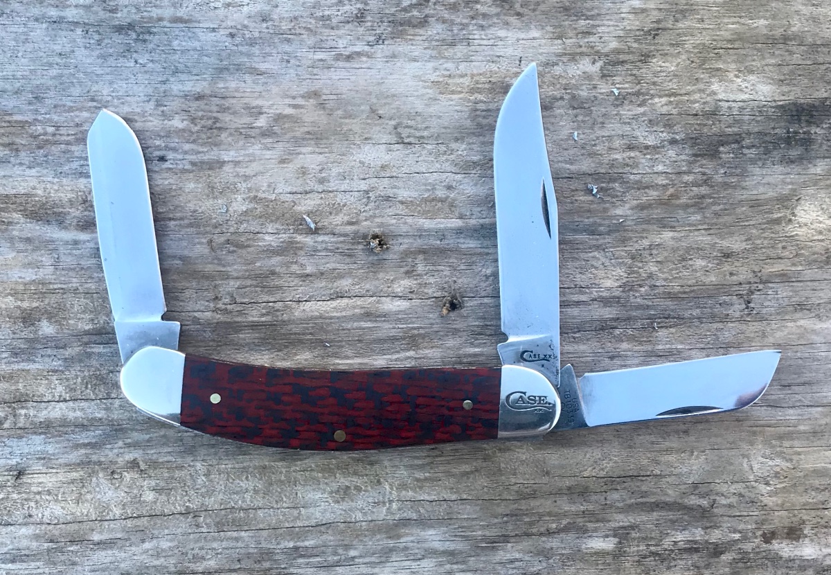

This I my new CASE TB sowbelly in CV. I cut an apple with it a week a go and it darkened the blade some, then a few days later I notice a tiny shallow pit. So a couple of days ago I decided to speed things up and force a patina to help protect the blade.
I used plain ol yellow mustard. I coated the blades real thick, waited 2 hours, and rinsed with warm water. It wasn’t dark enough and some areas weren’t dark at all. Do I did a second coat and left it for two hours as well, then rinsed.
I dried it with rubbing alcohol and let it sit and darken some more over night. The next morning I wiped it down with Ballistol. It’s darkened some more still with blues and browns, even some turquoise in the right light.
