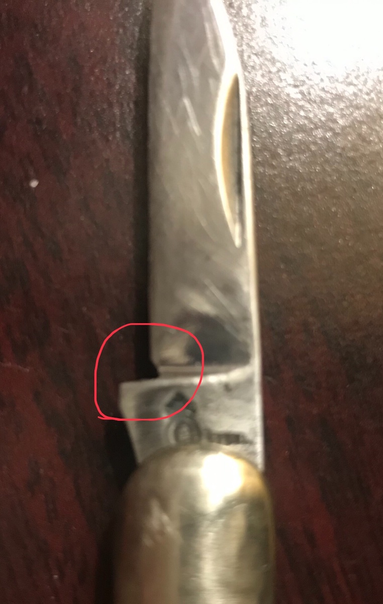

Secondly a previous owner- a man who should be made to wear a blue striped apron, sharpened the blade in such a way as to remove a belly of metal some 5/16" ahead of the choil nick, the deepest part of the missing metal is about 3/32" deep.
I am inclined to resharpen and move the profile back that 3/32" to the choil end to straighten up the cutting edge.
Is this a giant NO NO or could this re shaping on the blade it be regarded as normal practice?
