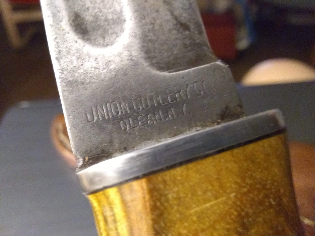

UNION CUT. CO. OLEAN N. Y.
Can members tell me the span of years the UNION CUT. CO. OLEAN N. Y. tang stamp was used?

Re: UNION CUT. CO. OLEAN N. Y.
Goin's Encyclopedia of Cutlery Markings gives the dates, 1911-1951.
Goins' is a little off depending on one's interpretation of the question. Union Cut Co moved to Olean, NY in 1911. In 1952 they changed their name to KA-BAR Inc. BUT, they began the KA-BAR trademark and stamp in 1923. Now most KA-BAR marked knives from 1923-1943 will also have a Union Cut Co mark on the back of hunting knives and large folding knives or secondary blades of pocket knives. The Union Cut Co mark was dropped around 1943 with the advent of the military knives produced for WW2 and the mark on all knives changed to KA-BAR over Olean, NY, and the Union Cut mark disappeared. At this time there will also be no marks on secondary blades of pocket knives and nothing on the backs of hunting knives. Sometime after the war while still Union Cut Co the stamps changed again to KA-BAR over USA. When the company changed it's name to KA-BAR Inc. the marks changed again to Kabar (lower case italicized), and again, no Union Cut Co marks.
Now here is where it gets tough. When the KCC (KA-BAR Collectors Club) began issuing "club knives" in 1976 they began using Union Cut Co marks again on secondary blades and the backs of some main blades. These knives were made by Queen and careful inspection will reveal they are not as well made as the original Union Cut made knives. So, a general statement would be that the Union Cut Co Olean, NY as the ONLY mark on an old knife would date it to 1911-1923. Except for any KCC knives with that mark.

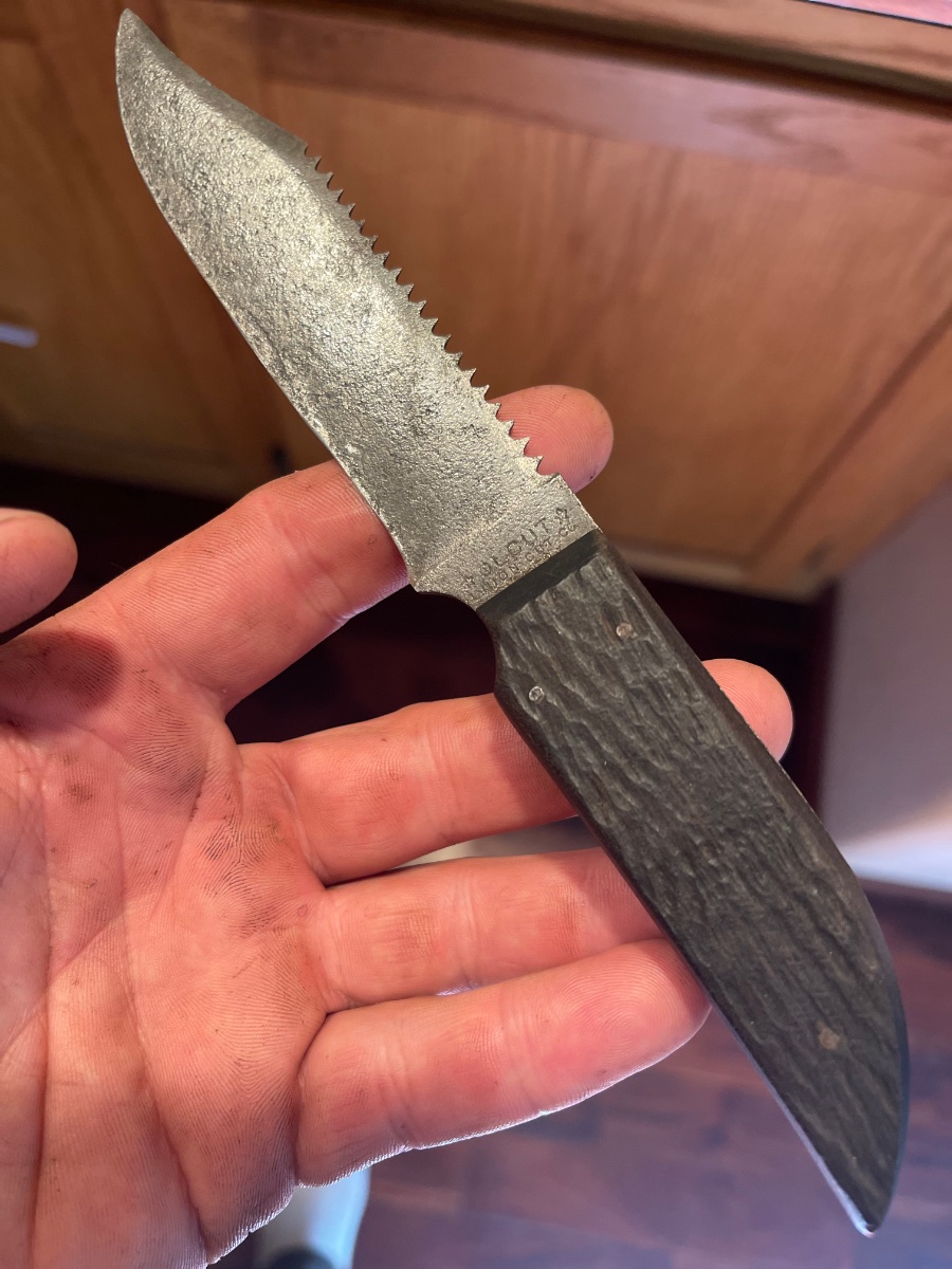

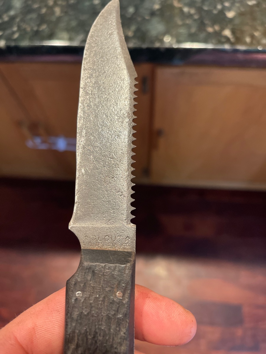

Not to pull up a “Zombie” thread, but reading this thread, I am a little confused. Here is a knife I just purchased. Looking at the marks as you describe them, is this a pre-43 or a knife from the 70s?
Yours is an original older knife, 1923 to 1943.Whitneyrifle wrote: ↑Fri Dec 24, 2021 12:22 pm Not to pull up a “Zombie” thread, but reading this thread, I am a little confused. Here is a knife I just purchased. Looking at the marks as you describe them, is this a pre-43 or a knife from the 70s?![]()
Hard to tell from the markings alone, one has to "read the knife", especially the handle material. The early green bone has never been duplicated in modern times.
