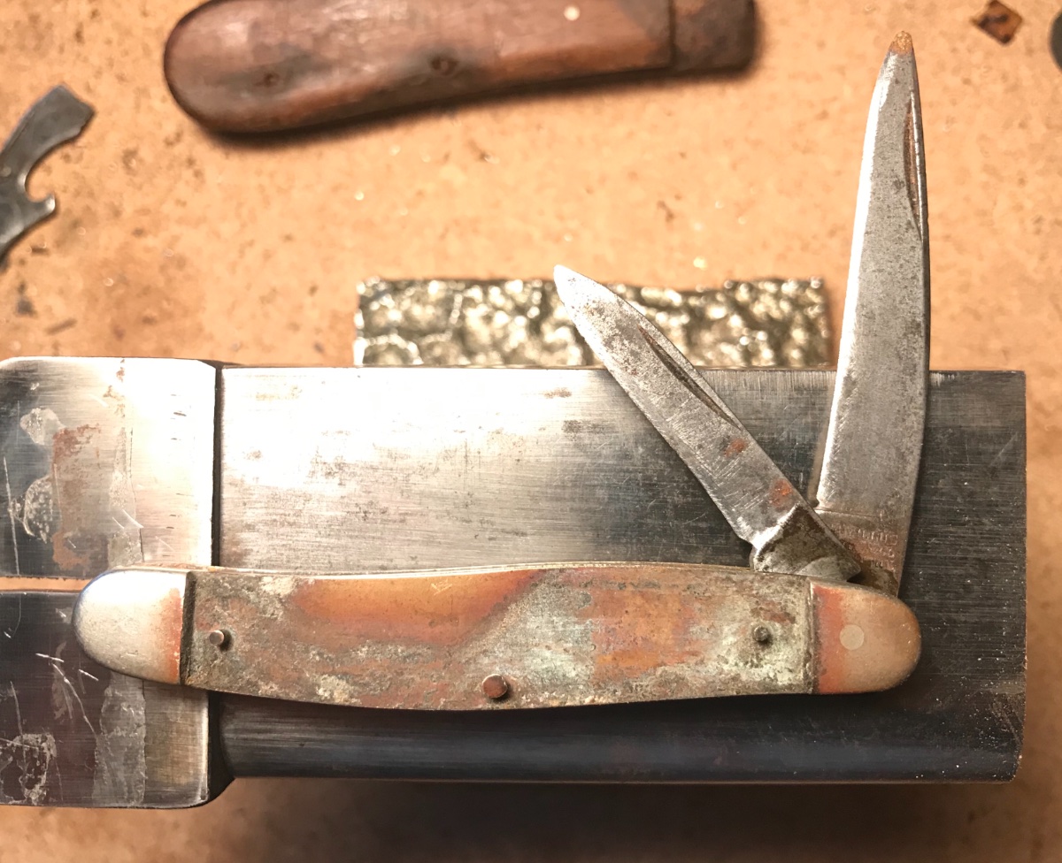

This Camillus 4-line peanut had obviously suffered from outgassing. The main was worn, but not too badly. The pen blade looked good but had no snap.
Before
Before

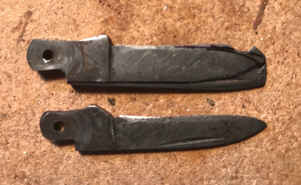

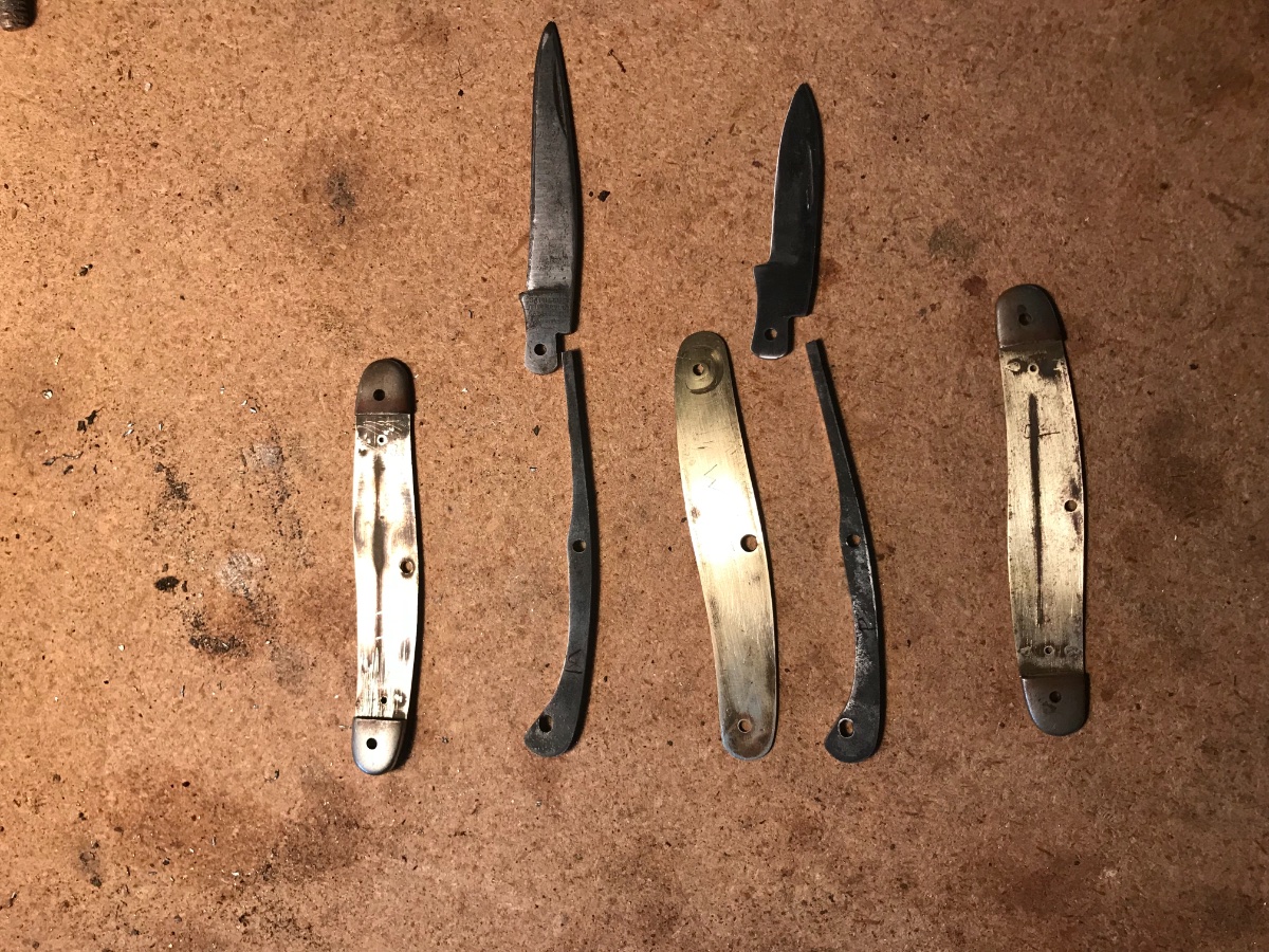

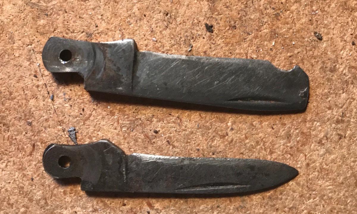

Upon disassembly I found that the tang was worn Out on the pen blade. I didn't have another, so I took a broken Camillus spey blade and re-profiled it into a pen blade. The new nail nick is not perfect, but good enough!
Apart
Apart
Pen blade 1
Pen blade 1
Pen blade 2
Pen blade 2

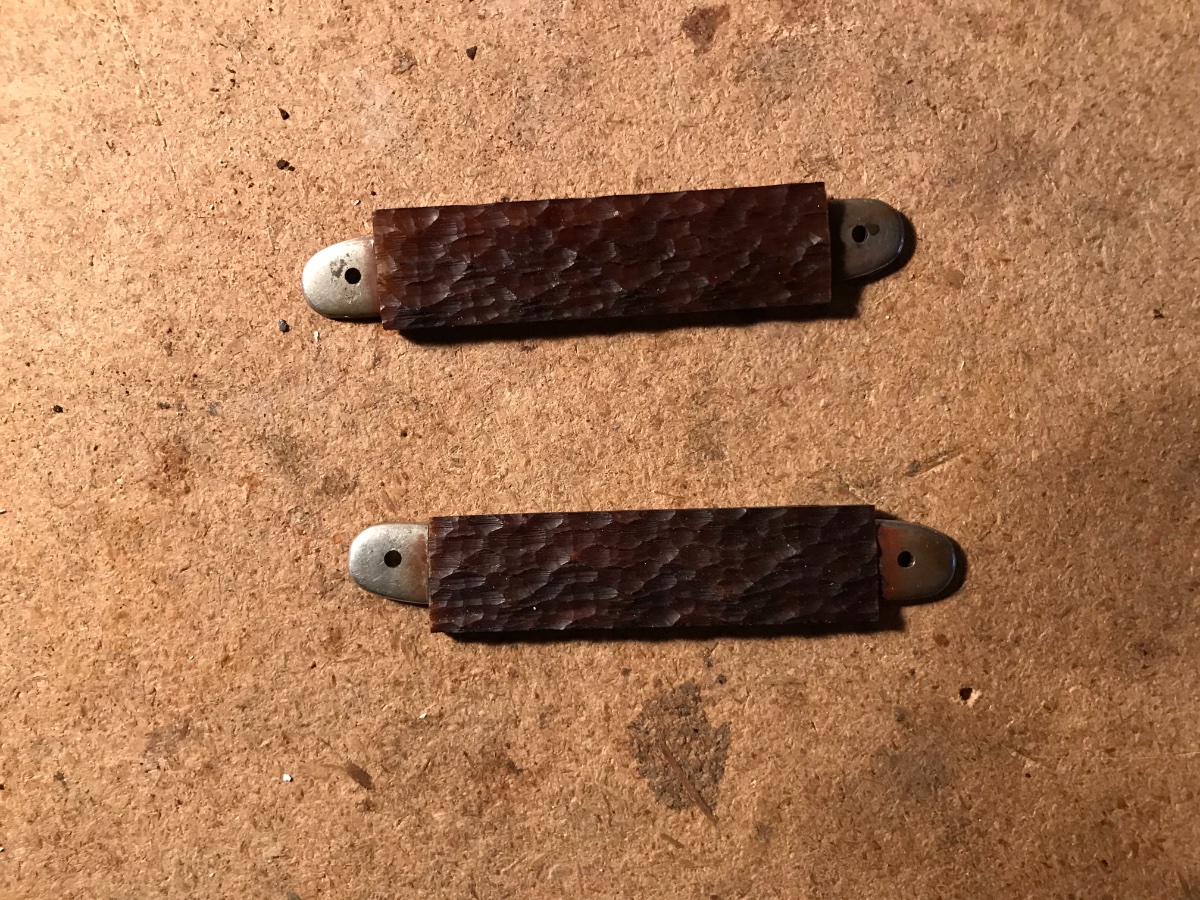

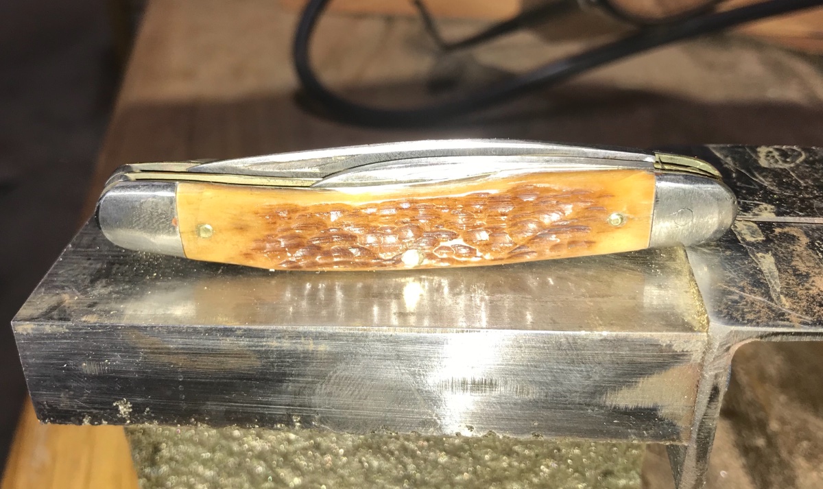

Decided on some Catalina Nutmeg bone from Culpeppers. This is was my first time re-handling a knife in bone. (Why didn't you guys warn me that it would crack this easily?)
Culpepper Catalina Nutmeg

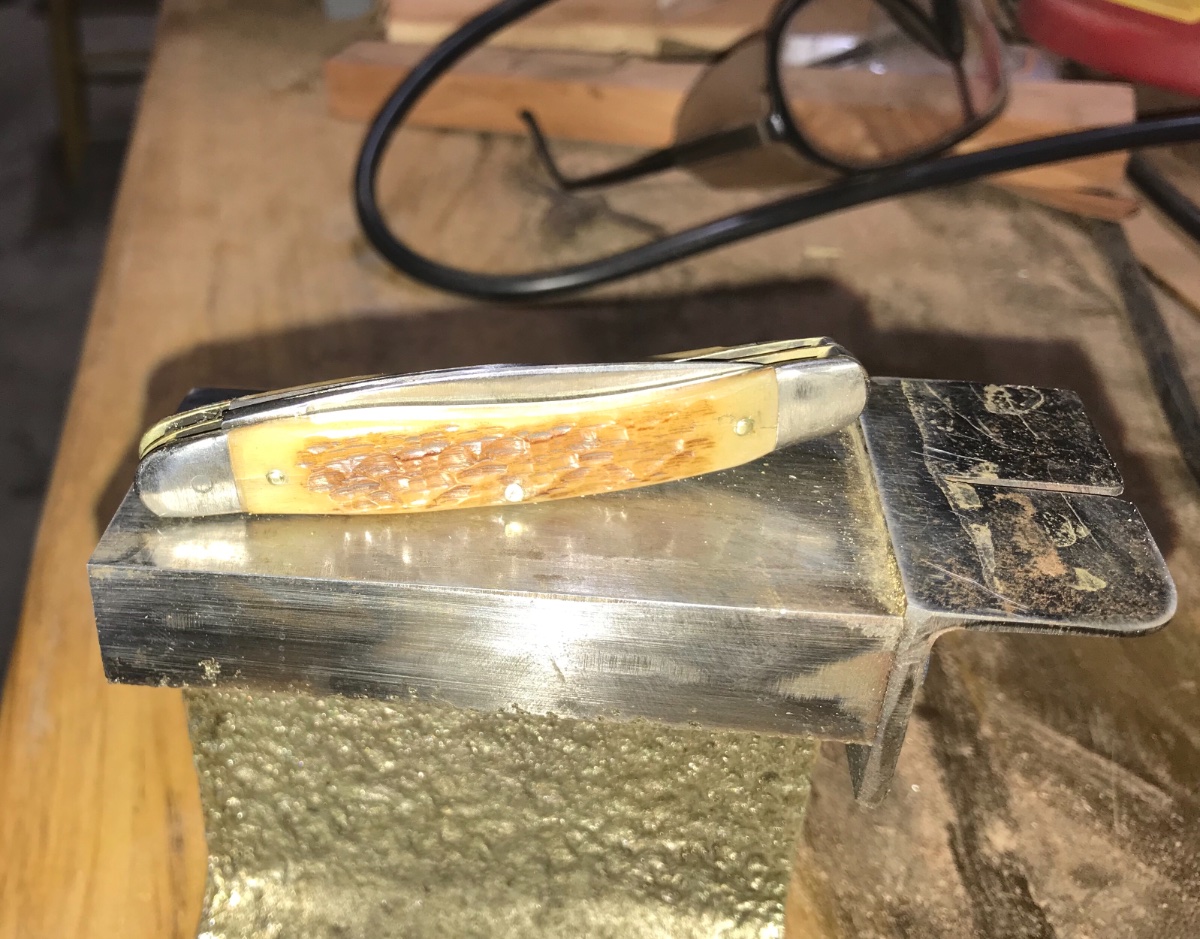

So after cracking the bone IN THREE PLACES, I finally got it all back together. I need to sand it by hand some (I'd had it hafted nicely, but got the bone into the sander again later when trying to smooth the bolsters).
Pile side
Pile side
Mark side
Mark side

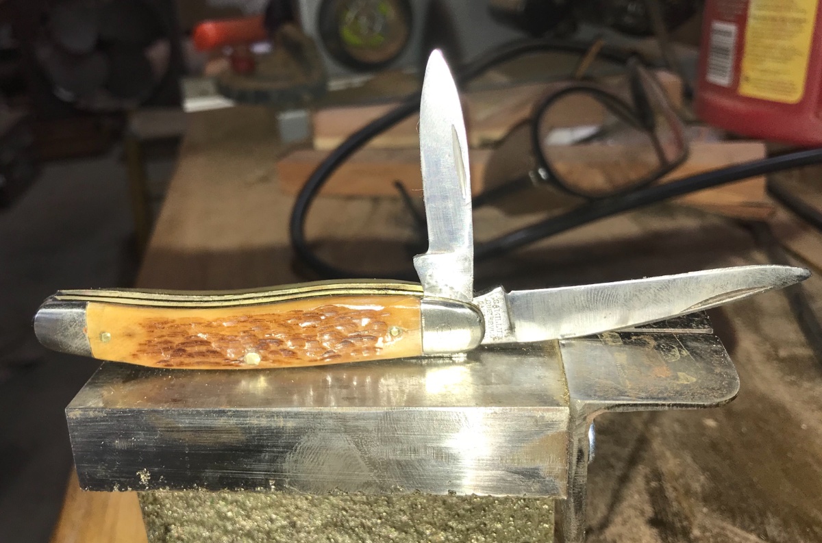

Open
Open
