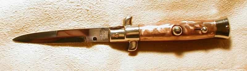

You can search "shell conversion" and come up with several. Here is one I did recently...
https://www.allaboutpocketknives.com/kn ... conversion

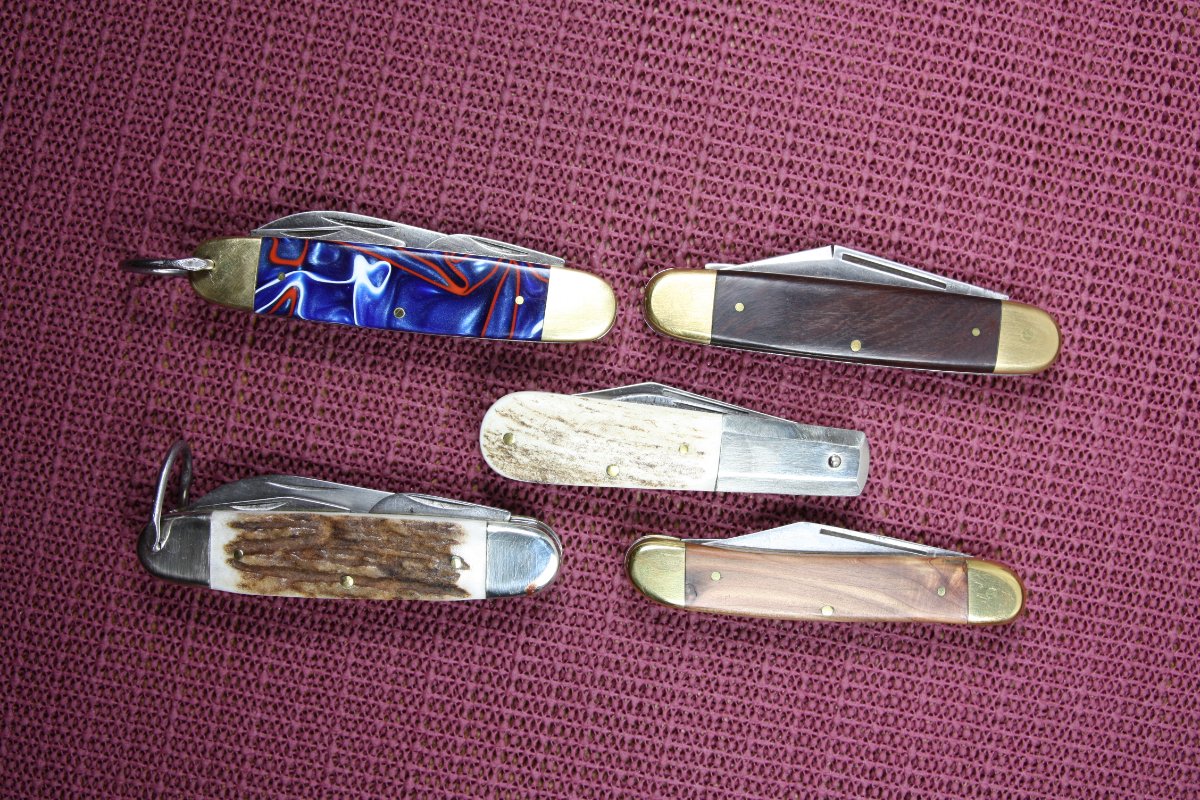

Shell handle conversions are kind of a fun project, although they can be a of of work. Sometimes I used the original steel liners, and sometimes make new brass ones. Bolsters can be nickle silver or brass. A few I have done.
2 Imperial Kamp Kings, in Patriot Kirinite and stag, an Imperial Barlow in elk stag, Hammer brand cattle knife in ironwood, and an Imperial stockman in aromatic cedar.
