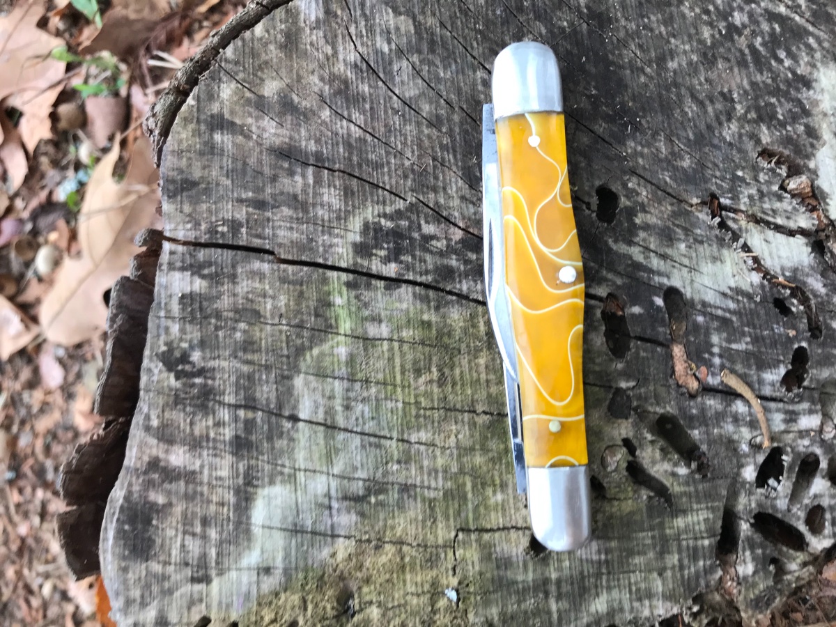

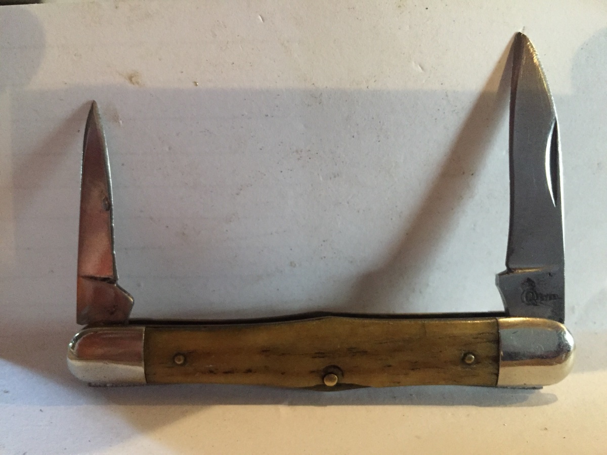

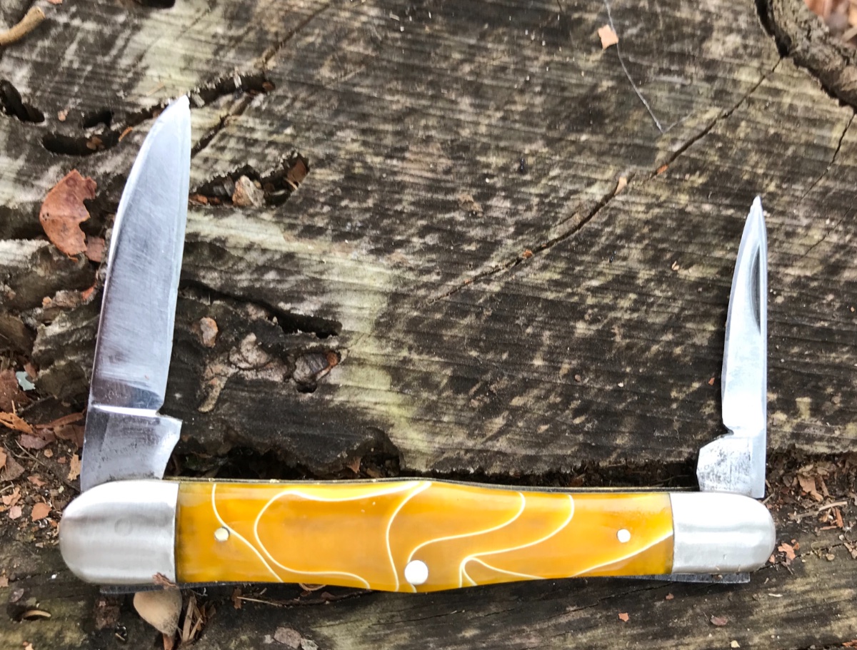

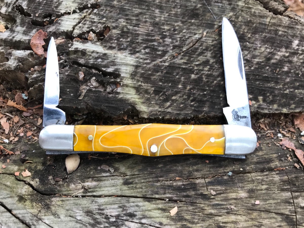

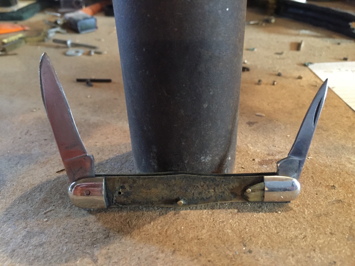

This beauty was pretty worn. I reshaped the Main into a Wharncliffe (it didn't take much!), and rehandled it in acrylic ($2.99 short pen blank from Woodcraft!)
Big chip missing below pivot pin.
Missing pile side
Missing pile side

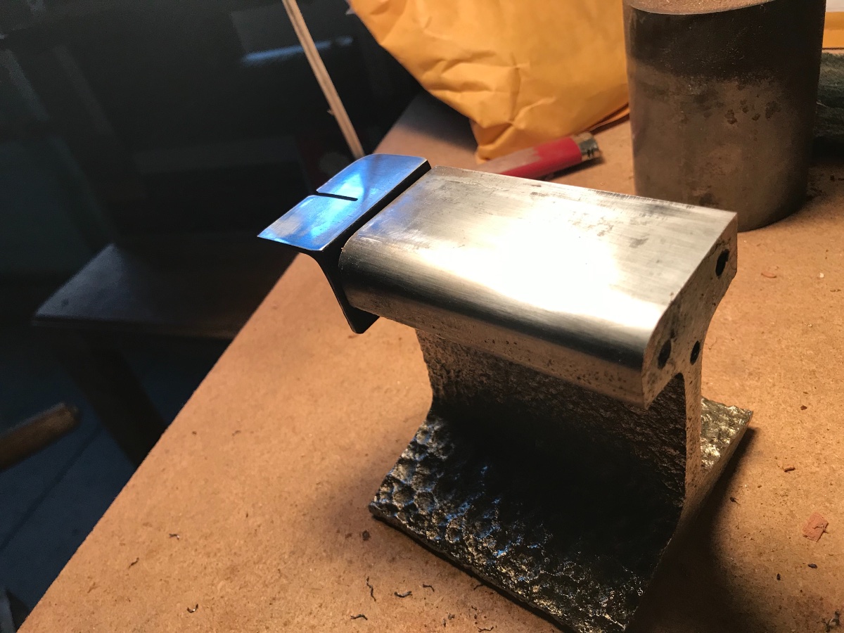

This is the first time that I have replaced scales without taking the knife completely apart. I am building a Stiddy, and was able to glue, clamp, and later pin the scales while the knife was together.

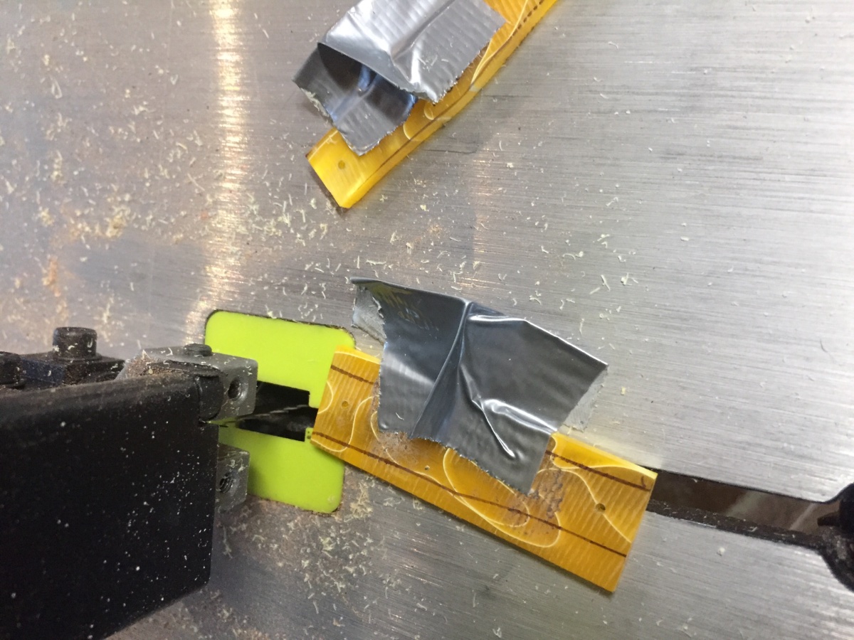

Rough cutting the acrylic - open all shop doors for ventilation!!!!
I actually did this twice - I cracked both scales the first time, before I had built the Stiddy.
She is going into my EDC rotation.

A picture of your stiddy? ::shrug::

doglegg wrote: Sat Oct 12, 2019 4:39 pm Really turned out very knice Reverand. The handles look great and the blade mod as well. Best one yet. ::nod:: ::tu::
Here you go, doglegg! It ain't much, and it is still a work in progress...but it was cheap! $20 piece of track, sanded flat on top, and a tang built from a piece of angle iron. I have much more that I want to do, but it seems that I spend so much time working on tools that I can hardly work on knives!

Very cool Reverand. Kind of special to make your own tools. Looks good. Thanks. ::nod:: ::tu::

Thanks for the pic of the stiddy Reverand. I need one of those and you've given me an idea on how to make one.

Good work on the knife, it looks really good, but I love your stiddy! ::tu::
They're actually pretty simple to make, the hard part is getting the top flattened. What did you use to flatten the top, an angle grinder?

orvet wrote: Mon Oct 14, 2019 2:20 pm Good work on the knife, it looks really good, but I love your stiddy! ::tu::
Dale,
I probably found the hardest way in the world to flatten the top, but it was all that I could think of:
I clamped the piece of track to a 4-ft level, and set it upside-down on a 4x36" belt sander.
I held it as level as I could and just let the weight of the metal pull it down onto the sander.
I had taken a picture if it, but I can't seem to find it.
It seemed like it took hours and hours, but probably wasn't too long.
