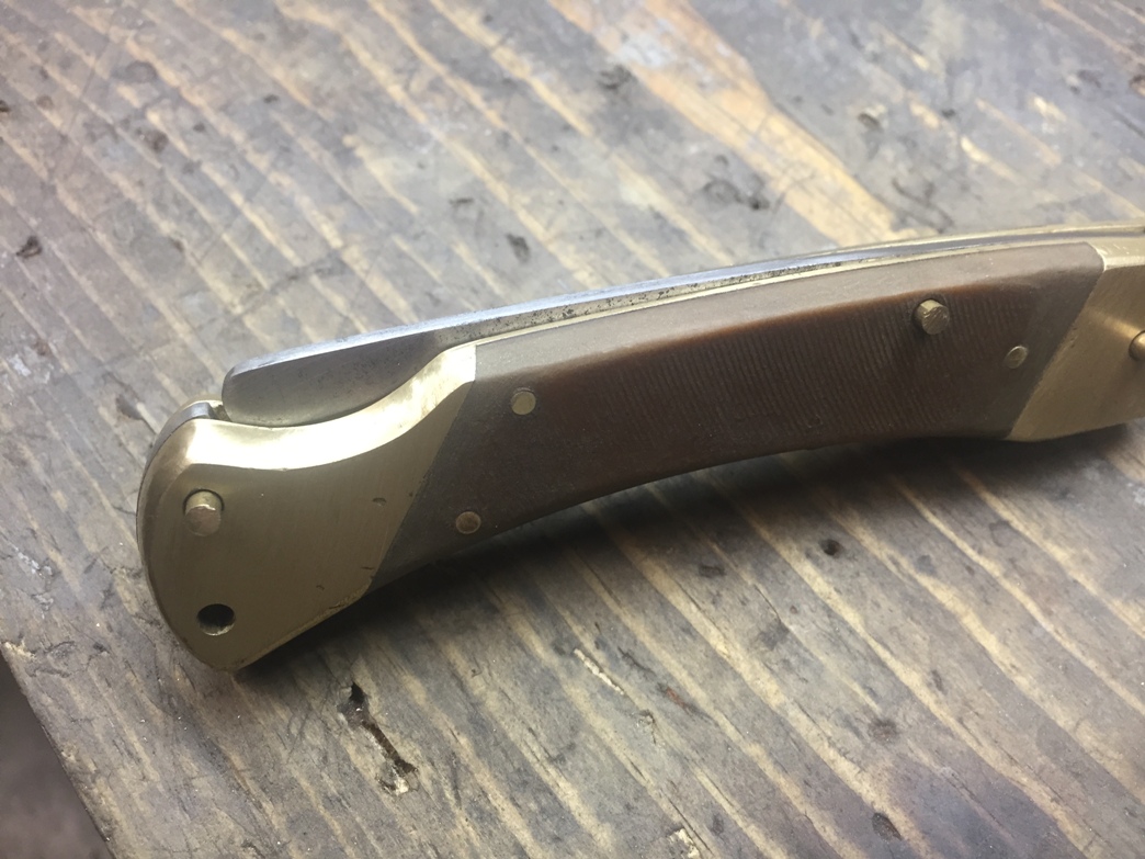

I got this 7-OT a few days ago. I am still waiting for my Barnett to arrive so I figured I would clean this guy up.

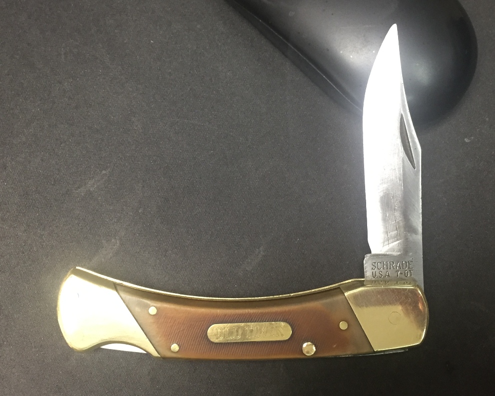

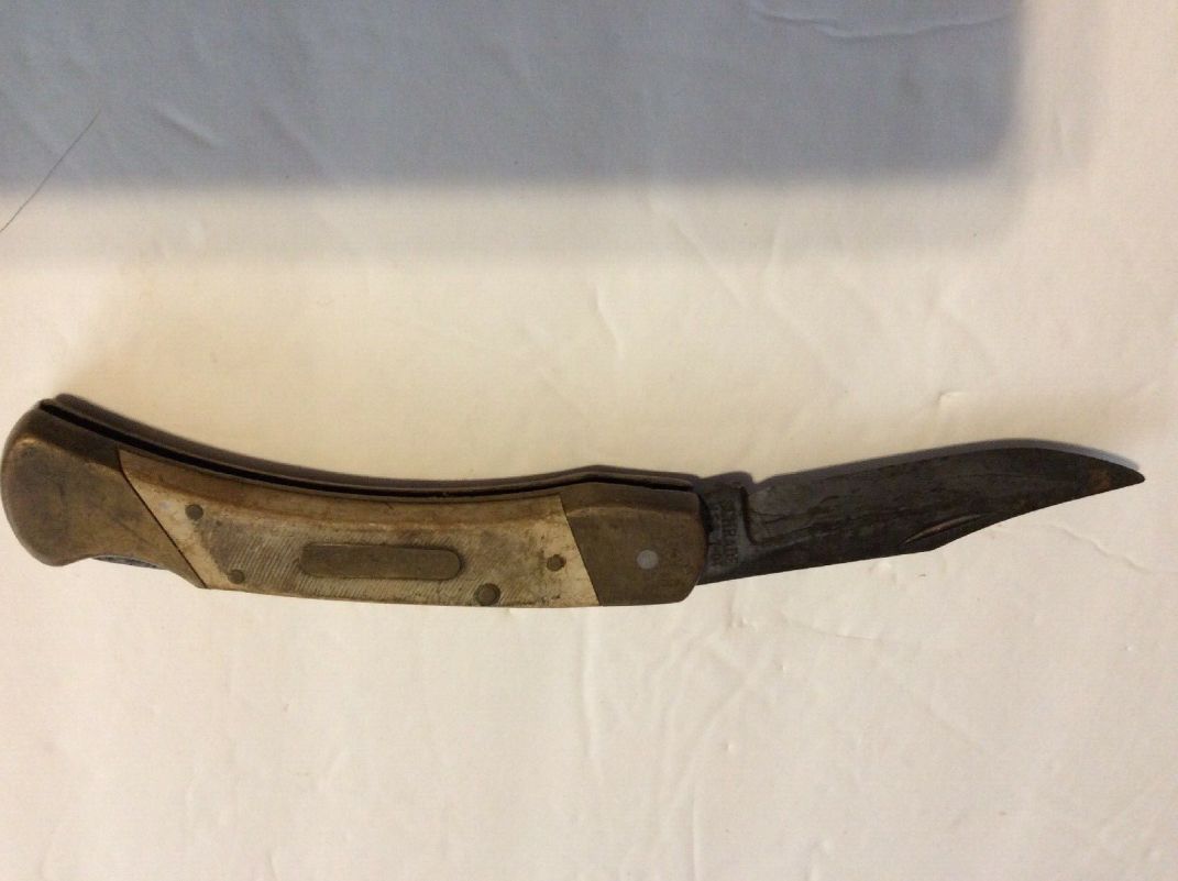

In hand... it was worse than the pictures so I figured out real quick I was going to have to disassemble this one for a good cleaning.

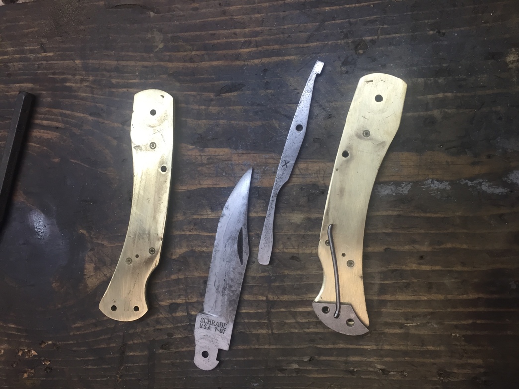

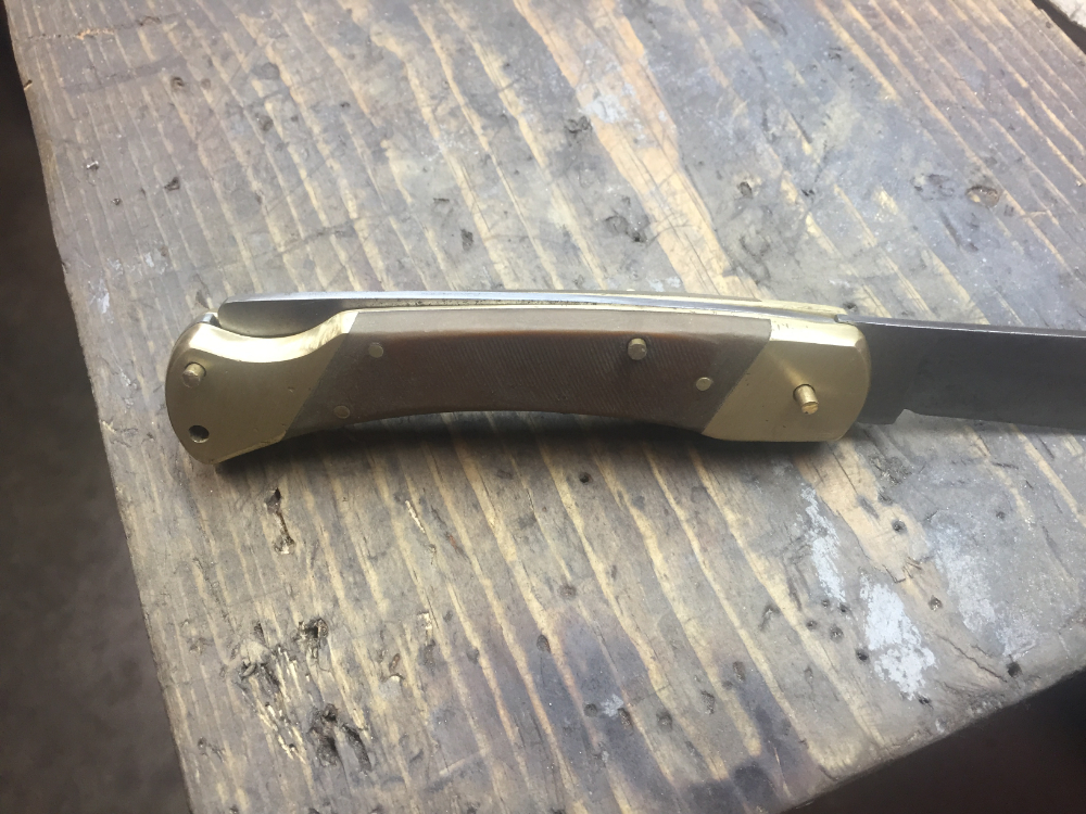

Seller's pics. Taken apart with a little clean-up. I noticed one thing during reassembly....
It appears Schrade used a tapered or stepped pin through the bolster at the blade. I had to use an over-sized rod and make a pin that would fit the existing holes in each bolster. The hole in the blade was the same size as the smallest bolster hole (IIRC)...

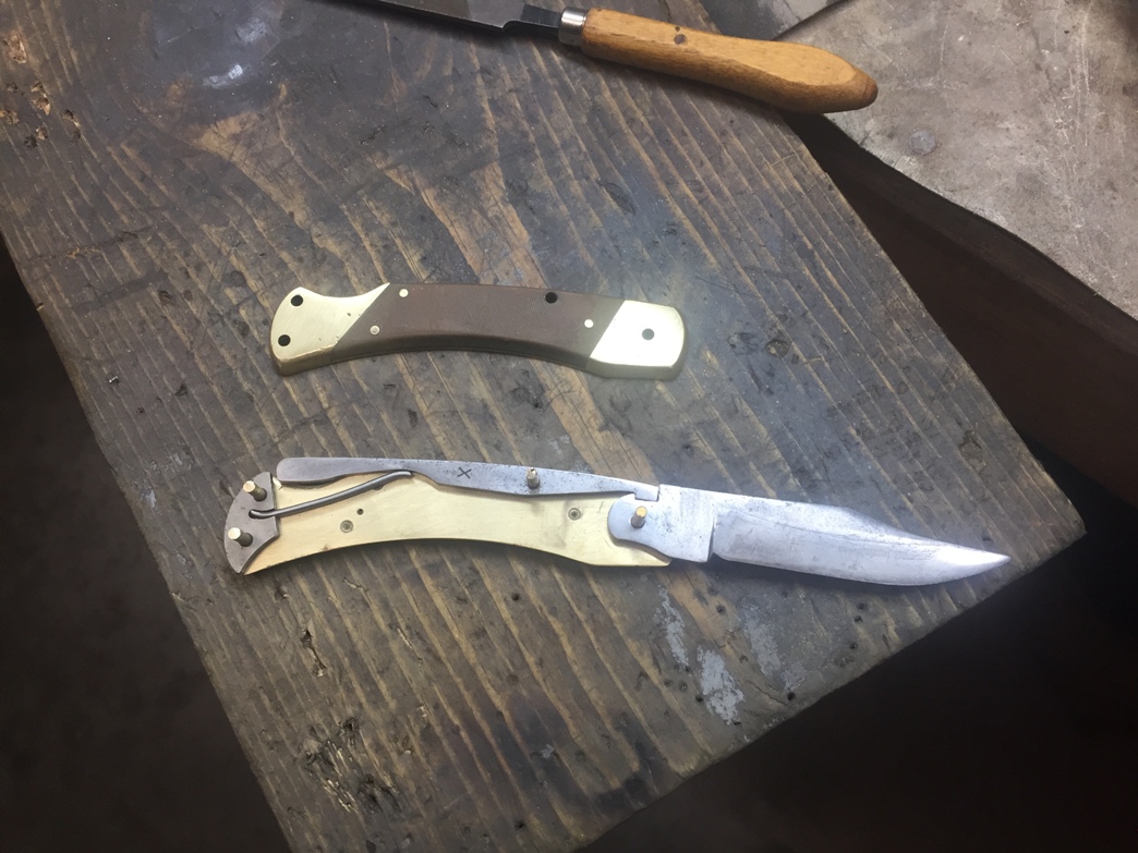

A mock up for fit...... The latch end of the lock bar had been beaten and abused and worn. When I put the other side on... the back of the bar stuck WAY up. SO, rather than make a new bar, I bent it slightly down at the rear and filed it to fit the handle profile.

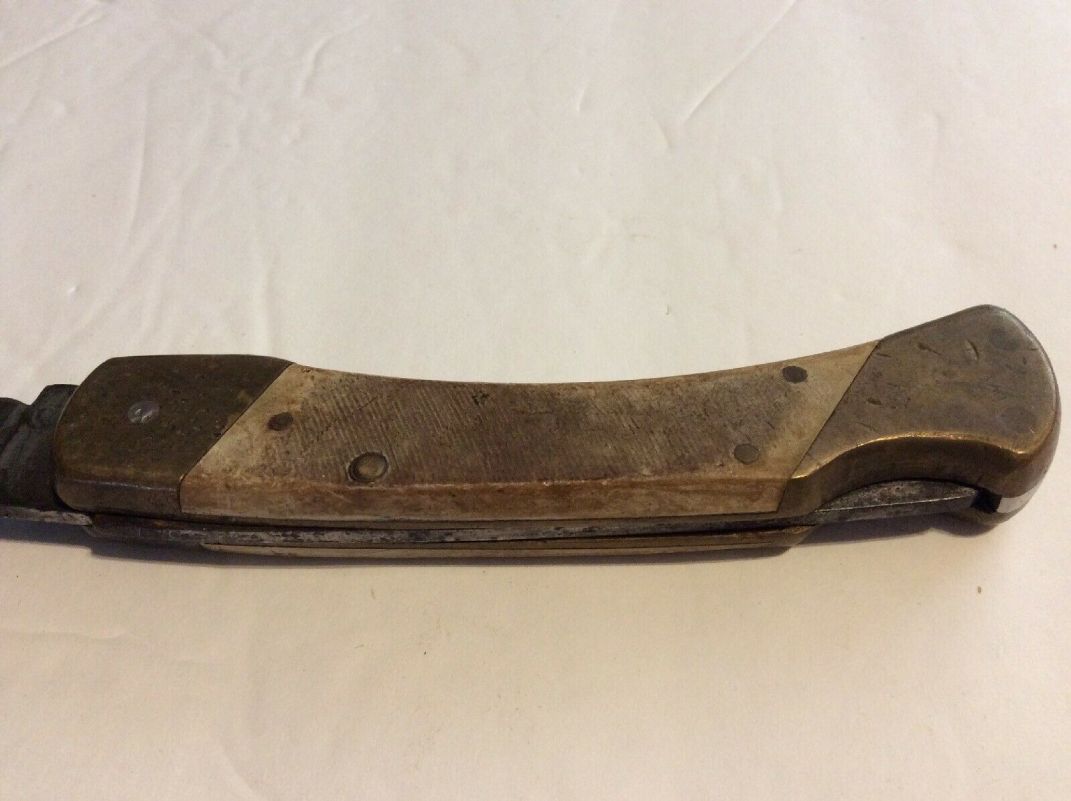

Here she is back together and working like she should.
(sorry for the crummy picture)
The blade still needs a little attention. I need to get those scratches out. She looks acceptable for carry once again.
