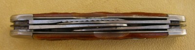

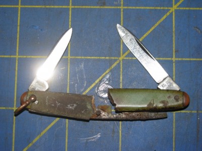

My only two STA-SHARP knives: a four blade stockman(9509)and a pen(9498)that the celluloid handles out-gassed and ate the brass liners and back spring away. The stainless blades are like new.

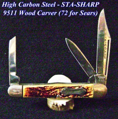

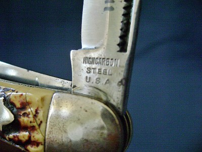

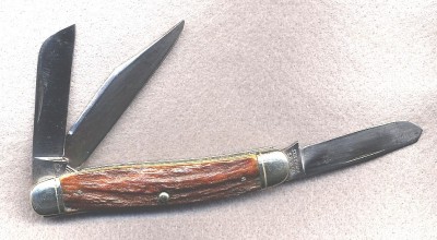

This is the only picture I could find of the Sta-Sharp Stag Stockman I sold. Pic will enlarge to read tang stamp.
Harold
Harold
- Old Hunter
- Posts: 8409
Re: Sta-Sharp Knives
Harold, is that red stag handles? Looks very nice and also very unique. OH

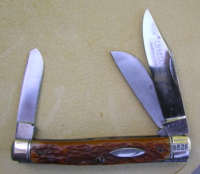

- jerryd6818
- Posts: 39458
The only Sta-Sharp I have.
From the Kastor list.

I don't remember I sold back awhile and that's the only picture I could find. HaroldOld Hunter wrote:Harold, is that red stag handles? Looks very nice and also very unique. OH

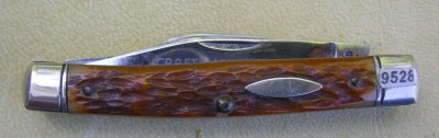

kootenay joe
- Posts: 13373

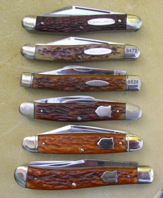

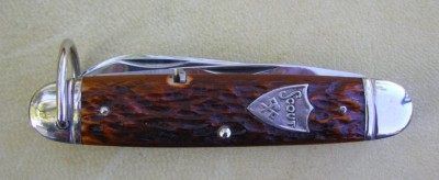

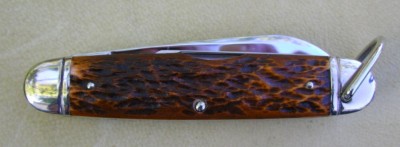

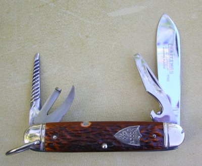

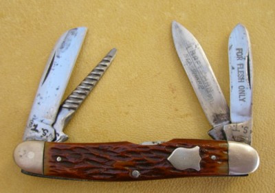

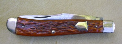

A few more bone Sta-Sharp knives, from 1930's, maybe early 1940's ?
Great knives. Camillus' finest folding knives.
kj

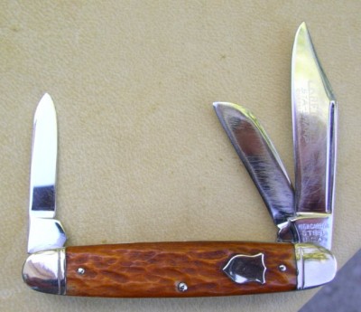

kootenay joe
- Posts: 13373
