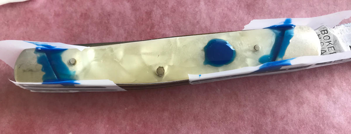

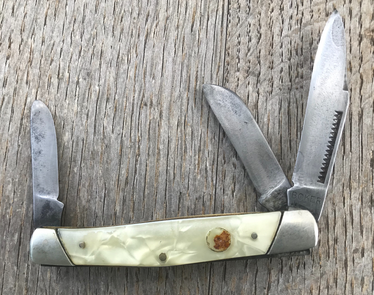

So I picked up a US Boker very cheap, with a missing shield and shrinking MOTS handles.
I thought that I would try the "low tech shield replacement" trick, as explained here:
viewtopic.php?f=37&t=62273

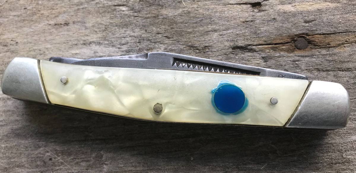

I added a couple of drops of blue Testors modeling paint to some clear epoxy.

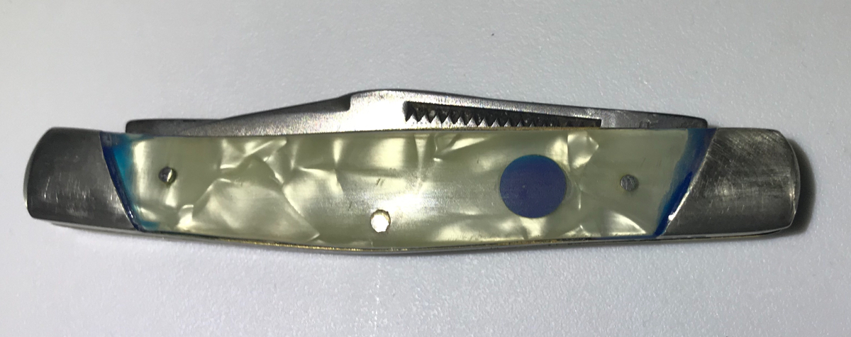

I loved the way it looked, and then asked myself, "Self, why don't we try that in those gaps where the handles are shrinking away from the bolsters?"
"Sure" (Self is easily talked into trying stupid things).
I had thought that it would make a crisp blue line between the handle and the bolster after sanding it down.
I hadn't thought about how the handle had shrunken thinner, as well as shorter. So the "thin blue line" kinda tapers off, and generally looks tacky.
So if anyone else thinks about a project like this on an old beater EDC, use a color that even sort-of matches the handle color (I should have tried with white - that would have looked better).
Still, I will use it until I get tired enough of it to replace the handles.

The shield part turned out good. I bet you could take a very sharp knife, or razor and "shave" off the thin part...back to a crisp line. That's the beauty of playing with an older knife, like this...you could always replace the entire handle, scale...whatever we decided to call them, this week...at a later time !!!

I don't think it was a stupid idea. I'd have tried that too...it looks better than it did! Kudos for trying something outside the box$

Great idea for a Boker replacement shield! Looks good!
Seems like I saw where one guy put a 223 cartridge rim in the hole. Looked pretty good. (Just make sure it doesn't have a live primer......LOL)
