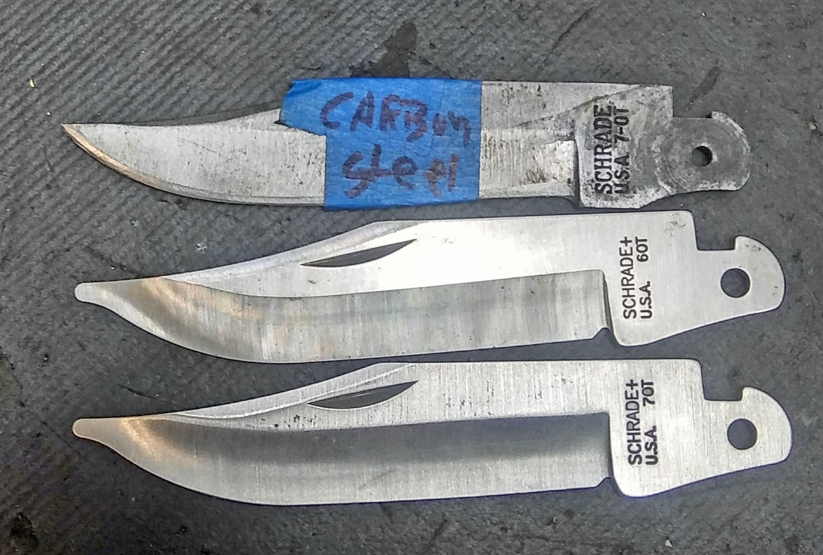

If I had time to dig through all of my blades and lay them out I know there are some differences with some of the special edition blades, the the Heritage blades, the scrimshaw blades, etc. Here is a 6OT blade between two 7OT blades. Notice that the 7OT blade blade on the top is carbon steel on the bottom is Schrade + stainless steel. The carbon steel blade is a smaller diameter pivot hole. Your 6OT blade probably has the larger hole. You will need a bushing to use the 1/8" pivot pin. I also found in SC507 blade that had the smaller diameter pivot hole.

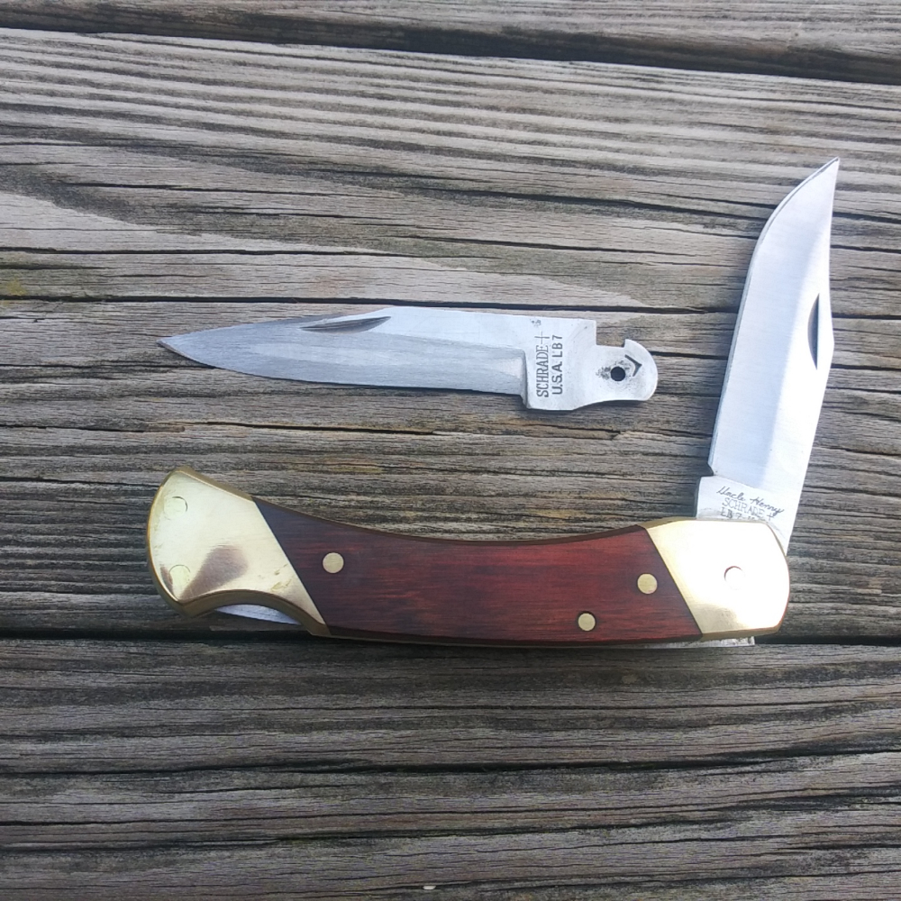

Very helpful Dale! Thank you for the effort you put into helping me. The blade I have is a 60 T and from the measurements I've taken the pivot pin and the notch in the locking lug are the same.
I love your answer PROBABLY! I'm replacing a worn, ground down blade in an LB7 and have available a 60t blade that is new. Laying it on the bolster of the LB7 it appears that it'll work. We'll see!

Eric, I got my LB7 blade in today and I do need a bushing. The diameter needs to fit in a .185 hole in the blade and accept a .125 (1/8) pin. If you have one PM9 me the info as to cost and shipping. I appreciate it!

Thanks to Eric and the bushings he sent me I was able to swap blades in this LB7! It wasn't a straight up in and out. It took quite a bit of fitting in the locking mechanism. I need to finish polishing the brass and work on my peening skills, but it's better than it was.
