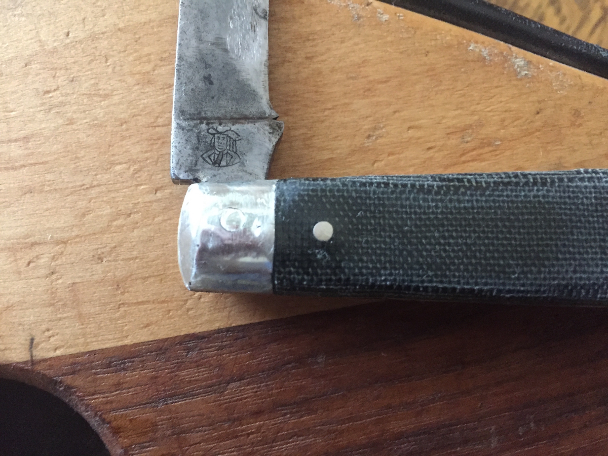

This thing looked like it had a rough life. Looked like it had been run over by a vehicle. You can see it was squished in. Secondary blade was broken. One bolster had an extra pin in it...where I guess someone previously pinned the bolster on, when it came off. Handles were wood and broken. For .99 cents and 3.99 shipping..the long pull, double swedge and large shield called my name. When I got it apart, all 4 of the bolsters dropped off...so I soldered them on to their liners. Took out the broken blade, hammered out the bent liners and rehandled in black canvas micarta. There is a small chip in the edge, but it doesn't affect it too much...it took a good edge. Figured I'll just let it sharpen out.
There's not too much to be found on the Quaker City Cutlery Company...if anyone has any info...feel free to chime in.
I kinda like the Quaker dude on the back side of the tang.

Was there any indication of how the bolsters were originally attached, either by solder or pins?
I have encountered a number of old German knives that had no means of attachment for the bolsters. They were hollow, curved pieces of nickel silver that were apparently held on by the pivot pins. As soon as I cut the pivot pins the knife was in pieces except for the springs and liners held together by the rocker pin.
Doc B
Posts: 3700
Location: San Antonio
Re: Quaker City Cutlery Company
Post by Doc B »
orvet wrote:Nice save Doc! ::tu::
Dale, the bolsters were indeed hollow. The liners (brass) appeared somewhat silverish, where the bolsters were in contact. May have just been the corrosion effect. I too was trying to determine if there was ever solder. If there was...it wasn't much. Based on the fact you've encountered many, without solder..I think it is possible, these were held on, originally, with just the pins.
