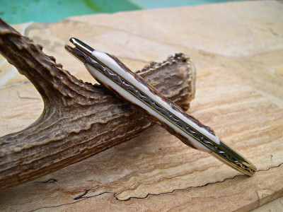

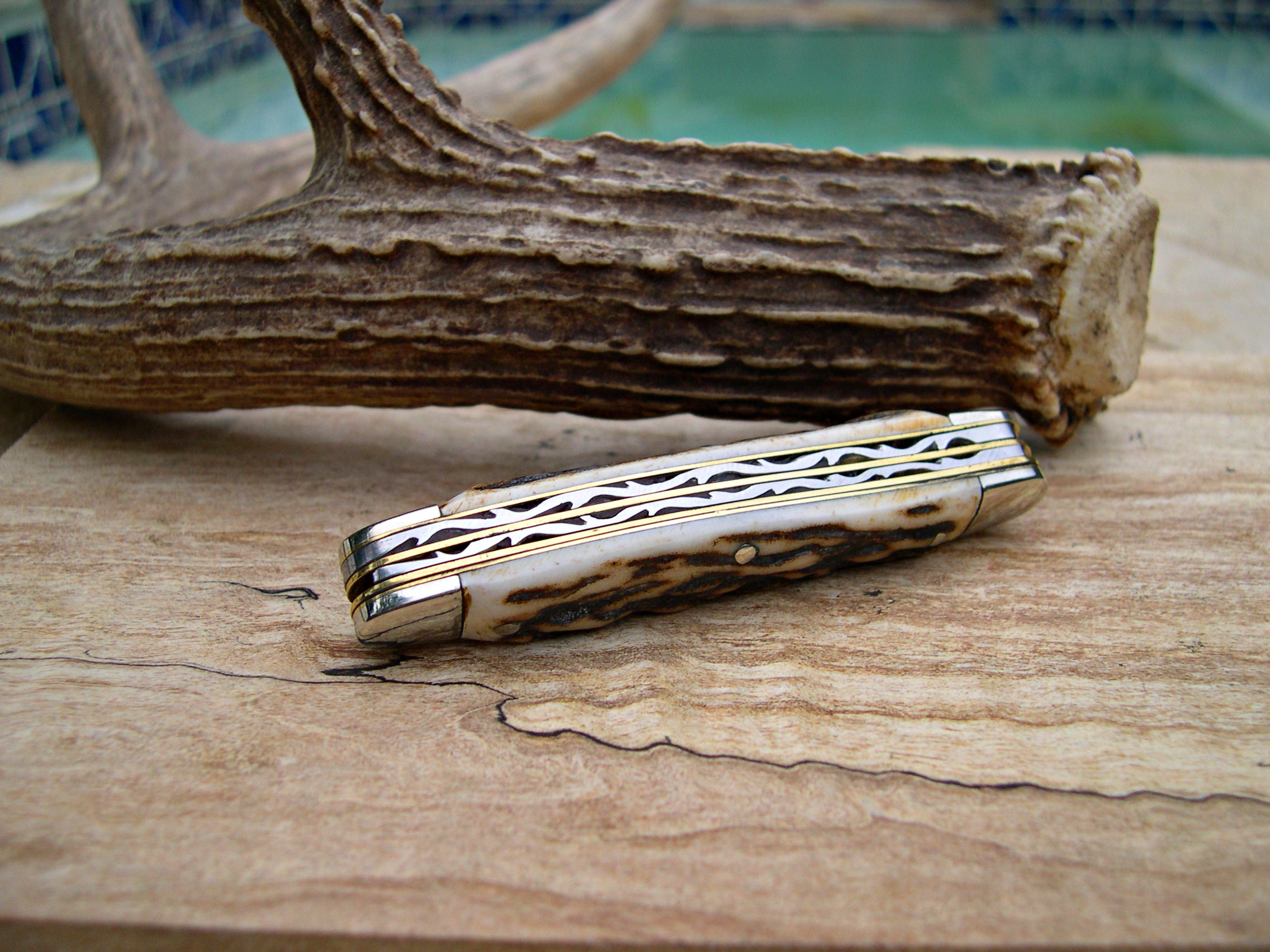

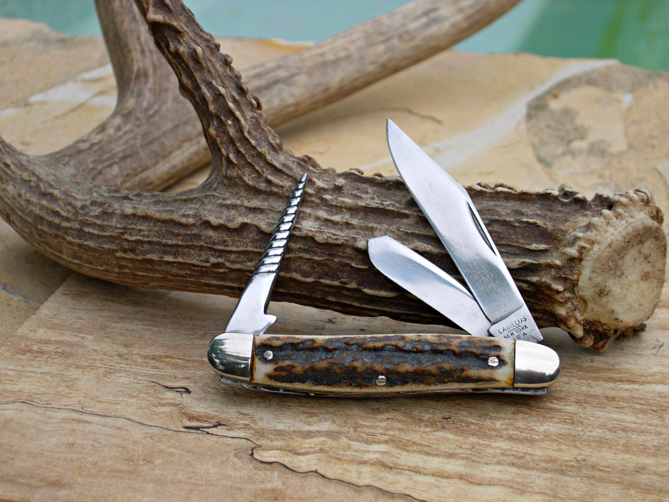

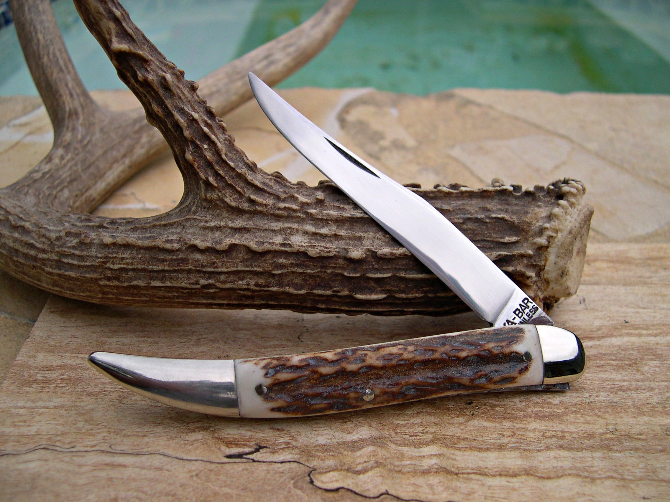

The first KutMaster I did a month ago -with carbon steel blades- is popping out all over with new corrosion spots. It was very dark with pits before I sanded and polished it up. Can that be stopped or discouraged? I didn't coat the blades with anything, however I did last use simichrome on them last. Is that just the way it is with these 50 year old carbon steel knives or how can I stop it? The stainless steel KaBar seems to be no problem, but this Camillus 2 weeks after the buffer is also starting to spot. I'm going to give these as gifts, do I need to also include lifetime buffing? Thanks again Marvin

looks like you're doing good to me. Sometimes when corrosion on a blade reaches a certain point, even though it's been removed it is still in the steel and some time after the polishing process it will begin to respot where the worst areas were, this has happened on two of my schrade EDC muskrats that were badly pitted.
