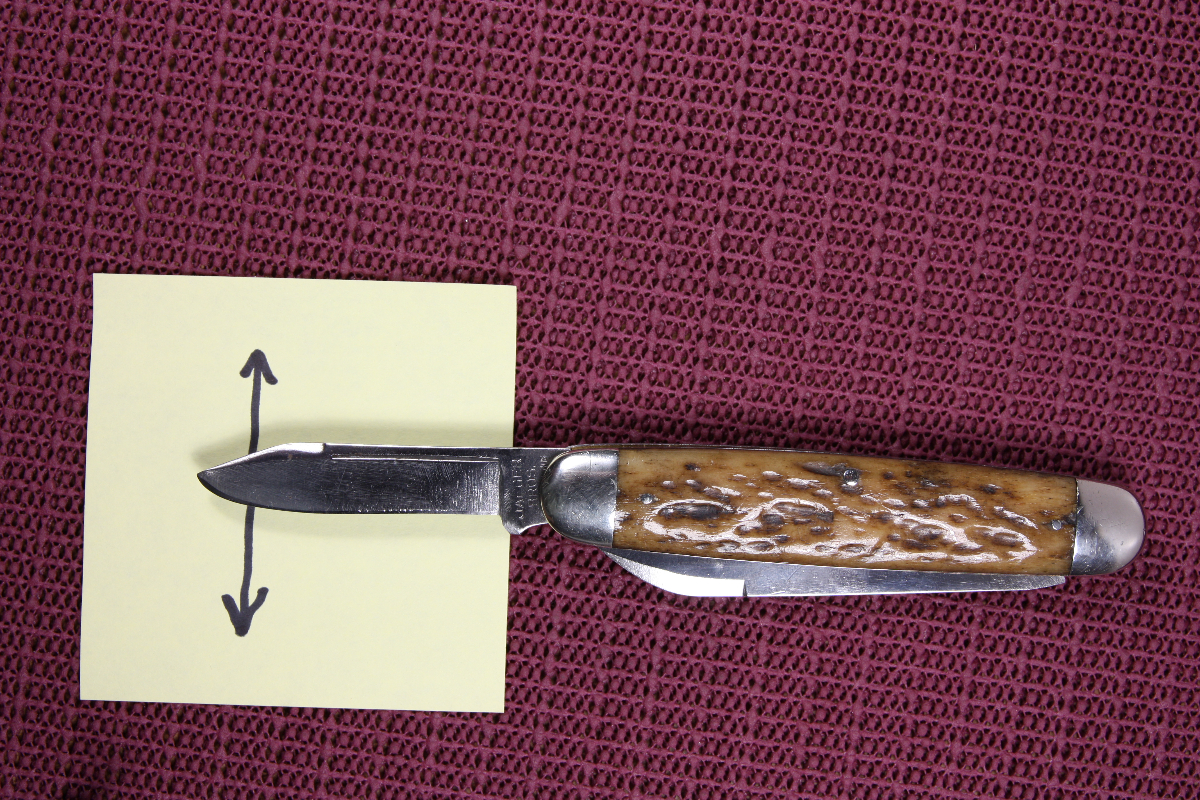

Does anyone have any tips/tricks to reduce some slight up and down blade play on a 1970 Case 6344?
- OLDE CUTLER
- Posts: 5677
- Location: South Dakota
Re: Up & Down Blade Play
If you mean that the blade has some looseness in the direction of the arrows with the blade open, probably wear in the joint and is not readily fixable without a major effort.bhuber wrote:Does anyone have any tips/tricks to reduce some slight up and down blade play on a 1970 Case 6344?

Yep, that is what I’m experiencing. Thanks for taking time to answer. It’s only slight and still a good knife for light cutting chores.OLDE CUTLER wrote:If you mean that the blade has some looseness in the direction of the arrows with the blade open, probably wear in the joint and is not readily fixable without a major effort.bhuber wrote:Does anyone have any tips/tricks to reduce some slight up and down blade play on a 1970 Case 6344?

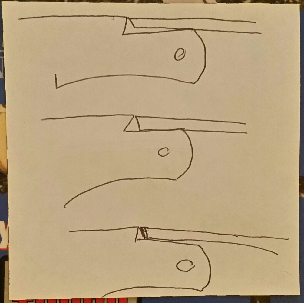

Up and down play on a pocket knife is caused by wear on the back tang, or a combination of the back tang and spring. Normally there is a gap beneath the spring when the blade is fully opened. This keeps downward spring tension on the tang, forcing the blade back tightly against the end of the spring. If that gap is closed due to wear, the spring winds up resting on the flat, cancelling out the forward pressure against the tang. If the wear continues to the point in third illustration, you've got a wobbly blade:
This can also happen if the spring is too short, but in that case the blade will appear to be over-extended when open, kind of sticking up beyond where it seems it should have stopped. this is referred to as a broken back.
A loose lockback blade is usually the result of the lock lever not engaging tightly due to a poor fit.
Eric
Eric

Awesome illustration and explanation Eric. Thanks!!!ea42 wrote:Up and down play on a pocket knife is caused by wear on the back tang, or a combination of the back tang and spring. Normally there is a gap beneath the spring when the blade is fully opened. This keeps downward spring tension on the tang, forcing the blade back tightly against the end of the spring. If that gap is closed due to wear, the spring winds up resting on the flat, cancelling out the forward pressure against the tang. If the wear continues to the point in third illustration, you've got a wobbly blade:
Eric

My pleasure guys, always glad when I can contribute something. Glad you can make sense of my rudimentary artwork!
Eric

Excellent topic! I really appreciate the input and Eric's great drawing!
