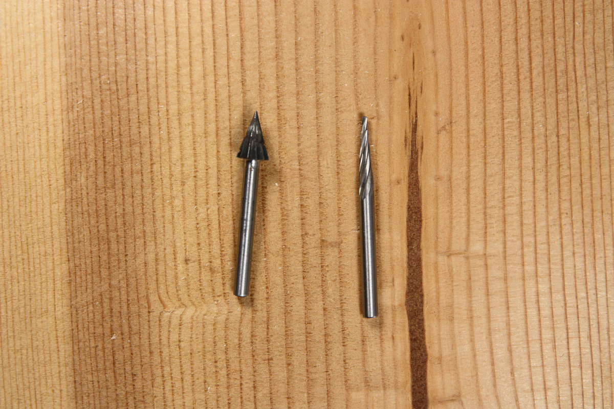

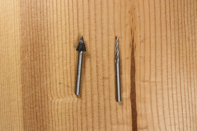

I was digging around in my Dremel tool box and came up with a couple of other bits that I had forgotten about. One is a mini countersink tool with a sharp angle and the other has a more gradual taper. They are both 1/8" shank and I would turn them by hand with a pin vise. Is a gradual taper better that a steeper one for this?

In my experience the steeper taper is more difficult to get a seamless invisible pin job on. Factory holes seem to be more gradually tapered which is what I do.

A countersink works but another choice to consider is a broach. They come in various sizes and taper all the way to the tip.

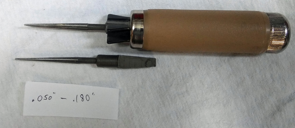

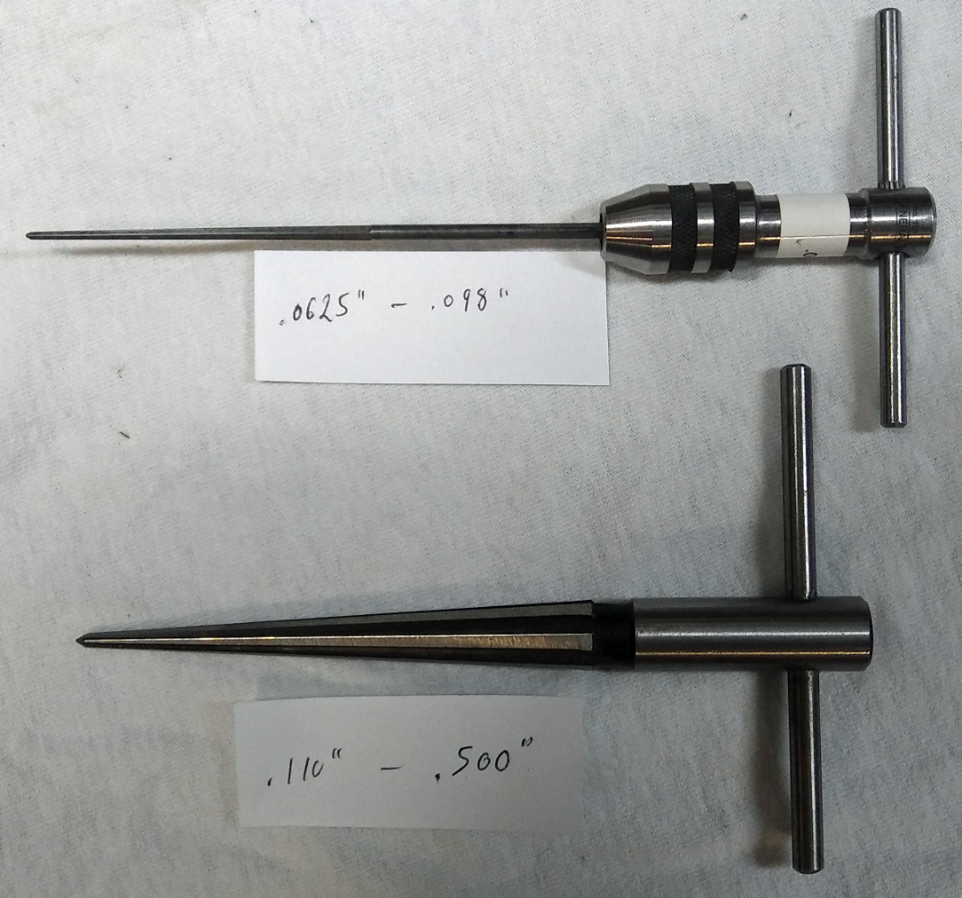

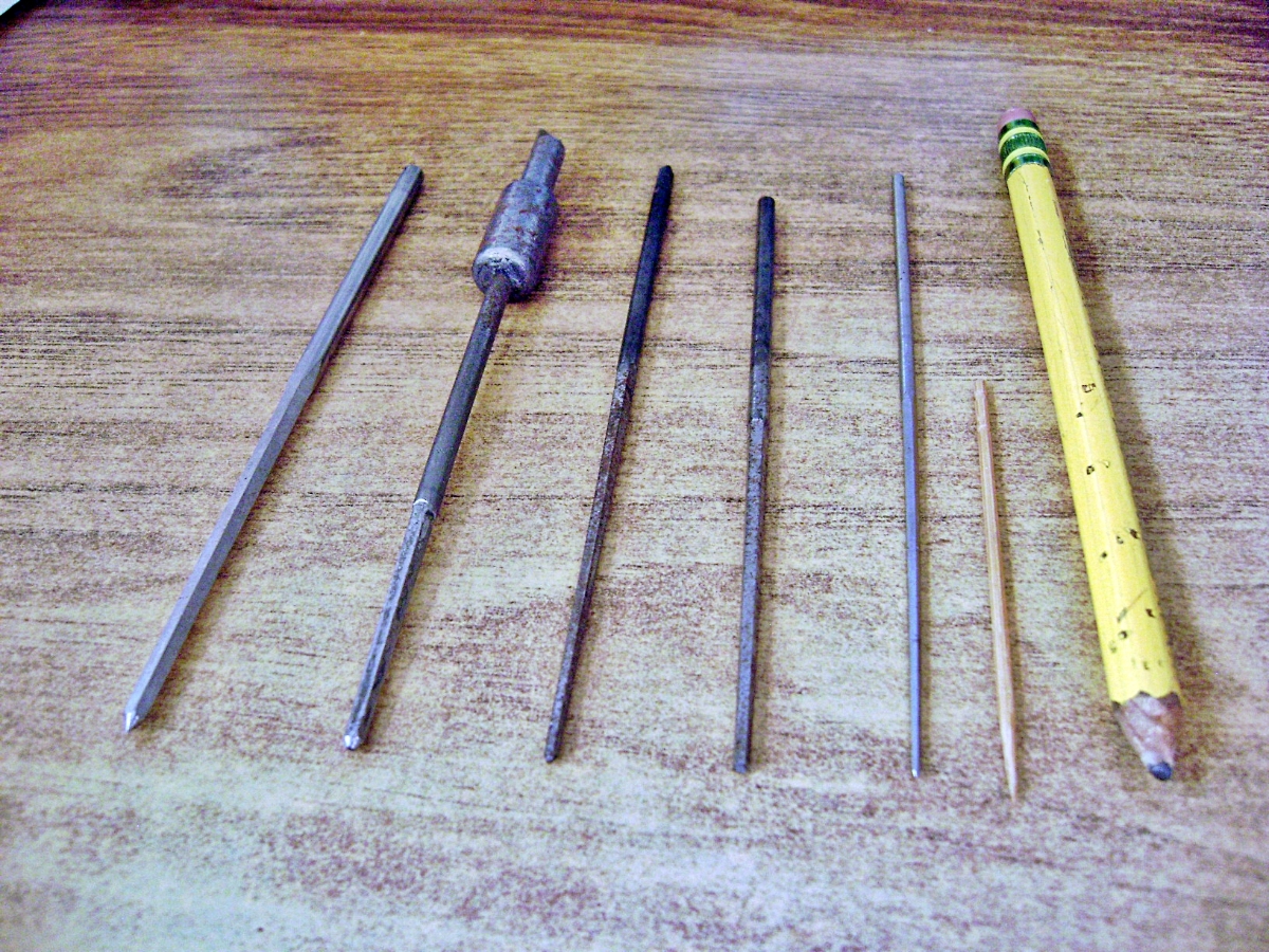

These are the tapered reamers I use for pivot pin holes.
This is the reamer I use 90% of the time to put taper in the pivot pin hole. The two reamers are the same, I just modified the end of the old-style chuck used with a brace and bit. I think this reamer was originally made to work in a hand turned brace. I modified the end so I could clamp it in this handle and it works great for 90% of the pivot pin holes I need to add taper in.
I have a few other reamers, the top one here is a broach that JerryD sent me. TYVM Jerry!
The bottom reamer is one I use occasionally, it works well to add taper to a 1/8" hole.
If I had to rely on only one reamer for pivot pin holes it would be the one in the upper picture. I found that top reamer several years ago on eBay, (I got a couple in case one breaks). My personal preference is not to use powered reamers because they will often tend to pull themselves into the hole, especially if there's any twist to the cutting-edge, and this can result in cutting the whole deeper, and perhaps even larger in diameter than you can use.

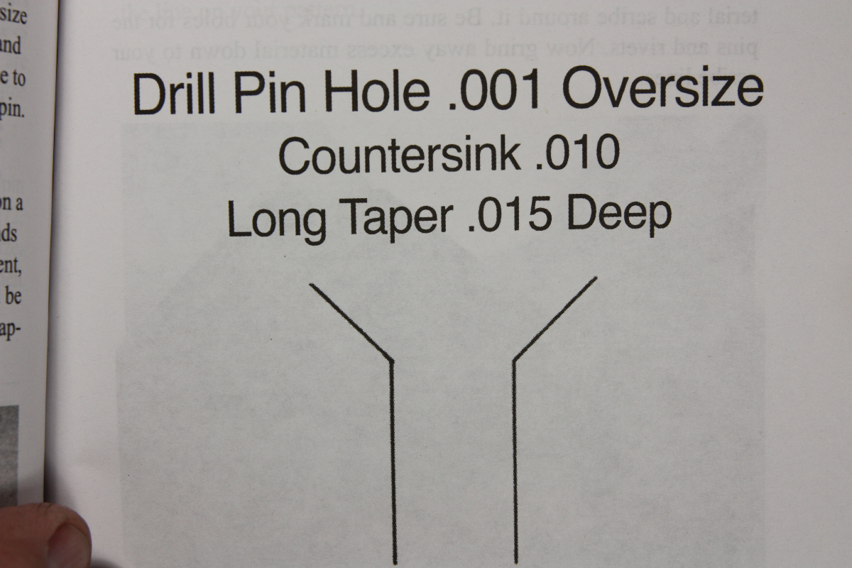

I think in one of Wayne Goddard's books he has a picture of a device he made using a conical Dremel bit so that he could taper pin holes by hand without using power tools. He used a wider hole because in general he made fixed blade knives and was wanting to provide a recess to peen the pin into. I have a couple of the wider reamers I use to recess a rivet into a handle. If anyone's interested I'll take pictures of those in post them.
But I never use the wider reamers for pivot pin holes because it is very difficult to get a good invisible pin in the bolster as Kaleb mentioned.

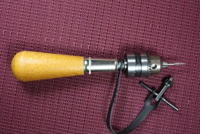

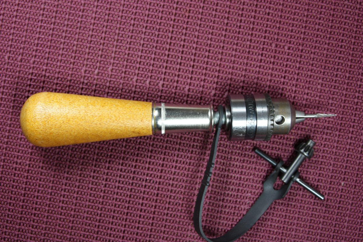

I am going to try this rig, which is a Dremel tapered reamer chucked into a home made pin vise (old drill chuck, bolt with the head cut off, and a wooden file handle). The reamer has a tendency to pull itself into the hole because of the twist on it as you mentioned, so caution will have to be used. I wonder if it would be better to chuck it into the drill press, clamp the bolster down, set the depth stop, and turn the drill press by hand while lowering the bit?orvet wrote:muskrat man wrote:In my experience the steeper taper is more difficult to get a seamless invisible pin job on. Factory holes seem to be more gradually tapered which is what I do.
I have a few other reamers, the top one here is a broach that JerryD sent me. TYVM Jerry!I have a couple other broaches Jerry sent me for even smaller holes which I encounter once in a while, usually on a very small knives.

I think that will be fine, just make sure you don't let it bite into the bolster and start threading in. That could easily happen with a drill press, which is why I never use powered reamers for something like this. Even if the knife were in a vise and that reamer caught in the bolsters started to thread itself, I think it could even pull the bolster off the knife, especially an old knife with a loose bolster.OLDE CUTLER wrote: I am going to try this rig, which is a Dremel tapered reamer chucked into a home made pin vise (old drill chuck, bolt with the head cut off, and a wooden file handle). The reamer has a tendency to pull itself into the hole because of the twist on it as you mentioned, so caution will have to be used. I wonder if it would be better to chuck it into the drill press, clamp the bolster down, set the depth stop, and turn the drill press by hand while lowering the bit?
I know it takes a lot longer to do things by hand, however adding power makes things happen much faster, usually faster than I can react!
