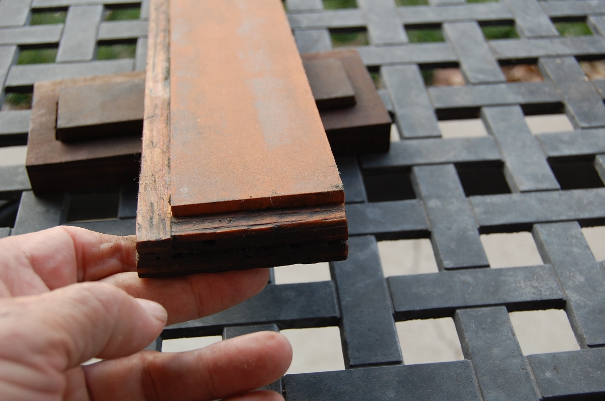

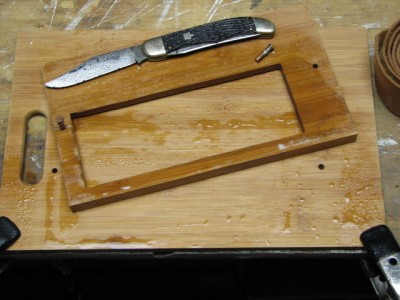

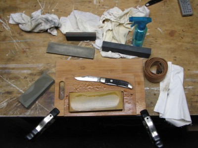

A few more tips for you from a guy that has been doing this type of stuff for more than a few years. I made a inletted piece of wood to put a small stone in, that way you can remove it and wash it. Also made a 3 sided piece of plywood that I put a large 11 inch stone in. The stone is even with the edge so you can get a fixed blade right up to the guard and again remove for cleaning. Not much money involved just a little time. I think the "secret" is keeping the stone clean, what ever you use for lub, water, oil, kerosene. Just my 2 cents worth, you can either use it or pitch it. LOL ::handshake:: Terry

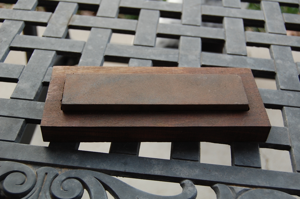

FRJ
Posts: 17130
Location: Ct.
Re: Sharpening stone "re-conditioning".
Post by FRJ »

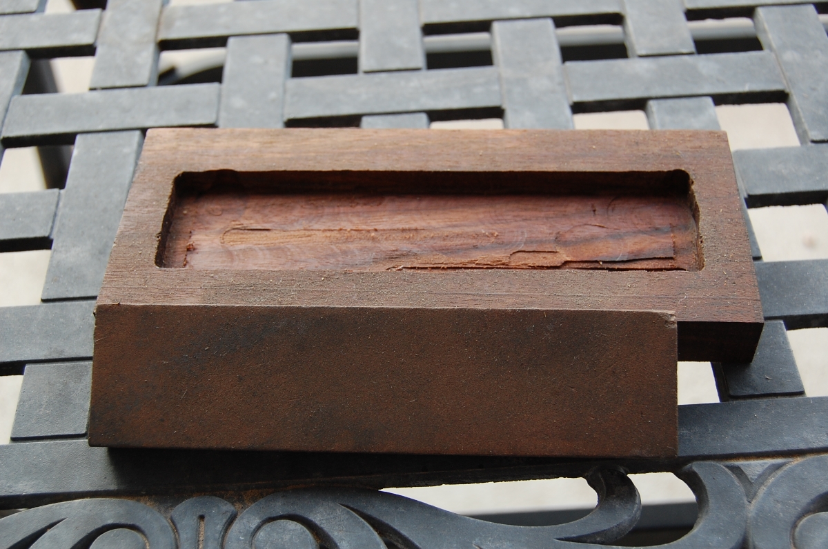

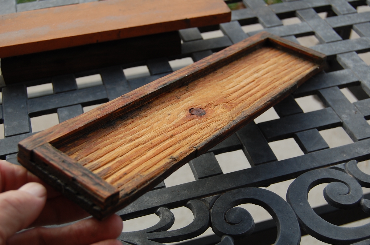

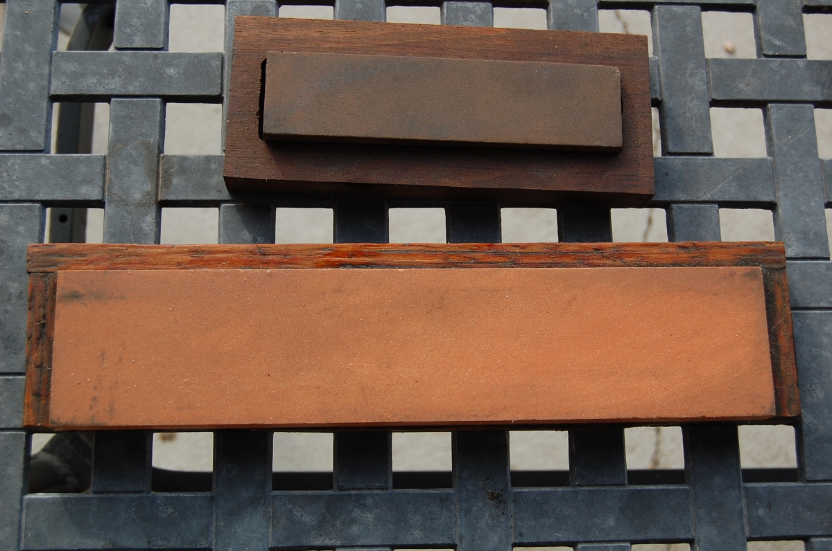

terryl308 wrote:A few more tips for you from a guy that has been doing this type of stuff for more than a few years. Terry
That's a nice approach, Terry. Those are beautiful stones too.
I have something similar.
Sharpening 1.JPG (32.52 KiB) Viewed 4570 times
Sharpening 2.JPG (32.94 KiB) Viewed 4570 times
