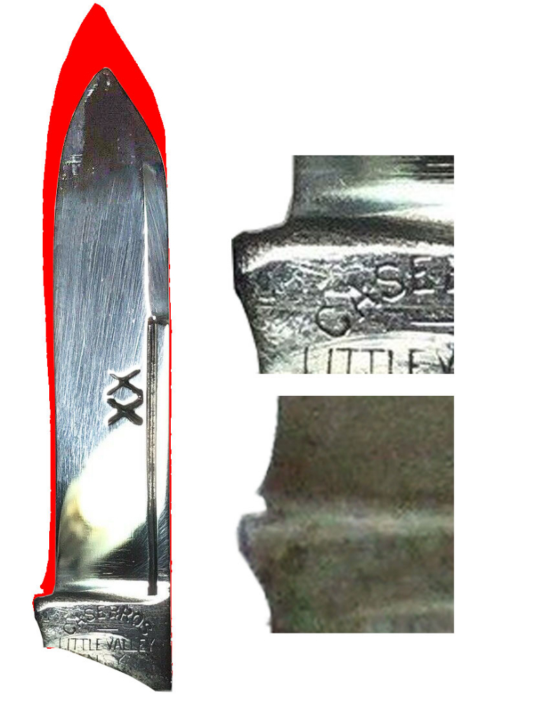

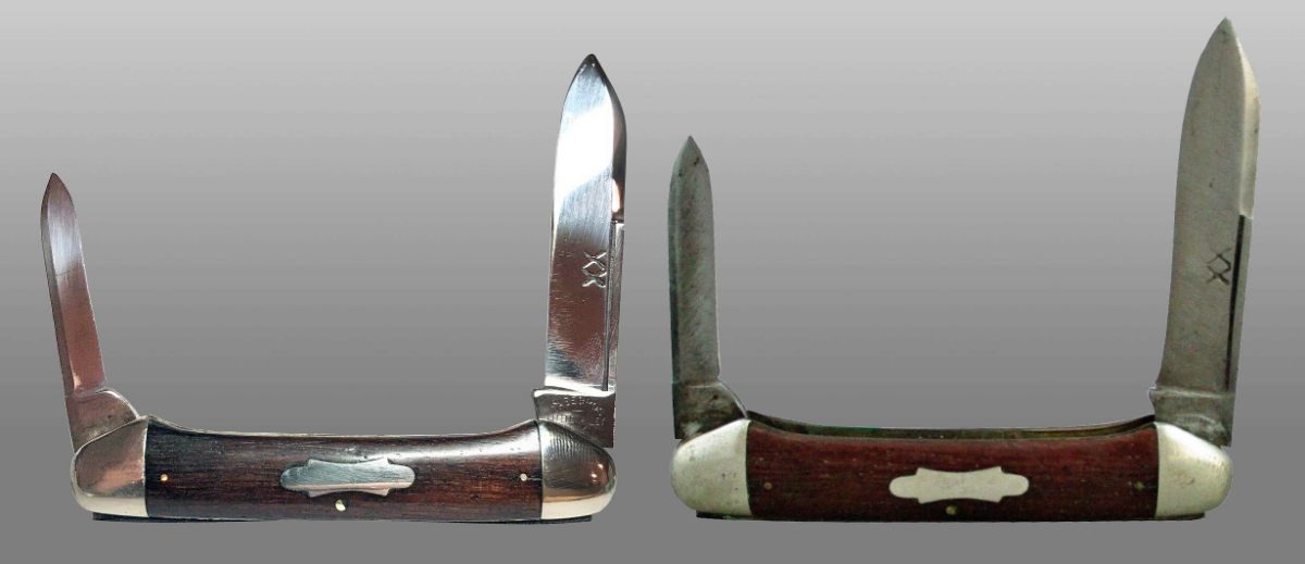

You will notice that both listings are for the same knife a Case Bros Springville NY (rare mark) 1294 X. The handles are walnut which is why I am saying the first number in the pattern number is a "1" (a "6" might also be appropriate).
The description on the new listing says "Very rare very hard to find mint condition great snap Full blades". The only parts of the description I would question are the "mint condition" and "Full blades" parts. During the time between the end of the first listing and the post of the second listing the knife has been refurbished or as some would say "cleaned". Part of the cleaning involved removing dirt. Another part of the cleaning involved reshaping the main spear blade. Before and after comparison pictures are posted below.

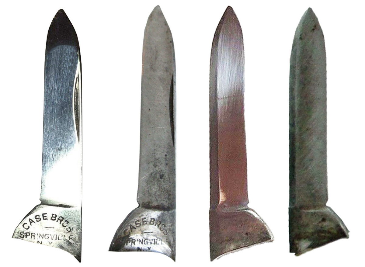

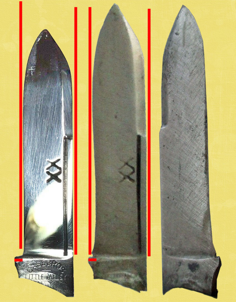

The camera angles are different so the length comparison of the main spear blade may not be accurate, however there was blade loss to begin with and the blade has been reshaped somewhat to disguise the evidence of blade loss from sharpening. The camera flash interferes with ability see the blades clearly. The secondary pen blade appeared to be reasonably full to begin with and doesn't seem to show any alterations.
It would be very surprising if this knife sells for anything close to $4,000. My opinion is that behavior like this does not benefit the knife collecting hobby. I wouldn't begrudge anyone the right to make a fair profit.

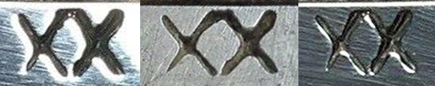

Interesting Jerry ... Do you think they added to the XX on the blade or did the buffer bring out more of it? Personally the 2nd seller no doubt wrecked the knife in my opinion... even without your post and description that knife no doubt looks aggressively cleaned... Begrudge someone to make a profit in an honest way is ok by me - but I truly frown upon the seller or similar sellers who buff and reshape nice old knives with dishonest intentions to sell... jmo

Looks Ruined IMO Jerry . You Never Ever Change the Blade Geometry When Cleaning a Knife ,, P*SS POOR Attempt if there ever was one ::barf::K.C.

Lee, I don't think the "XX" etched on the blade has been altered in any significant way. It does appear to be, but I think that is an artifact of photography (flash, angle, etc.). In the picture below, the original "XX" is in the center and 2 different images of the cleaned "XX" are on either side. I don't see much difference in the before and after in these close ups. In addition to preferring the original rendition of the knife, I prefer the original photos, too.LongBlade wrote:Do you think they added to the XX on the blade or did the buffer bring out more of it?

.. Definitely the same in each photo... No doubt the first auction the knife looked like an HOK Case and was no doubt more appealing in my eyes as well... Curious if the first sale price at auction was considered within the market range for Case collectors ? - And just curious if the buffed knife was "truly" mint & original if it would be in the $4K range? I really don't follow Case in detail so just curious but I do know the old ones can be pretty valuable..

I’m left wondering why the blade was re-profiled? Doesn’t appear to me that there was anything wrong with it. Buffing it was bad enough but to cut it down is criminal!

Ken that was exactly what I was wondering! That is one thing I am always attempting to evaluate on any offering. Natural blade loss over time is one thing but to blatantly reprofile and intentionally reduce blade length this aggressively is crazy! And to what end? He effectively destroyed any real collector value on this Case Bros. Jerry, great pictorial commentary and evaluation

This is a reminder that the length comparison in the pictures may not be accurate. In the before pictures the knife is completely vertical. In the after pictures the knife is tilted back a few degrees. The blade height is unquestionably less because the curvature on the blade edge due to sharpening has been removed.
The blade is probably at least a little short, but because the photos are on a different plane the difference in length my be an optical illusion.
This could be another optical illusion due to flash, but it is confounding that the blade would have more scratches AFTER it has been polished.
