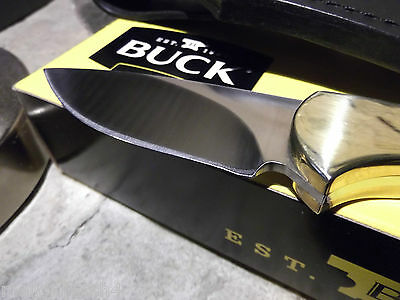

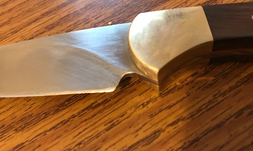

I just got a good deal on a Buck Ranger skinner.
It has a terrible grind IMHO. It is a sweeping and curved grind. Making the base of the edge very fat even though it has a massive choil. Here is a pic of one. Mine was worse.
eveled
Posts: 2582
Re: Buck 113 Ranger skinner

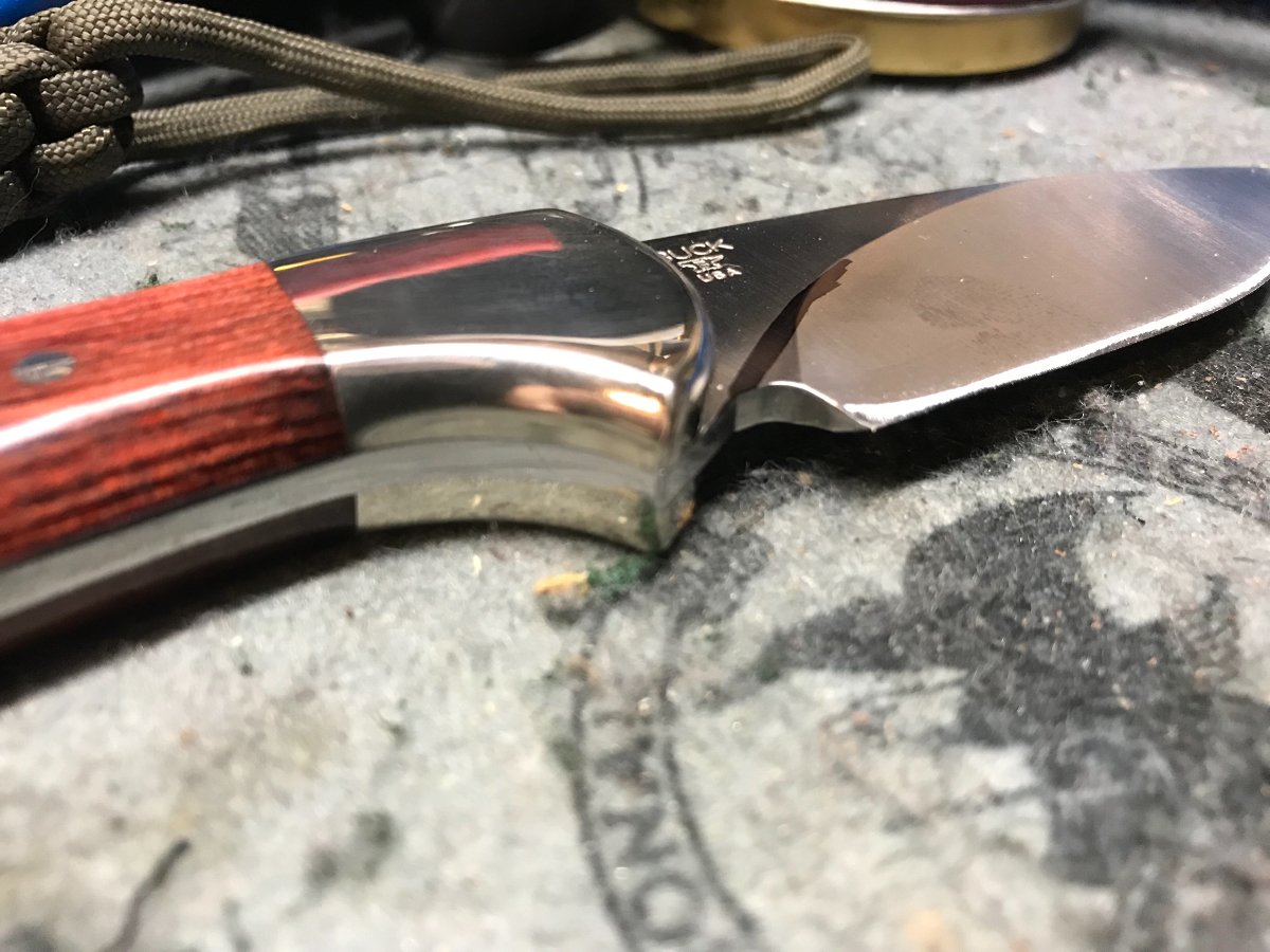

Post by eveled »
My OCD got the better of me and I “fixed” it with a dremmel tool. It’s not perfect looking but it’s at least easy to sharpen now.

If Buck had only brought the grind line to the other side of the choil by the brass it would be perfect.
eveled
Posts: 2582

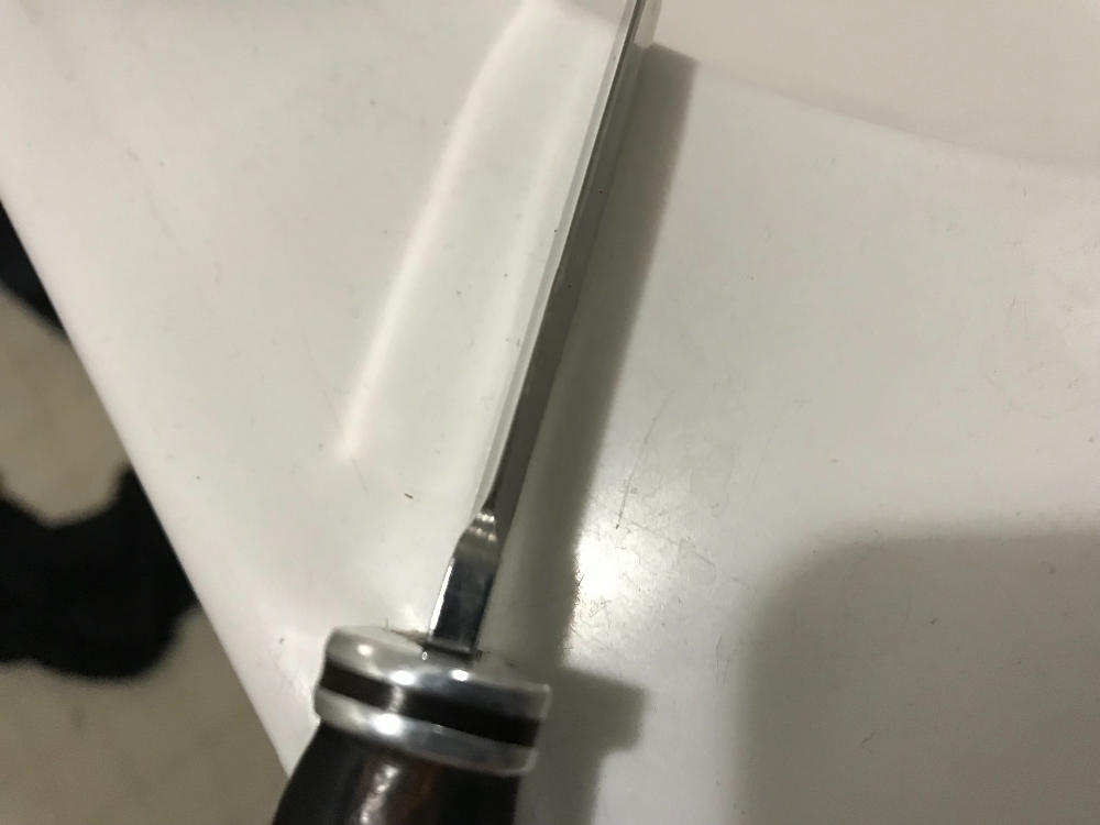

Post by eveled »
Here is the picture I sent to Buck with my recommendation to move the grind line to the other side of the choil.

I agree the picture you sent them provide a much better edge profile.

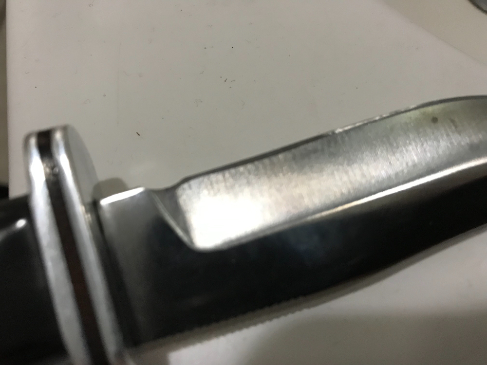

Post by eveled »
Here is another little Buck knife with a sweeping grind. ::teary_eyes:: This one I added a much larger choil too. Not too deep, but wide enough to cover the whole sweep. It turned out good, and it is a good place to strike a ferro rod.
