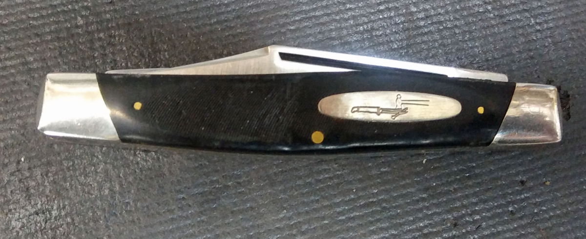

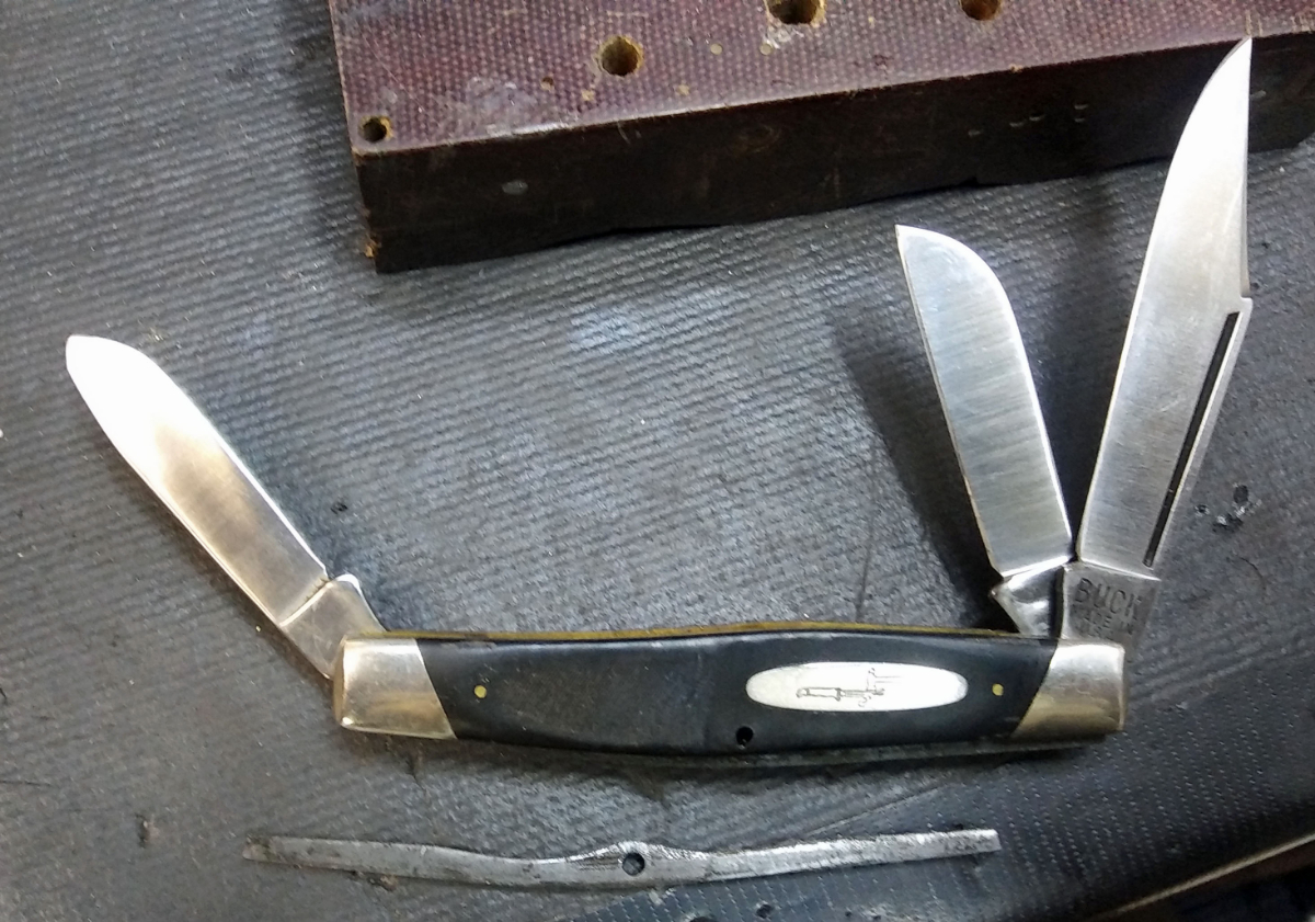

It seems like every time I post a knife that I've customized I forget to take before pictures or I can't find the ones that I took.
I took a whole bunch of pictures this time I and I named the picture with the task I was doing. There are some gaps, but it goes up to the test fitting with the pins.
It looks like I'm only going to get 8 pictures post so it's going to take me 4 posts to show all the pictures.

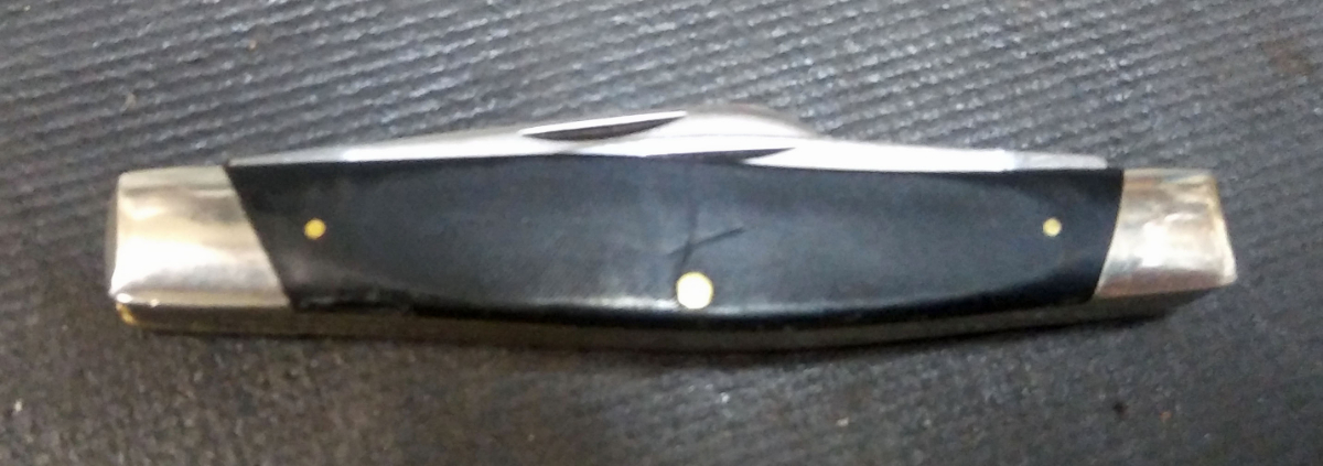

Before – mark side
Before – mark side
Before – pile side
Before – pile side

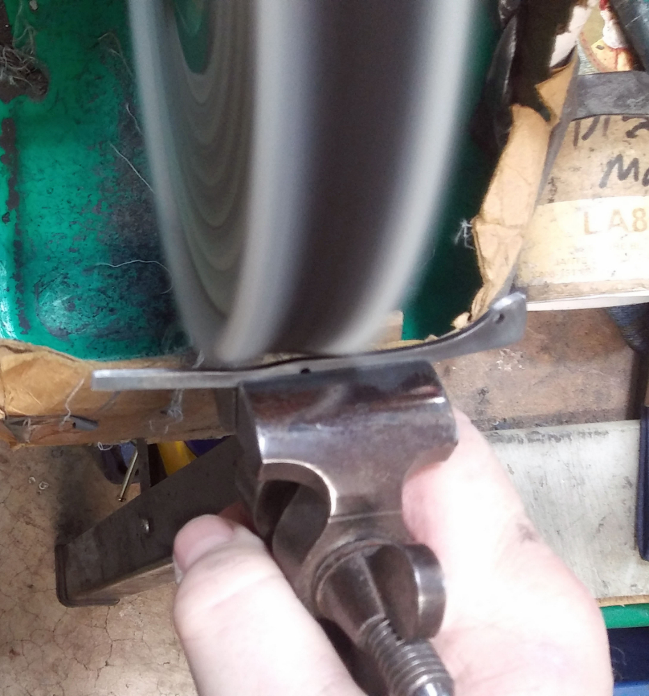

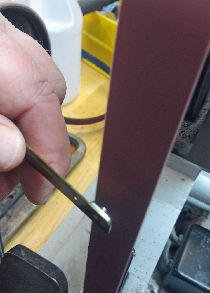

Grinding off rocker pin head

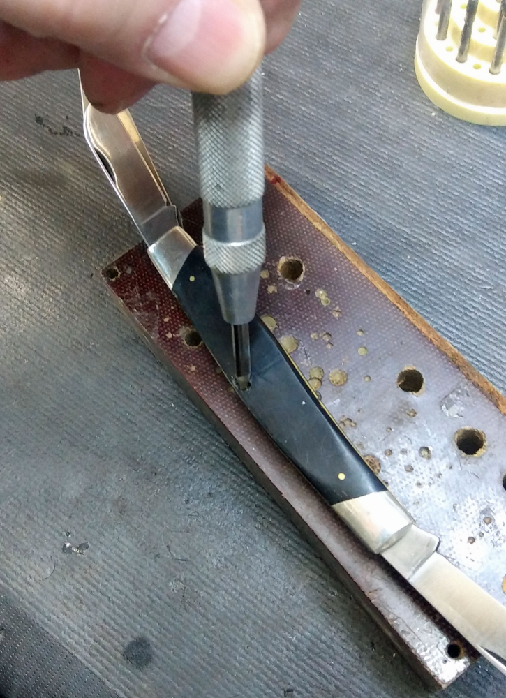

Knocking pin through frame w/ snap punch
Pin is out far enough to be removed with pliers
Pin removed & secondary spring taken out

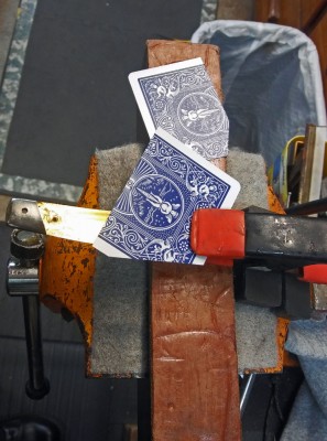

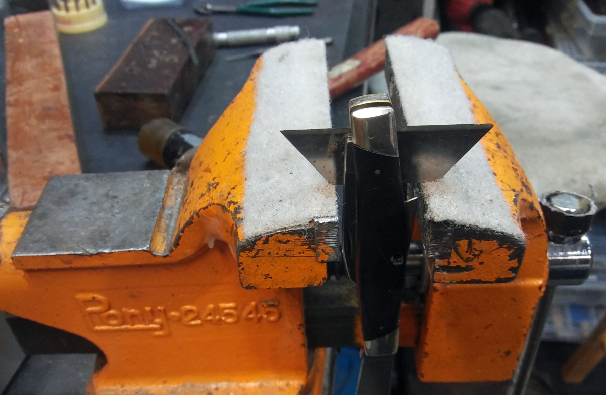

Ready to cut pivot pins
Drive razor blade through pin with soft face hammer

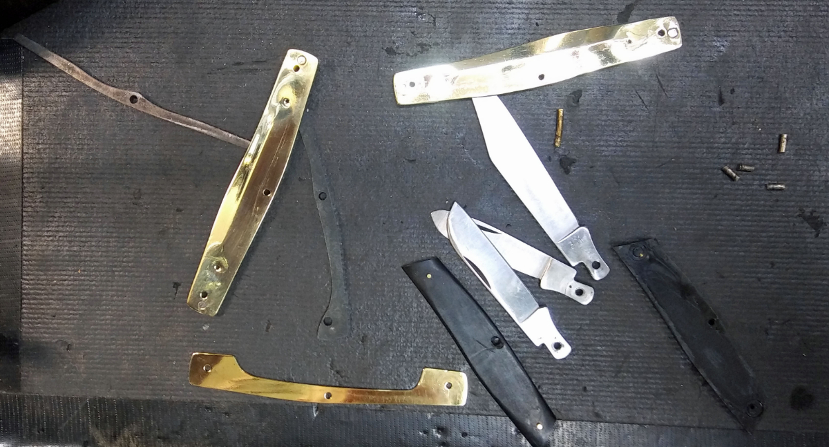

Knife in pieces
Knife in pieces

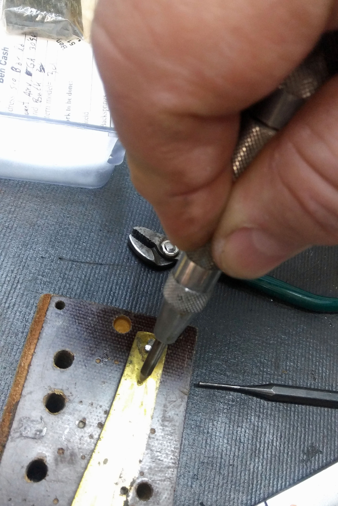

Knockout handle rivets with snap punch
Handle pin free from liner

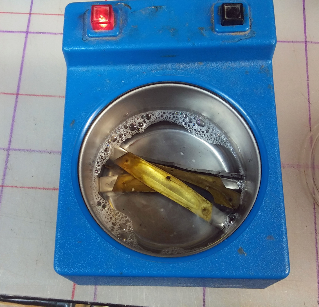

Parts in sonic cleaner

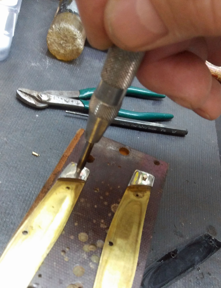

Bolster pins pushed out with snap punch

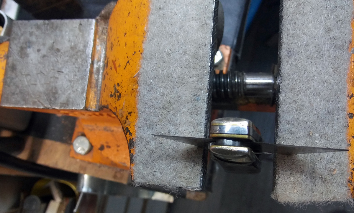

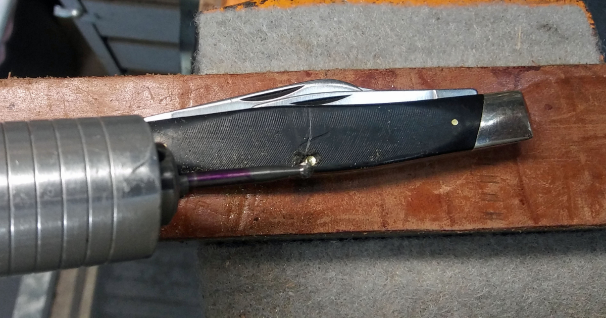

Grind heads off pivot pins
Not pivot pins out the inside with snap punch

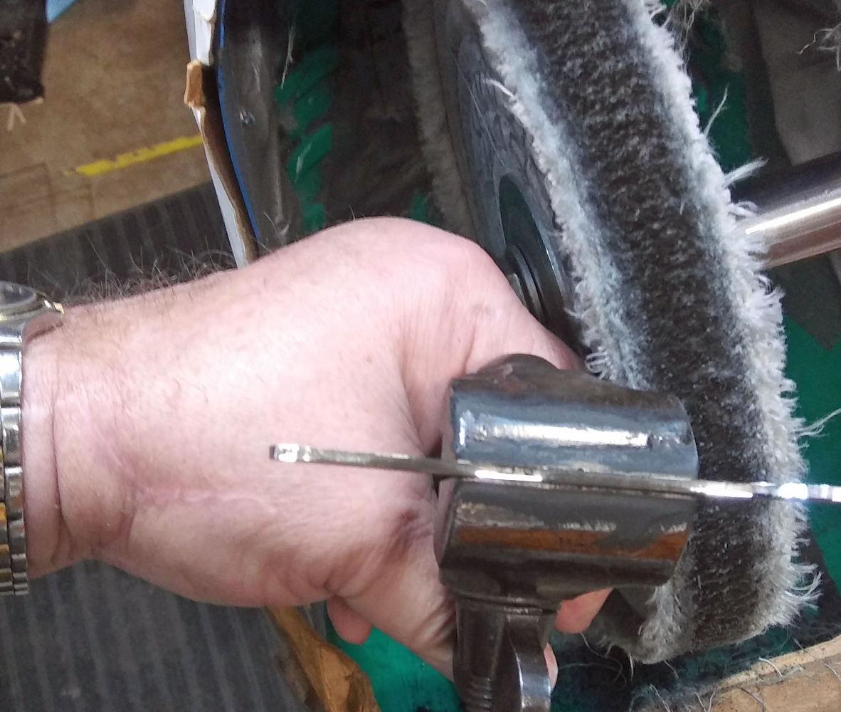

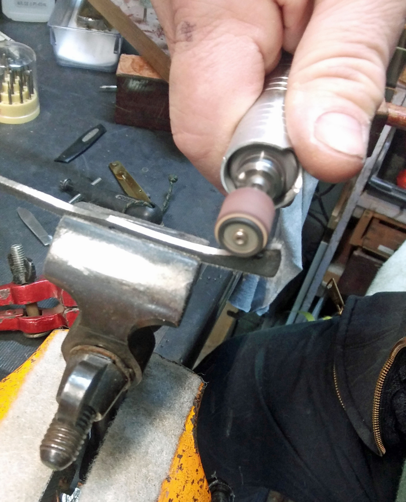

Polish the inside of the liners
Sam the inside surface of the Springs to smooth them before polishing
Polish thee inside surface of the backsprings

Spring polished and ready to wipe to remove compound

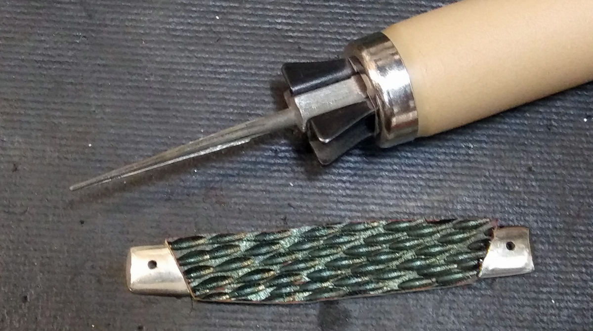

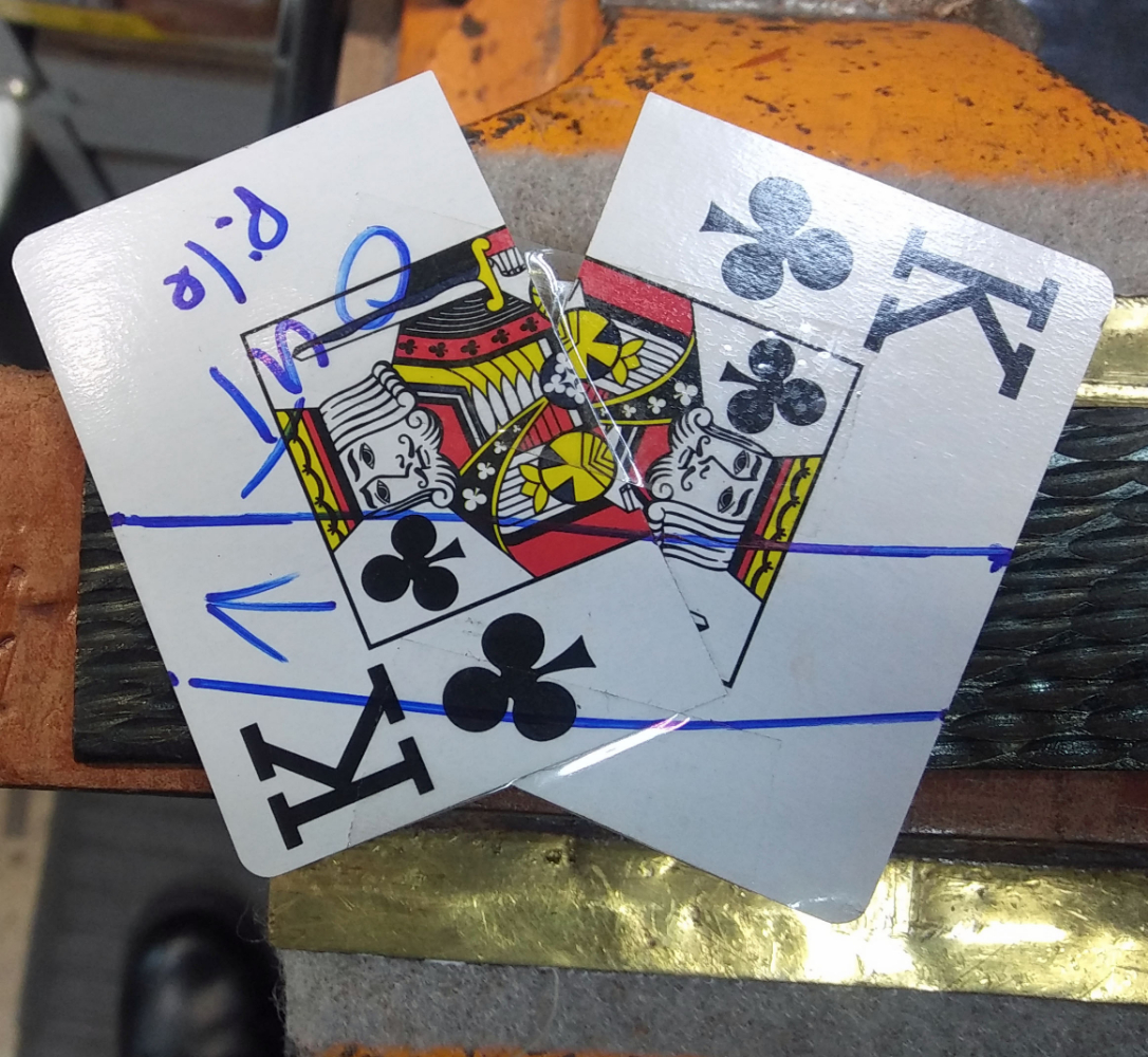

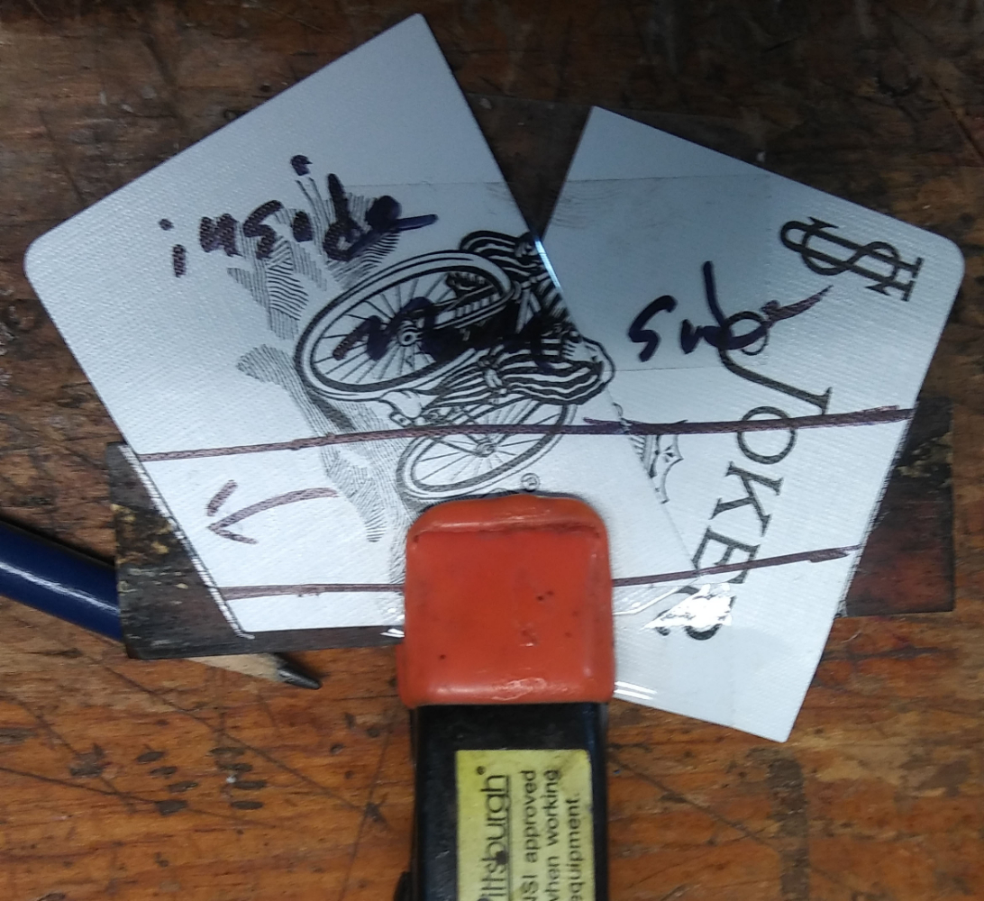

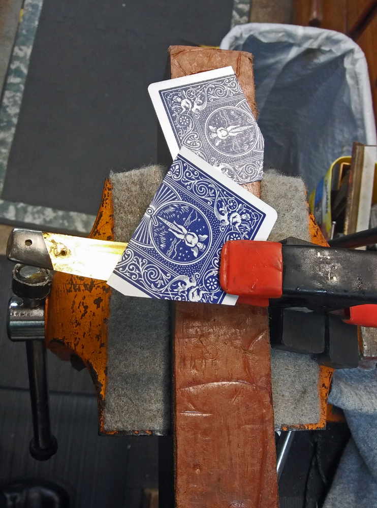

Making template for bolster angles
Template held against new handle to mark out angles

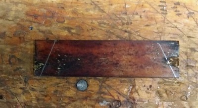

Template on the handle to layout cuts
Cut lines transferred to handle
Measuring templates against outside of handle. Note be sure to mark which is the inside of the template in which is the outside!

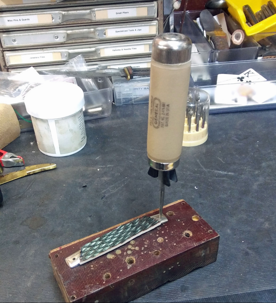

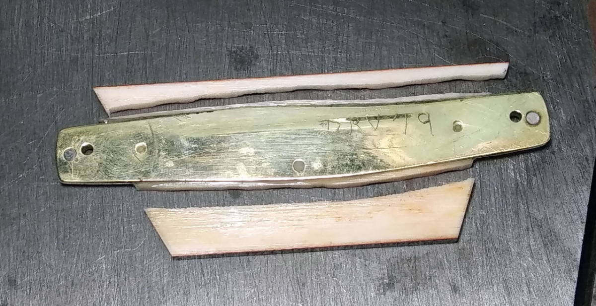

Bone glued to mark side handle and access cut off.
Tapering pivot pin holes with tapered reamer
Handle and tapered reamer

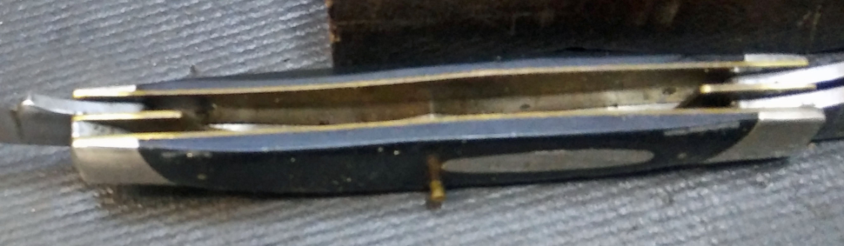

Test fitting pins mark side
Test fitting pins pile side

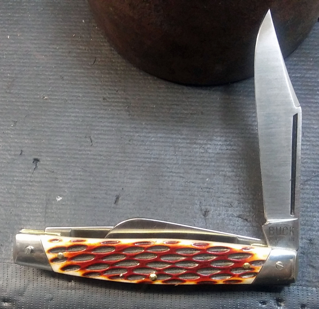

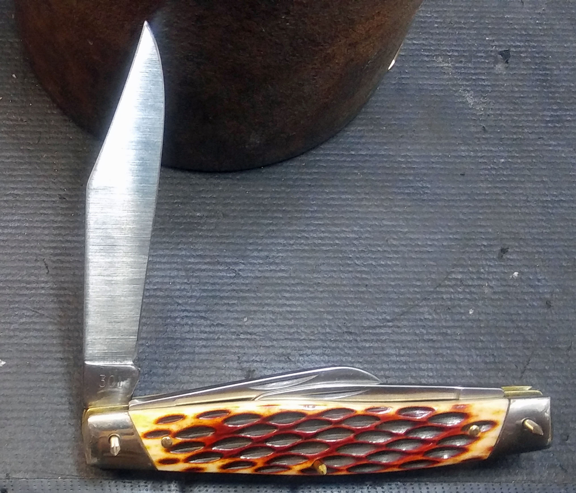

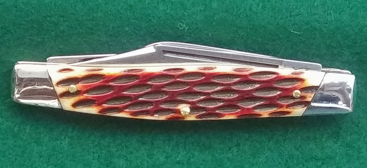

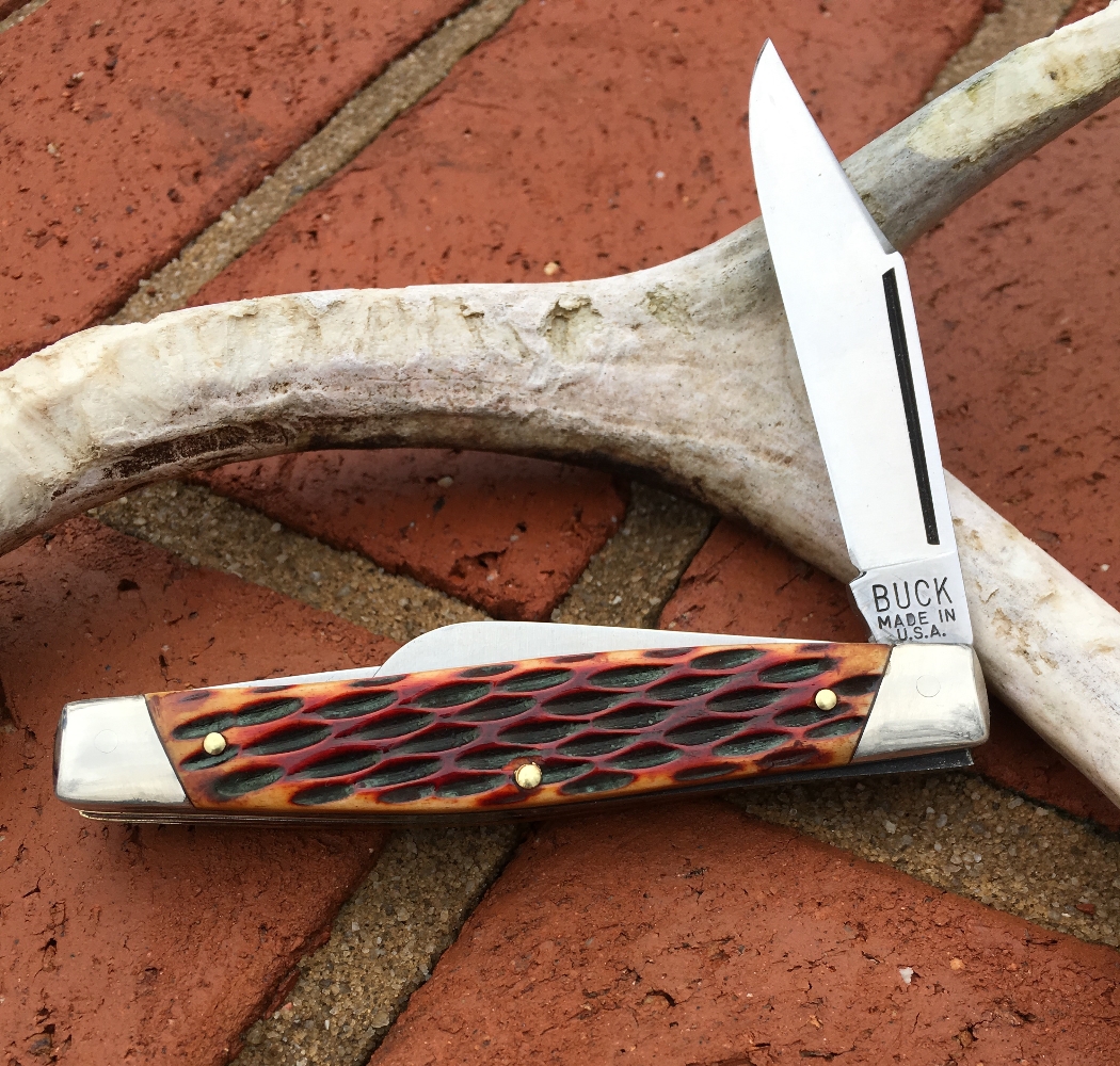

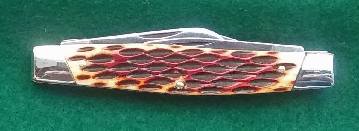

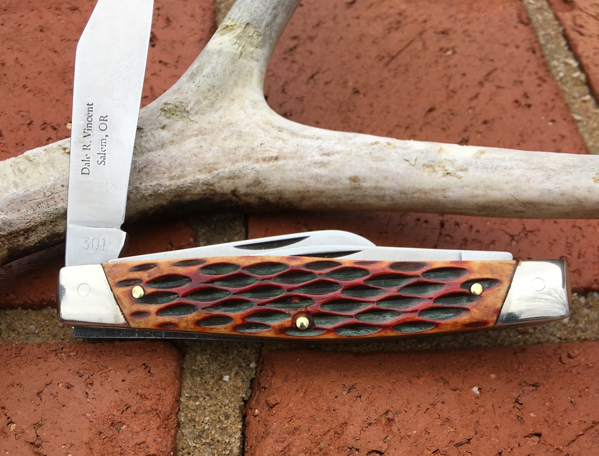

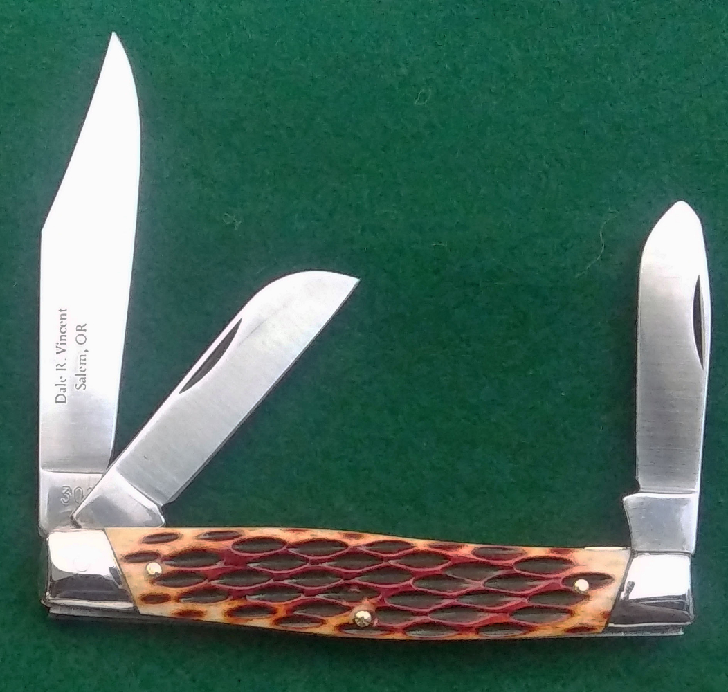

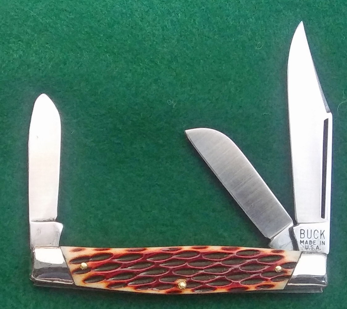

At this point I got pretty busy and forgot to take any more pictures.

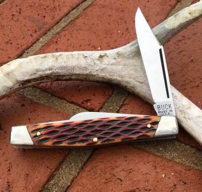

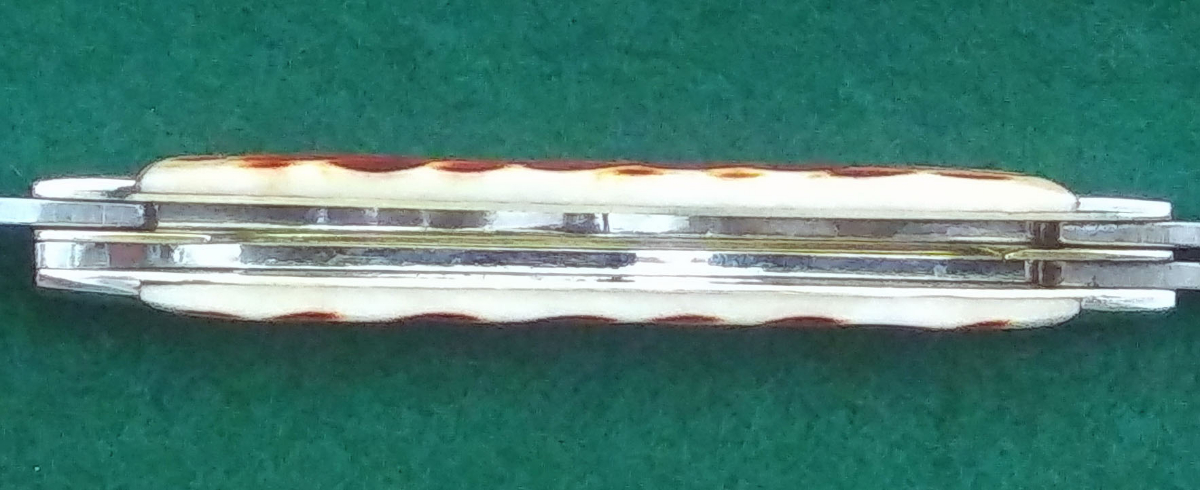

So these next pictures are the are what the knife looks like when I was finished and shipped it back to geocash.
I hope the steps are not too confusing. The whole process of taking pictures and posting them are pretty time-consuming it takes about four times as long to do the work and you've got several hours work at it in the pictures and labeling them. It's no wonder a lot of people just show the finished product not all the steps in between.
If you have questions about the process, I would be happy to answer your questions. I view this is kind of an aid for guys who are starting working on knives or who are thinking about in on knives. There wasn't anyone to ask when I started doing this. Someone said about one of my early pieces, "that kind of looks like Herman Williams work." I said "Who is Herman Williams?" When I found out who Herman Williams was and I compared his work against my early work; I realized how nice the person was being my early stuff did not at all compared to Herman's work!
I hope you enjoy enjoy the pictures.
I will try to answer any questions I can about the process.

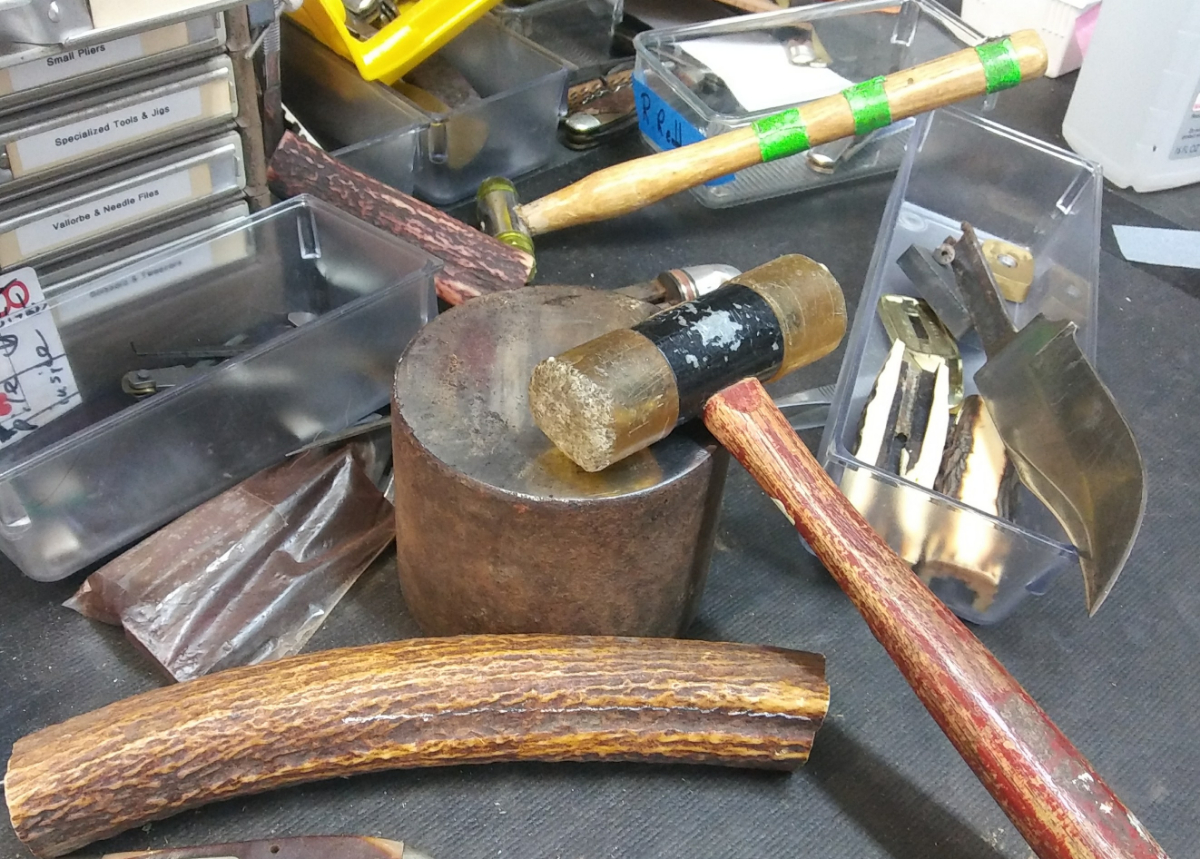

So...when you're cutting the pins, with the razor...you're actually hitting the end of the knife?

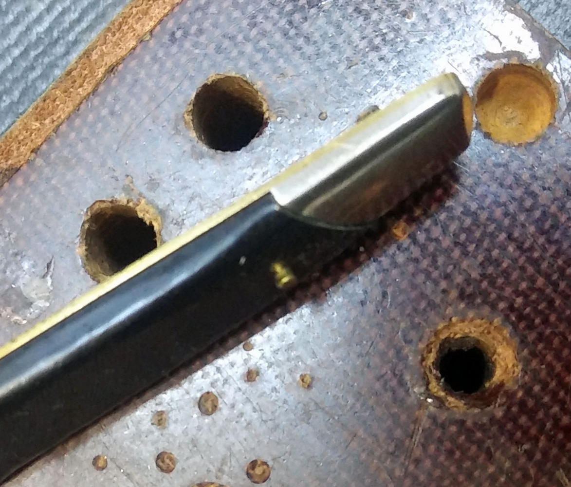

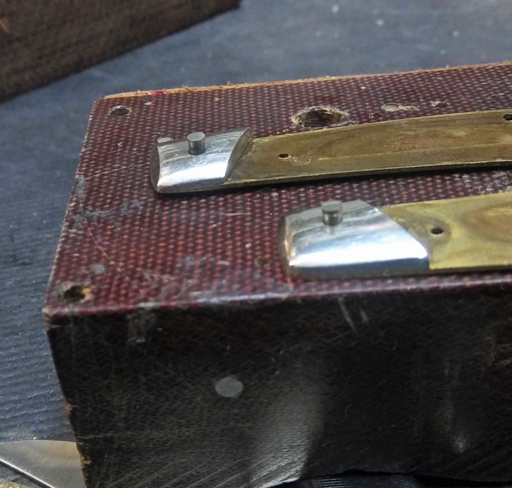

Yes, here is the hammer I use. As you can tell the end of the knife is considerably harder than the end of the hammer. I've been using the same hammer since I've started working on knives in 2005 or 2006. It was the only soft face hammer I had then and it's still doing the job.

In the one photo where you’re tapping out the pins on the handle, you have the knife laying on a block with some holes drilled in it. What is that block made of?
Hey … it’s a pocketknife for gosh sakes. I’m not selling the Mona Lisa….Bullitt4001

Post by orvet »
That is a block of micarta. I use it because the micarta is softer than nickel silver so it does not mar the knife.
I also use micarta to build jigs around the shop, it is quite useful!

So do those tapered readers come in different sizes? And do you remember where you got that one from?
https://www.jfinamoreknives.com
http://www.secondlifeknives.com
orvet
Posts: 19906
Re: New Bone Handles for Buck 301
Post by orvet »
They do coming in different sizesl
I prefer to have one that will go down to about .050 and up to .180.
The actual reamer is the piece that is held by the handle, and the handle was purchased separately. I got both from eBay.

geocash
Posts: 1980
Post by geocash »
This was my father's knife, until 2005, which means something to me. I think it was made by Camillus & I like that. I just got it back yesterday & I really appreciate the work Dale did. Seeing my knife inside & out & what he did is an unexpected privilege. I understand why it looks & feels like new. And Dale's mark on the master blade is another trigger to help me recall some of these things when I carry it. (I found the antler yesterday, too, at the edge of my yard.
