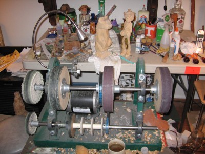

Burke's Law ::tu::
This from a previous thread back in 2008.
http://www.allaboutpocketknives.com/kni ... f=4&t=8936
Burke Sharpener.jpg (45.53 KiB) Viewed 5645 times
Laissez Les Bon Temps Roulez
Daryl
