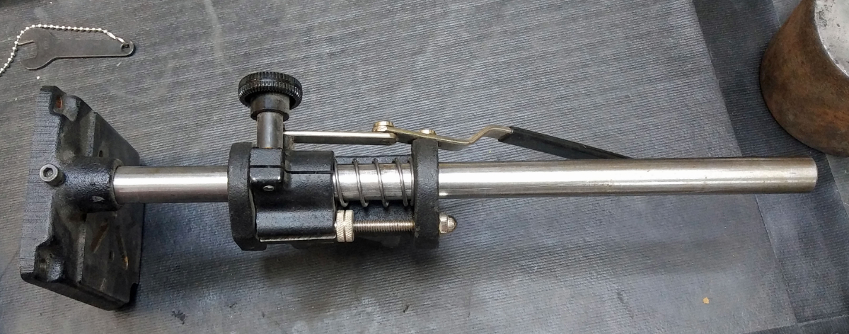

Going by the old adage “A picture is worth 1000 words,” I decided to make this tutorial mostly about pictures. There are about 18 pictures total so in the first post I will post pictures of the Foredom drill press.
This is not a tutorial about inlaying shields but about some of the tools that I use when I inlay them.
The first four pictures show the drill press laying on my workbench with fuse from front and rear, and both sides.
These are really out of sequence but the next three pictures are the three different types of Foredom handpieces I have.
I use the #30 the most, in fact I have two of them and those are most always on both of my Foredom’s unless I’m using one of the other handpieces for a specific purpose.
The #44T grips the shaft of the bur through the use of collets, it comes with three sizes, the largest is ¼", the middle is 1/8” and the smallest collet is 3/32”. I have used this quite effectively with all three sizes, but I normally leave it set up with one of the small burs I used for cleaning up a shield inlay, such as the one I have and it now.
The #50 Foredom handpiece is the reciprocating handpiece, which is used frequently by jewelers to texture metals like gold. I use this handpiece infrequently but I use it when I have difficulty peening a handle pin for whatever reason. Obviously this is done when the knife is apart and a handle pin just does not seem to want to peen down on the inside. You can’t leave it domed because it will usually rub the tang so I it has to be flattened. If I am using brittle handle material such as used bone I will gently use the reciprocating handpiece to peen down the handle pins without having to hammer on a pin in a fragile handle.
Pictures 8, 9 & 10 show the Foredom drill press set up ready to use with the #44T handpiece. In the next post I will show a sample knife, grabbed off my workbench, in the contour vise I usually use when inlaying shields.
