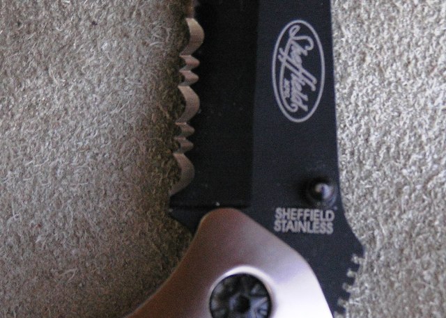

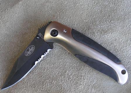

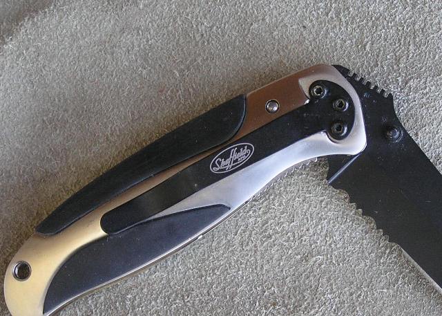

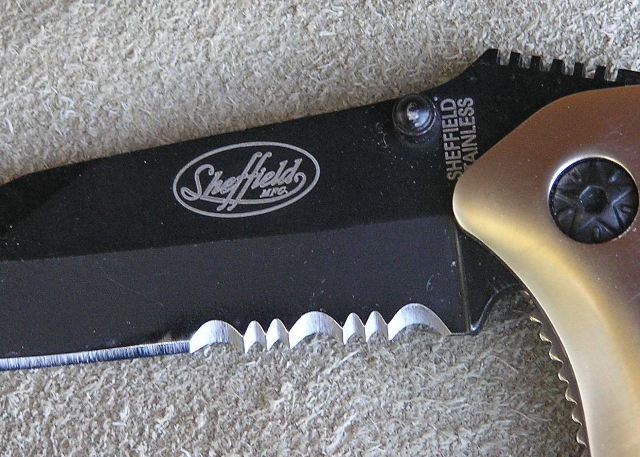

I know guys that have been hurt- SERIOUSLY. No need to have a high speed buffer, I'll take a workhorse 1 HP 10 inch with a 1725 RPM rating any day. Those 3600 RPM guys will shred the buff's in a hurry, especially loose muslin. I never use high speed on a blade, loose mulim can catch on the blade and throw it - WHO knows where, I have seen blades sticking out of the ceiling, I think I posted that picture. The Buffer is THE MOST DANGEROUS TOOL in the shop.
Keep a good patina, it protects the knife. If you want shiney use 420 HC SS, I have started to hate the stuff these days. Other stainless steels work well, Hard to find 420 HC SS - comes in HUGE ROLLS.
I prefer 440C or good old 154CM, which will eat a hacksaw blade before you cut 1/2 way through an 1.5 inch x 5/32 bar.
I have no desire to keep a good shine on a user, a collectable or desk queen is different.
Here is a good one to stay away from: the Sheffield MFG company of China. Here are some rotten pictures of a Chinese knife trying to pass itself as a Genuine Sheffield.
Watch out, the name is there to confuse you DELIBERATELY! SHEFFIELD MFG of China!
Soft aluminum frame, but I bought it to take apart and incororate ONE idea in an upcominf project.
Soft Aluminum frame with neoprene. The frame will scatch like crazy - BUT the neoprene will need to be upgraded - this stuff is the old stuff they used in the 60's.
