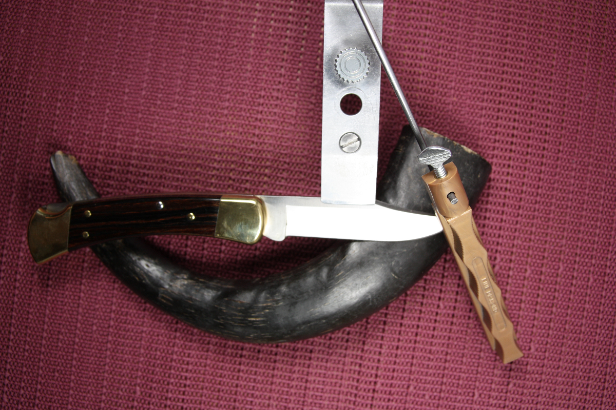

I’ll start ....
- put a little piece of blue painters tape on the top edge of the knife where it mounts in the jig to prevent those annoying tell tale Lansky scratches.
- watch the inside of your right hand - if you slip, the blade tip is very close to the inside of your wrist
- I have tried all 4 sharpening angles & have settled on using the top hole (30 degrees). It seems to work perfectly for all of my slip joints ... and the best part is I always know which angle to use regardless of what knife I’m re-sharpening
- the standard stones dish out from wear over time - but the diamond stones always stay flat as the diamond sharpening media is bonded to a steel plate. It’s worth it to me to pony up for the diamond set
- I’ve Found the single most important part of the Lansky system is to buy the mounting base so it’s stable - trying to freehand that Lansky clamp is actually quite dangerous.

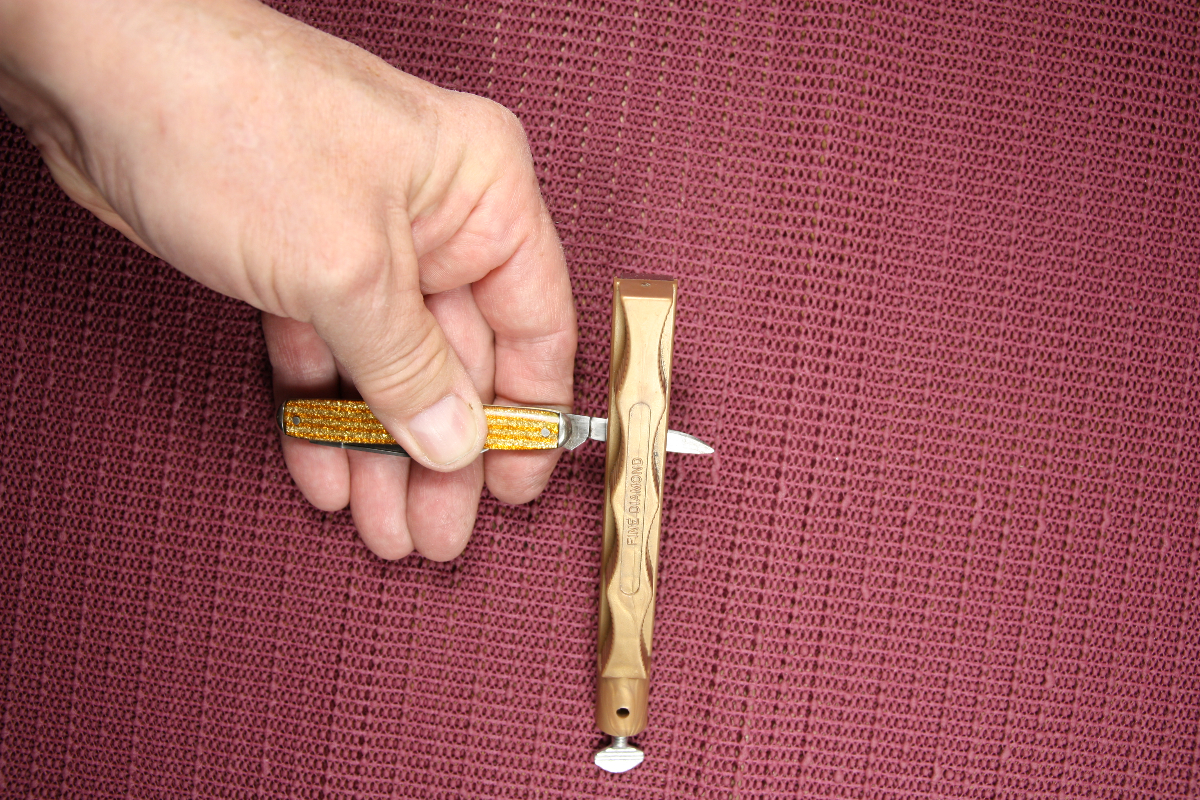

I don't use the clamp on small blades, such as small pen blades and the pen blades on whittlers. Just hold the knife with the blade open, point away from you, and cutting edge facing up, hand resting on a table, then take the Lansky stone (or actually any stone will do this), try to duplicated the angle that the Lansky uses, and just rock the stone back and forth, towards and away from you. Small pens usually don't take much to sharpen them unless they have been badly abused.313 Mike wrote:How do you get the system to work with small narrow slipjoint blades? The stones always rub on the clamps for me, and if I put the clamp just on the very edge it wont hold the blade securely

That’s the practical limit of the Lansky system - it won’t work with the really little blades. I guess it just depends what kind of knives you like - I don’t have many mini stockmans or little pen knives, so it doesn’t bother me & I do my best to freehand sharpen those ...Colonel26 wrote:That’s exactly the problem I have with them.313 Mike wrote:How do you get the system to work with small narrow slipjoint blades? The stones always rub on the clamps for me, and if I put the clamp just on the very edge it wont hold the blade securely

Those of you who mentioned that the Lansky is not perfect are all correct. But for the bulk of pocket knife sharpening it works good enough. The very largest blades are a problem as are the very smallest. This topic is suffering from a lack of pictures to show different setups, so I spent some time to try to get something to show. Not that easy to get things setup to see the angles.
If you put the blade clamp on in different places, this will affect the angle somewhat. As shown below, if the clamp is too far back toward the handle, more metal seems to be ground unnecessarily from the tip. Shown on a Buck 110 for example I usually put the clamp on more toward the center or even more towards the tip to avoid this. When sharpening small pen blades, the stones can actually rub on the clamp, so I don't use the clamp for small blades. I hold the knife as shown with the hand resting on the table and using just the Lansky stone (fine diamond shown) without the guide rod, with the bottom end resting on the table. I try to approximate 25 degrees blade to stone angle while doing this. Just rock the top end of the stone back and forth towards and away from the tip. Turn over and do the other side. Small pen blades usually don't need that much to sharpen, and this method has worked for me.

Great tips - I mount the clamp on a clip blade in about the same spot as you do. I like your idea about sharpening little blades with Lansky stones freehand - I will most def try that.OLDE CUTLER wrote:Those of you who mentioned that the Lansky is not perfect are all correct. But for the bulk of pocket knife sharpening it works good enough. The very largest blades are a problem as are the very smallest. This topic is suffering from a lack of pictures to show different setups, so I spent some time to try to get something to show. Not that easy to get things setup to see the angles.
