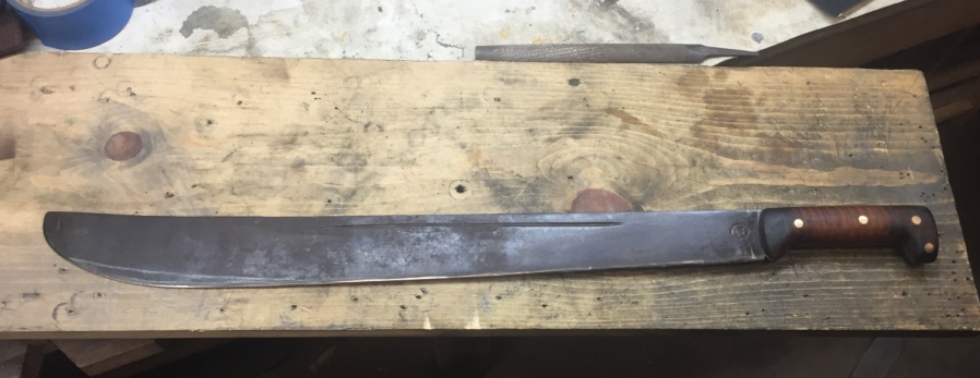

I had just finished putting a set of handles on this old machete I got from the junk store..... These scales are from an old board a friend found at the dump. (tiger maple)

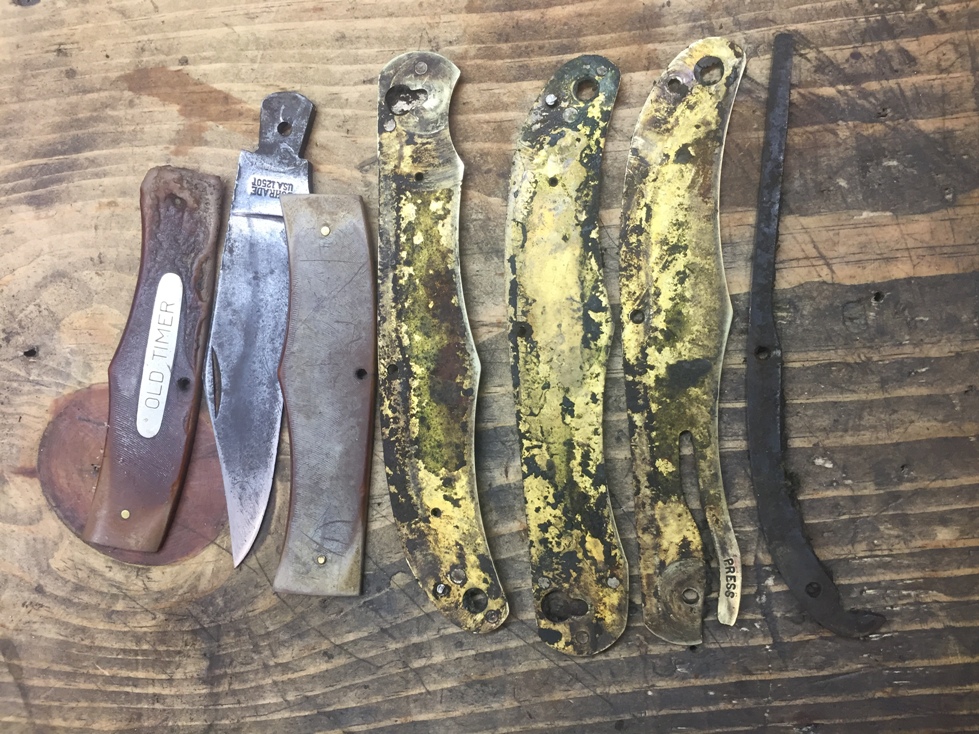

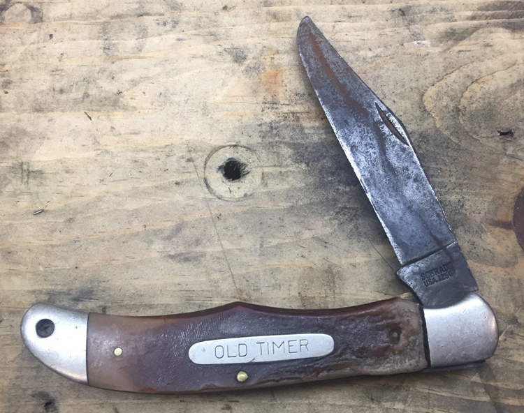

I looked down in my "dead knife box" and I saw this Old Timer 125OT I picked up at the junk store. What a mess. Then a thought crossed my mind, Why not put some stag (dog chew) handles on it. Why not?

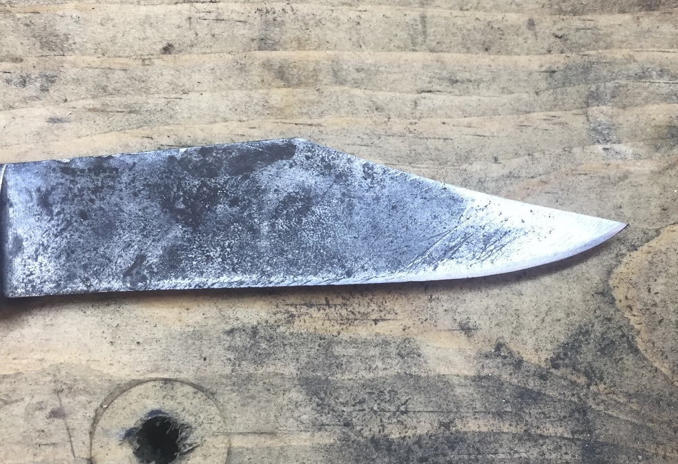

The handles on this knife looked like they had been torched. The blade tip had been broken off and poorly re-tipped.
After dis-assembly, I took a good look at it. The liner lock had been wrecked. The blade had been hammered on to drive it into something like a wedge.
First, I re-tipped the blade.....

SO....While the parts were sitting there looking back at me,

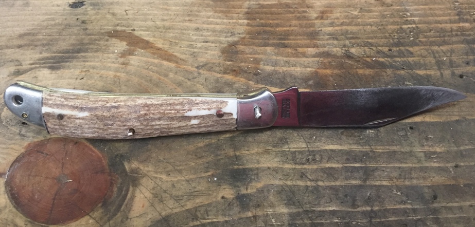

I got this idea. Just leave out the liner lock..... OK... why not? So I commenced to cut myself a set of scales out of a dog chew that my dogs were never gonna get a chance at. I had a better use for that chew. I cut the scales out and while I was mocking up my new creation, I decided to re-shape the handle. Before I could stop myself, this was the result.
I still need to do some finish work on the bolsters and finish shaping up the handle to please my grip. I also need to finish the pinning and working down the profile of the new scales. It sure don't look much like a 125OT anymore, but I figure it might be a good user. It has some great snap. It might be a few days before I get a chance to put the finishing touches on it. I will post a finished pic later.
Sorry if I blasphemed the Old Timer folks but this one sure was a sad old knife just sitting in my junk box. I figure I just made it useful again. A bit in disguise but still a good useful knife.

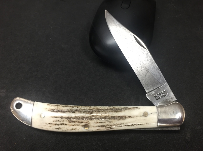

UPDATE....

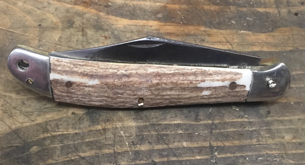

I got a chance to get out to the shop yesterday. I did some filing and sanding to get closer to a finished knife. After I did some polishing to see what else I needed to do, my mistakes really started to stand out.
I hammered the right end scale pins and cracked the scales.... on both sides.....CRAP.
I also didn't get the hole in the bolster exactly round. I think it moved when I was drilling and the hole was a bit oblong. You an see a little moon just in front of the pin. I need to get myself a better procedure for drilling. My spring clamps aren't making it.
Well, the more I do the more I learn. This was another learning experience for me. I think I am going to stain the scales and do a little bit of an "antiquing" experiment before I call this one done.
Before.....
After.......

Sharpnshinyknives wrote:Mike we are always hardest on ourselves than anyone else would be. It looks amazing. I’m following this thread because I have a project or two to start on and haven’t attempted this yet. I am curious, how does one flatten those pins in the handle and the bolster w/out damaging the knife? I have watched a few YouTube videos on knife making and so far they skip right over that part, like it’s so easy that they don’t need to cover it. If someone has a suggestion on what to watch or instructions on this, I would appreciate being pointed in the right direction.
I like what you did w/ that knife. It’s funny that you used an antler for a dog. I have 3 of those in the house and every time I pick them up, I can’t help but think what a great knife handle these would make, they are beautiful stag. I wonder how many others have bought those to make knives out of them?
Mark
Good morning Mark....
The one thing I have learned from the other sure 'nuff experts here is this...... When you put the pin in the scales, you hammer the pin and expand it in the hole. The hole in the scale needs to be really close to the size of the pin so it won't take a lot of expanding to make the pin grip. On the liner side, I took a counter-sink and drilled a "cone" in the liner so I could make the pin hold the liner better. I hope you can follow what I am saying since I don't have pictures.
NOW, my problem with this one was to go too far with expanding the pin. With the pin that close to the edge, too much expansion makes the pin like a wedge and it cracked the scale just like a wedge in a piece of fire wood.
Maybe some of the other guys will chime in and give other suggestions. Maybe a little glue in the hole before you start to hammer the pin will help hold the scale to the pin (?).
One thing about the dog chew..... I think you can get cheaper (and maybe better) pieces of antler from the knife supply folks. The piece I used was supposed be for my dog. I just figured it was more useful as a knife scale.....LOL.
