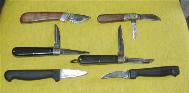

I was glad that Kaleb started this topic. Here is some old "stuff" that I can use and abuse as much as I need to and won't be out anything. I got all of these out of a friend's trash box. He was going to toss them because of broken blades. Now, I'm not as artistic as Kaleb and I only ground off enough to make them usable. Maybe Dale will like the wharncliffe blades.
top lt.- 1560T Schrade rt.- Schrade barlow
Middle- lt Camco rt- Camillus
bottom 2, junk, stainless paring knives. "SCARY" sharp.
The Schrades also had broken handles, so I slapped some Oak on them.
The Screwdriver blades make GREAT knife blades. The steel seems to be as hard or maybe harder than the knife blades.
I know...BOOOO-RING! ::yawn::
Kinda fun fixin' 'em...
...Mild(not wild)CCBill...

Bill, I like those screwdriver regrinds I have a ton of them in the parts bin out in the garage. I have one partly reground into a wharnecliffe, just need to get the bevels refined with a fine belt.

I too have been looking at all the screwdriver blades....just haven't found the right shape to use yet....
