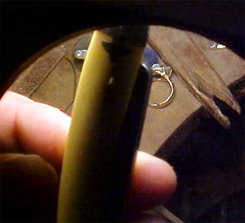

Glass Test with Ivory
Hey Blade Runner
Is this what to look for?
The handle is Convex as is the glass. Where the green dot(s) are, is where it touches.
I never have got it to work under flat glass yet. Does type of lighting make a difference?
I will able to move one of my smaller case's outside over the week-end to try it outside.
Thanks for the info,
9ball
9ball

Hey 9 ball good to hear from you. I don't know that much about the test. I only saw it done once, but it worked that time. You'll just have to make sure you have genuine ivory and then experiment with it. Let me know how it goes, because I don't have anything handled in ivory. After looking again I think I can see the green dots in your pictures.

I dug out an ivory handled knife today and tried it. I saw a similar effect as shown in 9ball's image. I kind of rolled it around on the bottom surface of the glass and the streak/dot looking areas showed up in various locations. They kind of showed up sporadically. Kind of weird... Whatever it was that showed through looked like it was for sure a characteristic that was part of the handle scales. I haven't tried it on any imitation ivory or any other materials yet.

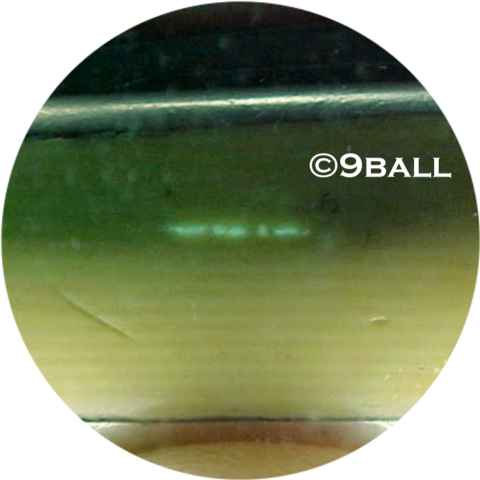

I finally dug out a straight razor with a celluloid handle.
Can you see the green spot? It is kinda hard to hold a sharp razor and take a picture at the same time.
It also produced a green spot on a horn Jack knife I have and a couple of different cream colored celluloid razors I stuck under there.

9ball's test of the celluloid does not look like a good sign that it works. I tried it with a celluloid knife that is a bit more yellow in color than ivory. I did not get the same affect as ivory... no affect whatsoever actually.
Maybe I have majic glass... Anyone want to buy some majic glass?
My kitchen table is thick glass. That is what I've been using. I'm getting some real interesting results. I wish I could some how show you. A picture doesn't do it justice. The handles are rounded, and when the they are rocked back and forth, it kind of looks like lightening or something because lines kind of streak accross in a pattern... if that makes sense...
