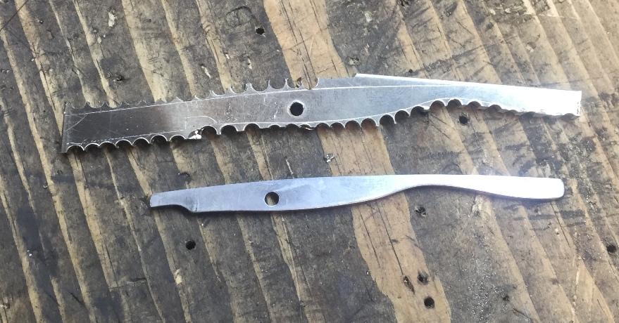

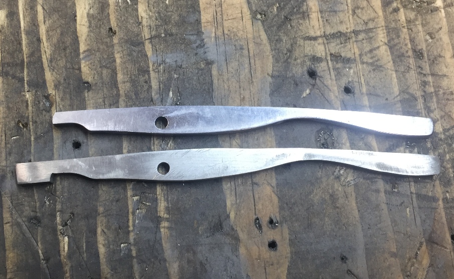

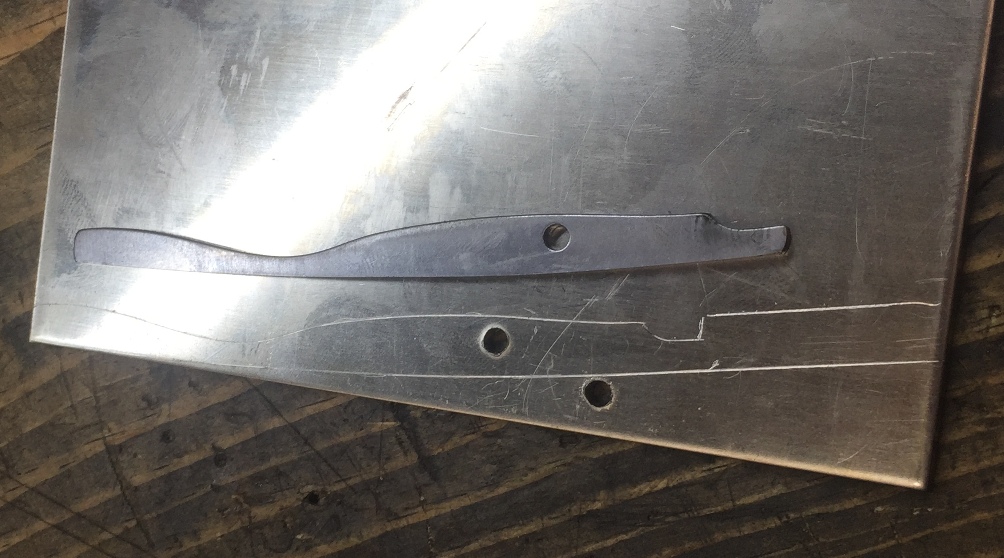

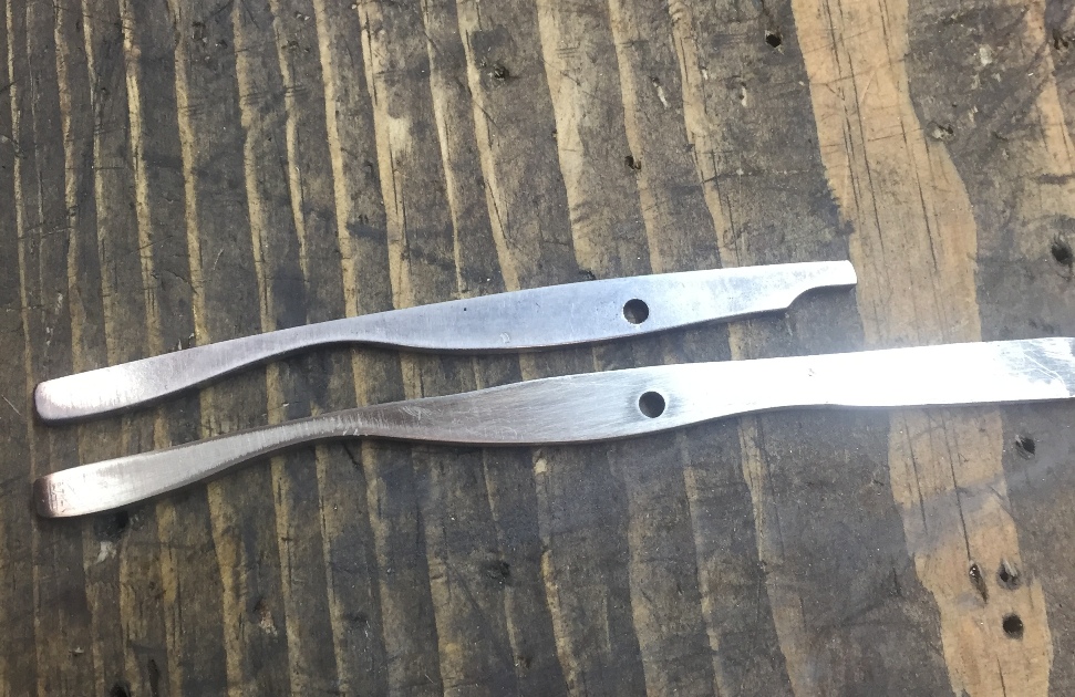

Here is the before... as found..... Here is where the lever was broken.... SO first, I got out my sheet of stainless and dang if it wasn't almost the same size as the broken lever. I started by drilling an indexing hole and then scribed the shape of the lever with some extra for the broken off piece. I hate trying to cut this stuff so I drilled a BUNCH of holes close to the edge and the cut between the holes with a hacksaw. Here is the roughed out piece.... LOL..... spikey isn't it.... I used my sander to get the new piece as close as I could with the new area as a blank. Then I had to start filing and fitting to make the lock area fit the blade. I did finally get the lever to fit and working like it should. This took several trial fits to finally get the lever like I wanted it. Then came the clean-up. Here is the final result. I was pleased with the final result. I just gave it to the owner and he was pleased too. I told him "no charge" since it was a learning experience for me. He said he was going to pass it on to his son when he got old old enough for a knife...... Did my heart good to hear that. Mike

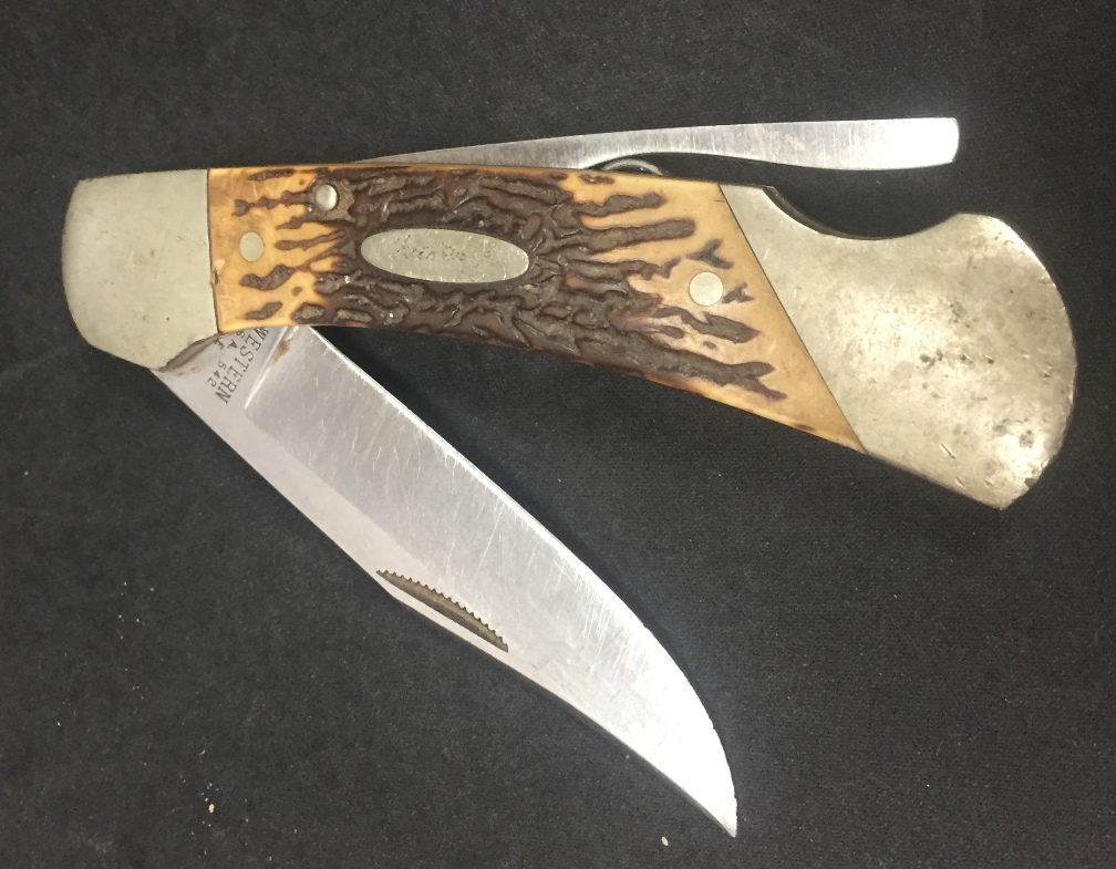

A guy that works in the shop where I work found a Western 542 in a ditch while walking. He knew I was a knife nut and liked to work on knives. (I ONLY like to work on my own...... I have a phobia of screwing up someone else's things).... ANYWAY... he ask if I would try to fix it. I have another fault.... I have a hard time saying NO.... Anyway... I told him I would give it a try.

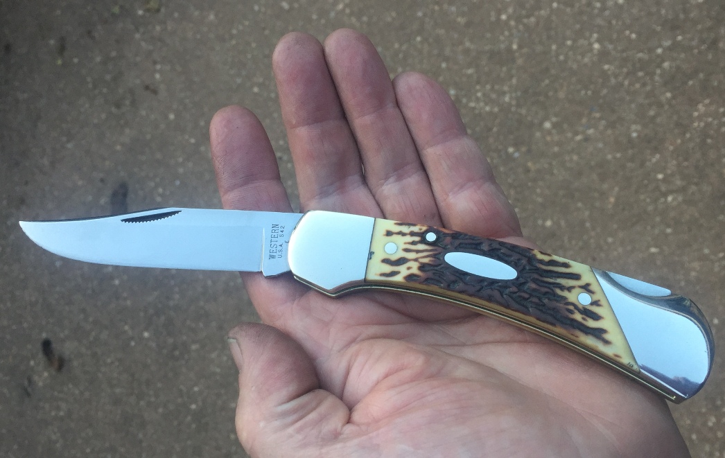

Thanks Dale.... It was a good exercise for me and YES.... I am glad that knife will live on as a family keep sake.

It sure was a good learning experience for me. I have learned so much about the construction of pocket knives by just being a member of this forum and learning from y'all. The biggest step for me is always digging in and taking a knife apart. But y'all have given me confidence. Thanks to everyone!

That is nice but I'm very curious as to why you didn't have to heat treat it? When I cut a spring from strip steel it has to be heat treated. Does SS not have to be heat treated? When I need a spring I usually look in the junk box first and try to find something close. Heat treating steel isn't hard but it can go bad on you and the spring snap like a pretzel. It saves time to try and rework an existing spring.

I am so glad I read this thread. That repair job is fantastic. You have given me a great idea. I never thought about drilling the stainless and cutting w/ a hacksaw. I don’t have a whole lot of machines that you do this with, but I do have a drill and a hacksaw. Inspired. Thank you so much.

The lockbar on a knife like this western or a buck 110 or schrade lb7 doesn't HAVE to be tempered (although it's preferable that it is) because it's not actually flexing, it's just the lock. The small spring steel rod in the butt end of the knife it was actually flexes.just bob wrote:That is nice but I'm very curious as to why you didn't have to heat treat it? When I cut a spring from strip steel it has to be heat treated. Does SS not have to be heat treated? When I need a spring I usually look in the junk box first and try to find something close. Heat treating steel isn't hard but it can go bad on you and the spring snap like a pretzel. It saves time to try and rework an existing spring.

That makes a lot of sense. I should have considered that. One other question I have is on the drilling of SS. That isn't easy to do. You can go through a lot of drill bits in a hurry. Did you slow the speed down on the drill press or did you use special bits to get all of those holes drilled?

Well... to answer that question.... I have a friend who supplies me with drill bits. He has a way of getting drill bits (from a certain business) that fail to meet certain requirements (length, diameter maybe???, I don't know).... I don't look this gift horse in the mouth. Anyway, I will dull a bit and then I make it into a tool like a punch or scribe. These bits are really nice (government) ones too. I have many plastic bags of these bits so dulling a bit isn't a problem. I might use 4 or 5 but that's OK. Yes, and I did slow down the press and used cutting oil to boot.just bob wrote:
Back to the bits.... I have some that are tiny diameter and 6 to 8 inches long.....LOL. Hard to use at that length so I usually cut them down shorter.
