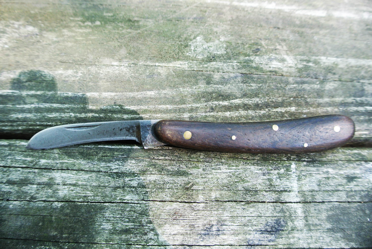

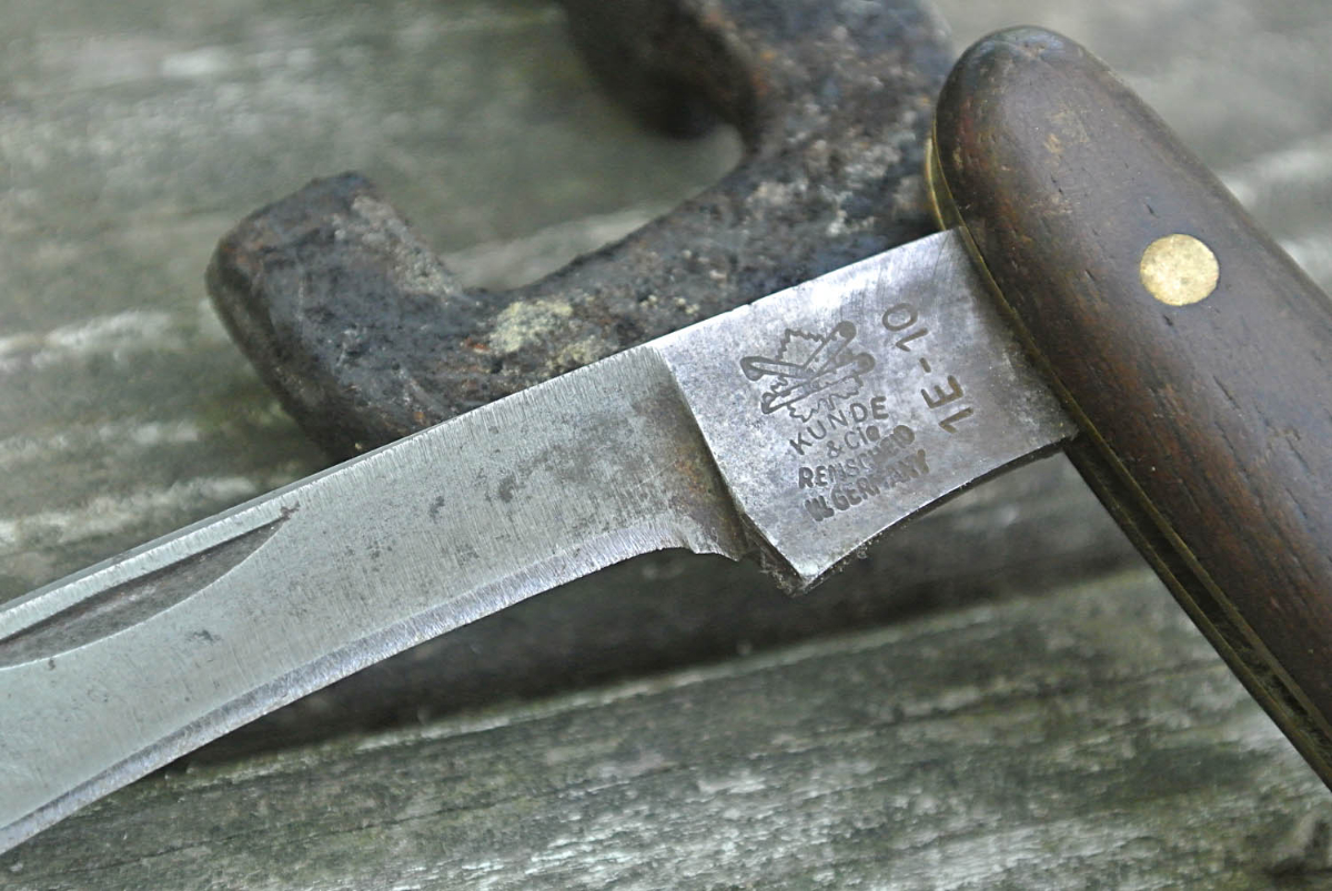

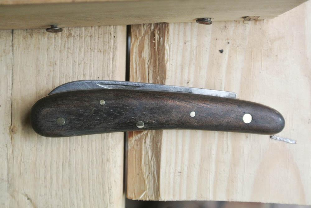

Kunde pruner/folder blade tip exposed when closed; not closing fully

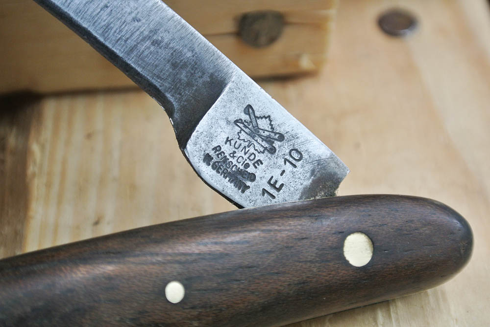

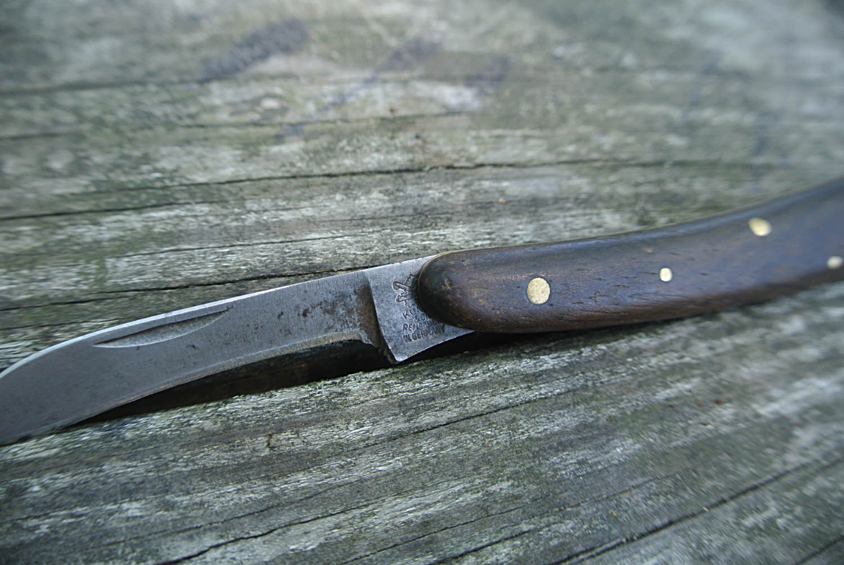

So, this beautiful thing appeared in the mail today .... And it is, except it doesn't close fully. A hard stop in the position you see.
Any thoughts? My theory, which seems unlikely, is that the tang is not formed right / is too large. ... there is a lot of fiction when you close it and open, and you can see where the friction and worn on some spots .... Any thoughts?
- edge213
- Posts: 8486
Re: Kunde pruner/folder blade tip exposed when closed; not closing fully
A lot of blade loss.
File down the kick and it should close.
Just go slowly.
Just go slowly.
- YuriRealman
- Posts: 34
- Joined: Thu Jun 07, 2018 8:54 pm
Holy crap. For real? That much blade loss?edge213 wrote:A lot of blade loss.
Just go slowly.
What do you mean "the kick?"
And thanks for your help!
- muskrat man
- Posts: 5684
- Location: Ohio

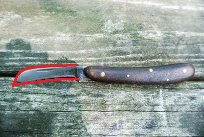

original blade profile probably looked something like this. points often get rounded off from lots of or incorrect sharpeningYuriRealman wrote:Holy crap. For real? That much blade loss?edge213 wrote:A lot of blade loss.
Just go slowly.

- YuriRealman
- Posts: 34
Gotcha, thanks. I'll try this and report back ...

Thanks Muskrat Man. I don't know how to show that like you did from my tablet.muskrat man wrote:original blade profile probably looked something like this. points often get rounded off from lots of or incorrect sharpeningYuriRealman wrote:Holy crap. For real? That much blade loss?edge213 wrote:A lot of blade loss.
Just go slowly.

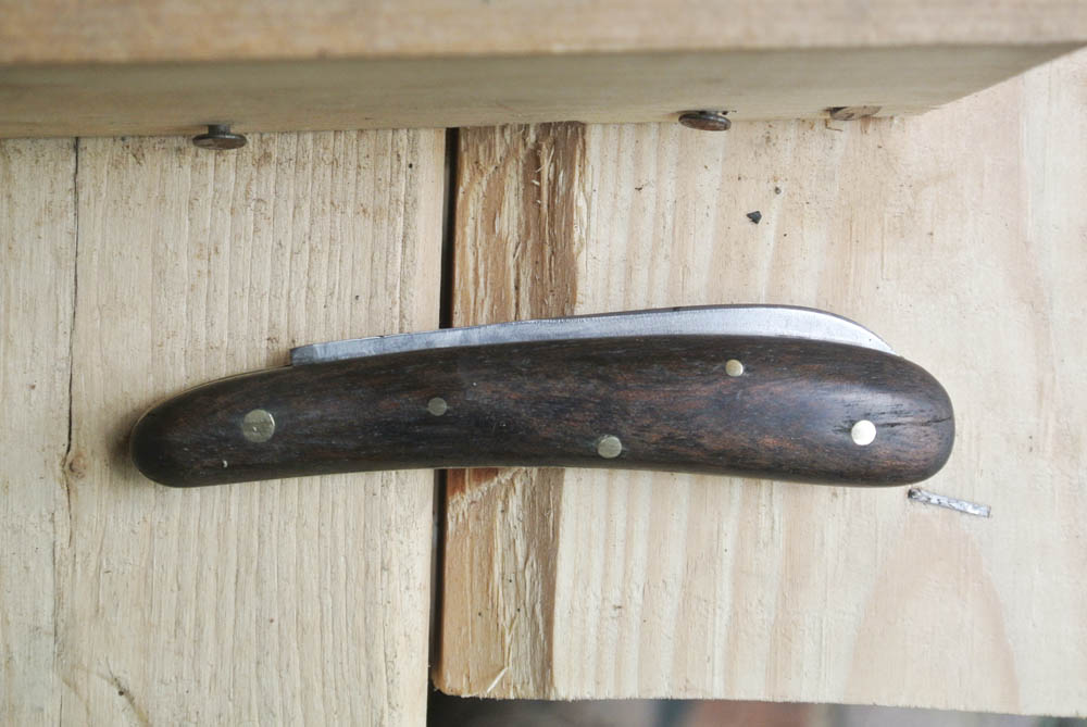

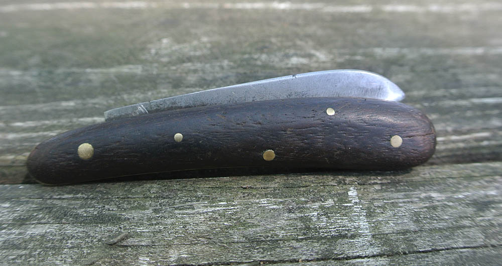

Really didn't have to take off much at all. Here's the start:

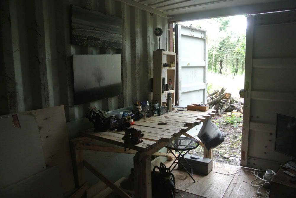

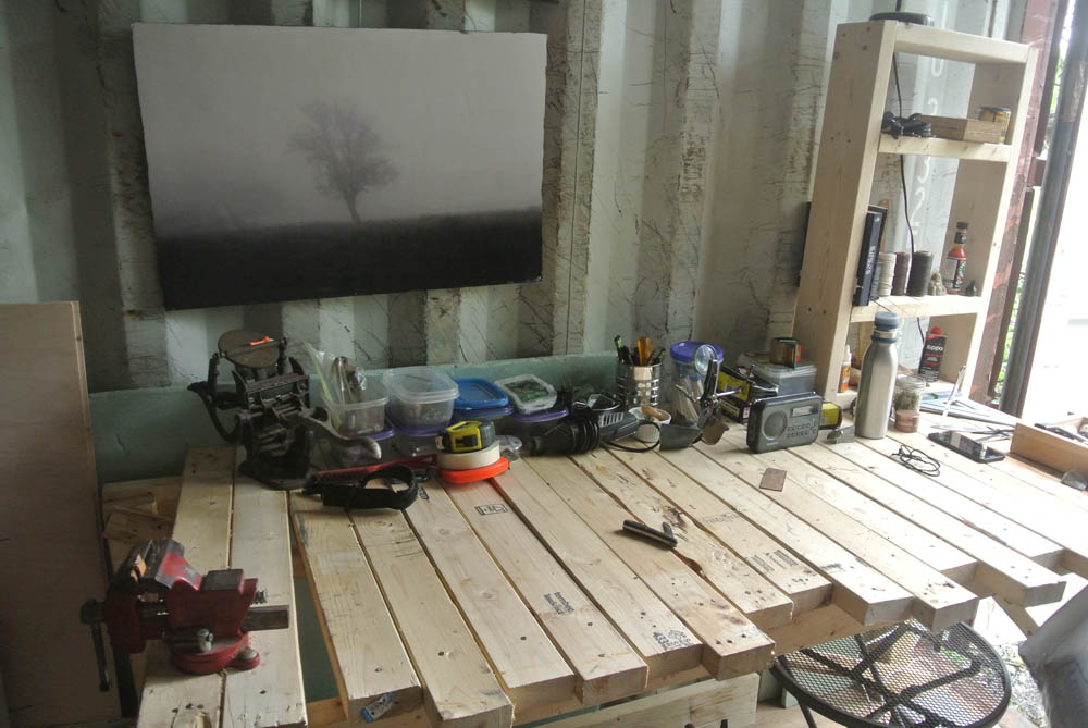

And because I just finished setting it up, here's my new container-shop-storage setup.

Advice well executed and great shop set up.

Your shop/container is a cool idea!
Seriously though, Kaleb is as solid a mechanic as you'll find, and I can see his advice worked out well for you!
