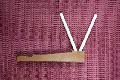

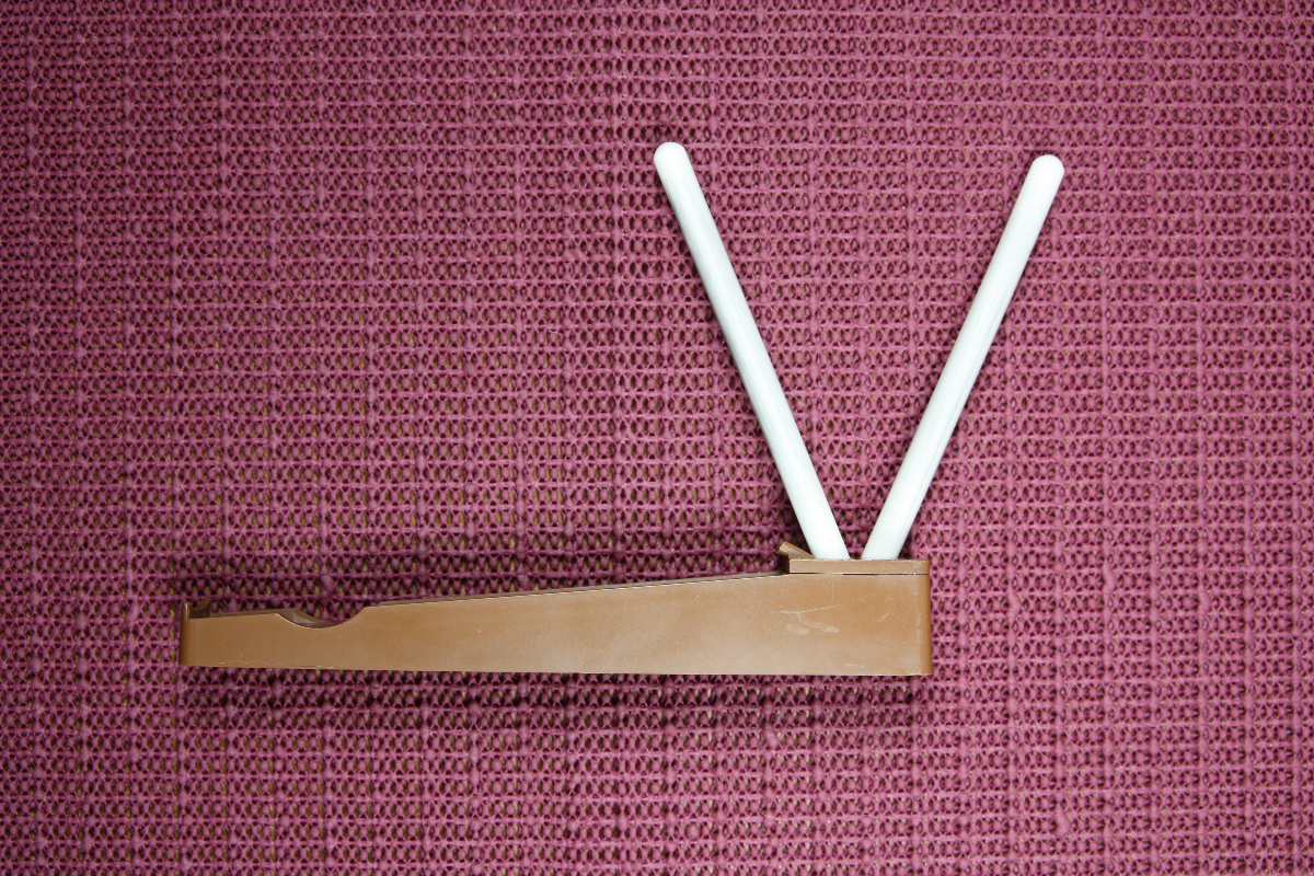

I use this crock stick setup after sharpening with the Lansky to remove the wire edge and really smooth things up. It will also touch up an edge that is still relatively sharp. When I first got it, I had to laugh at the printed instructions that came with it, especially the part about sharpening knives when drunk, partially drunk, or just drinking. But it probably is good advice for everyone sharpening no matter what method you are using.
