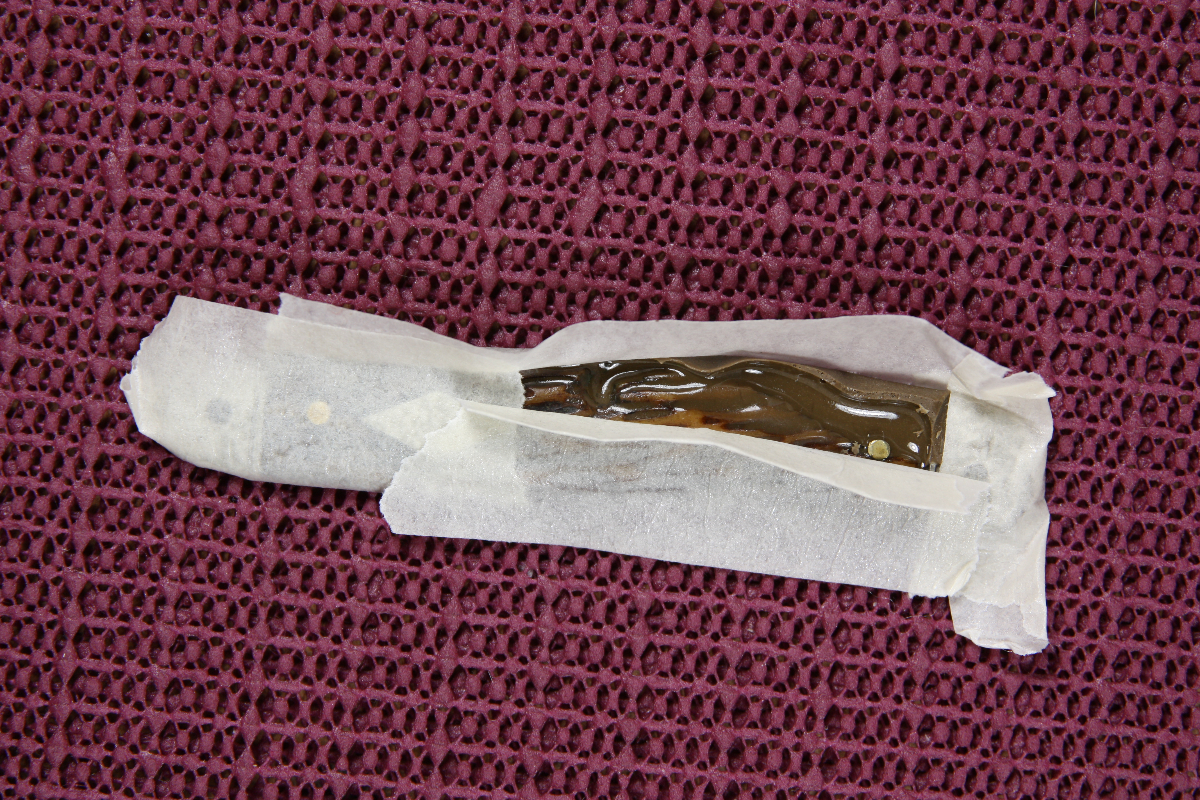

As everyone says...the color matching is the hard part...just tried this one, on an old Western that was broken...
Retention holes and painters tape to keep stuff away from where I don't want it.
This bone had shades of green throughout...I picked up some Mica powers that are made for shading acrylics. I tried marbling the Acraglas, to break up the single tone.
Jigged with a small round diamond bur...it left it just rough enough, that I took a toothpick, broke it in half and burnished some darker shoe polish, in the depths of the jigging.
Not perfect...looks a little better in hand...than blown up in pictures. I think it made it a little better for EDC.
