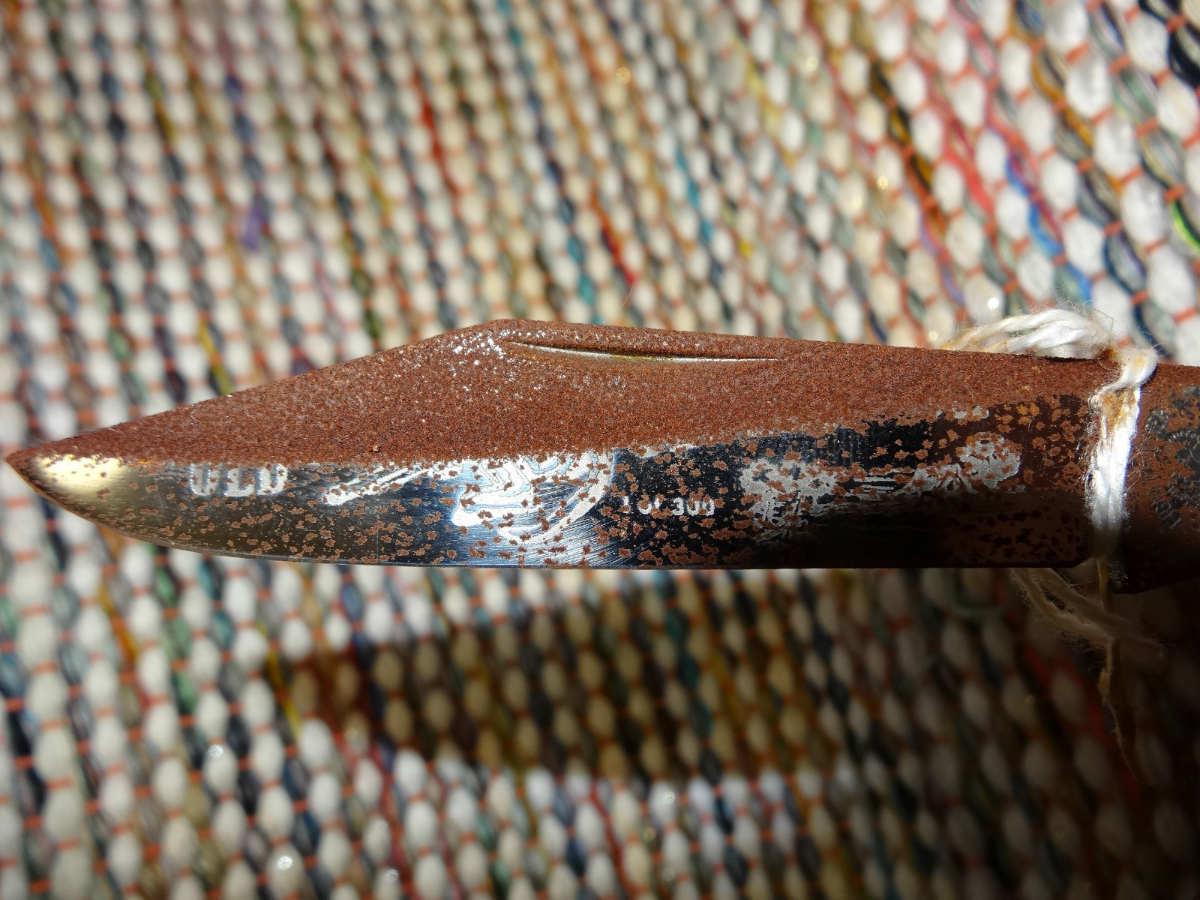

Here is a link to a thread with some discussion and photos of the effects outgassing. Check out page three for the photos.
viewtopic.php?f=2&t=54367&hilit=outgassing

Gassing is a term for celluloid breakdown. Some but not all celluloid is prone to disintegrating and there is no rhyme nor reason why it affects some knives but not others. The Case Classic series uses German celluloid which seems to be problematic yet many 100 year old celluloid handled knives are still in good shape. Many collectors shy away from celluloid handled or scaled knives because of this problem, preferring natural materials such as bone, stag, or pearl. When celluloid breaks down it releases a gas that is highly corrosive and causes tarnish to nickel silver bolsters and liners and does the same to brass while causing steel to rust where the gas settles on it. The celluloid itself cracks, falls apart and eventually turns to dust. This is a shame since many celluloids make beautiful knife scales. The fancier celluloid known as Christmas Tree is very pretty but is perhaps the most prone to gassing. The plain yellow celluloid seems to be much more stable as does black.

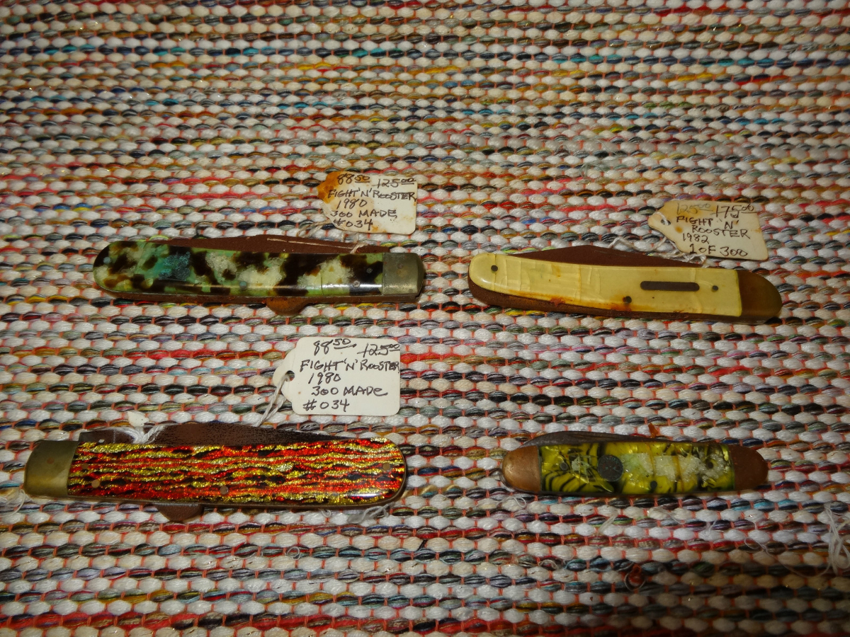

Had a Case celluloid go bad on me once. Easy way to destroy a knife if not taken care of immediately.
example pic worth 1000 words:
https://www.google.com/imgres?imgurl=ht ... mrc&uact=8
Bob

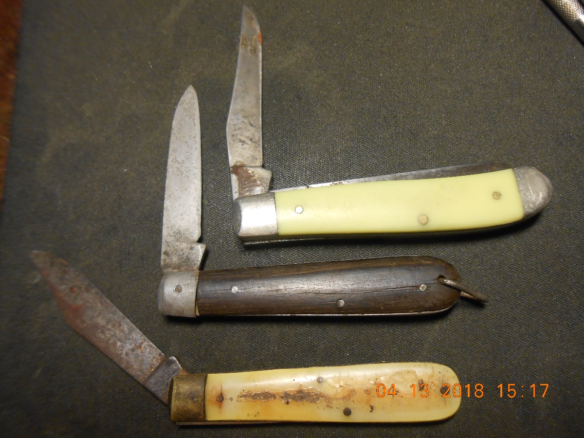

Here's one that I was given a week ago, the one at the bottom of the picture. It's a Case Tested 31024 1/2, I think, and the spring is broken due to the outgassing as well as the handles are shot. The blade could be salvaged but for what?
Treefarmer
Treefarmer
