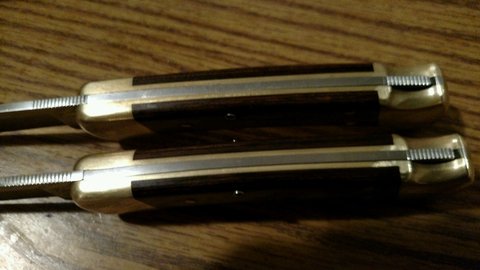

Anyone out there cut jimping into the spine of your 110? I was considering doing it to one of mine and was curious about any positive or negative experiences with this. JB

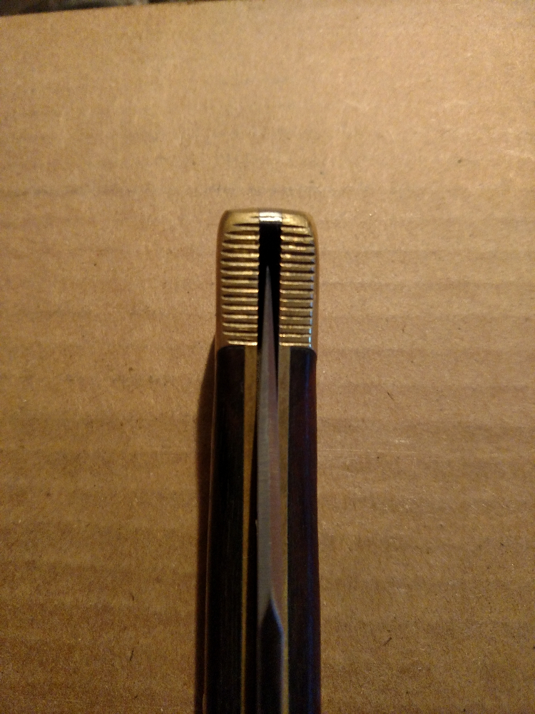

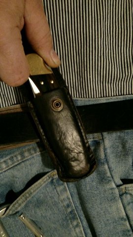

I have a checkering file after I used it for another project I started on my bucket knives.
Honestly I don't use it on the blade, my thumb just doesn't extend out that far. But on the button! What a difference! It not only helps when pushing the button, but gives a very sure grip when pulling it from the sheath.
It helps so much, that on the 110 I use for work, I jimped the rear bolster, were my index finger is in this photo.

eveled, that is pretty neat work. The checkering file; is that a file one would use for checkering a grip on a gun stock?
Will you explain how you cut this in? Did you use a fence or a guide to keep the tool straight? Very nice work.

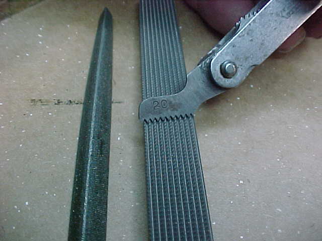

It's not for checkering wood, rather for checkering metal. Here is the other project.
Same file, used in two directions to get the little diamonds.
I put the knife in a vise wrapped in a business card. Then carefully filed being sure to stay in the grooves. The trick I learned is you really need to commit to the first pass to get a set of nice deep grooves to follow, then you can be gentle. The knife is a lot harder than the gun hammer. The file makes multiple lines with each pass, so spacing is not an issue. It will make aprox 1/2 inch of lines, then you can move over a couple of rows to make the area wider, while riding in the grooves you already made.
Nice thing is, If you do it yourself you can make it as deep as you want it. The file cost more than a new 110, but it was worth it.

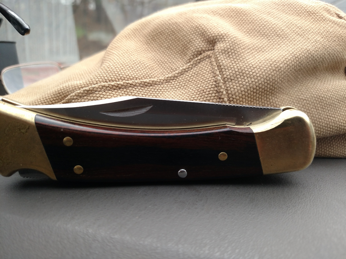

I also recently added a single finger groove to one of mine. I like it a lot, think I will probably do more of them. It's going to be interesting the next time I send one back to Buck for a new blade.LOL!

eveled, what cut and what size file did you use in your work there?
I'm looking at checkering files.
Thank you.

It is a 6 inch grobert swiss pattern 00 cut 20 lines per inch. I found it on Amazon for $31. The fewer lines per inch the better IMHO.
I've found jimping and sharpening choils are better if you do them yourself. The manufacturers go too deep on both.
I liked the subtle effect it has, and did not use a tri corner file to make the cuts deeper, but that is what you will need to get a more aggressive grip.
Be sure to post pictures I'd like to see your results.

Just to follow up, now that I've added the one finger groove , it moves my grip forward just enough to make the jimping on the blade useful.

The finger groove was made with a sanding drum in a drill press. I bought a whole set for under $10 at harbor freight. I picked the one that was the diameter I wanted then just pushed the knife into it.
300bucks, I'm not really worried about replacing the blades again, it took 30 years to wear out 2 knives, now I have more 110's in the EDC rotation, I doubt I'll live long enough to wear out another. It is something to think about though.

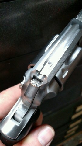

Just curious. It appears that you cut the “hammer spur” off the hammer before you “checkered it”. Is that correct? Most wheel gun hammers have pretty good grip on the spur by default or “stock” factory. My assumption is that you added checkering because you cut the hammer spur off for increased hammer speed or anti snag concealed carry. Mind sharing the details of this?eveled wrote:It's not for checkering wood, rather for checkering metal. Here is the other project.

It's an old school trick. A real bobbed hammer, doesn't have a single action notch, so it is DAO Double action only.
Ruger made hammers like mine for the old Six Series revolvers., They called it a speed hammer. The hammer spur is gone, but the single action notch is still functional. The checking allows the hammer to still be cocked for single action shots.
You start the hammer back with the trigger then use your thumb to cock it.
It is a controversial modification. So I can't recommend it.......

It turned into a fun thread. Be sure to post pictures, and if you do the hammer, be sure to remove it from the revolver, and use a padded vise.

Hi eveled ,
If I used a mini file for this , how easy do you think it would be ? I would really like to try it on my 112 but I am cautious not having tried it before as to achieving a straight file cut !
eveled
- Posts: 2582
- Joined: Sun Oct 29, 2017 9:37 pm
Re: Jimping a 110
I think it would be very difficult with a single file. The checkering file takes care of the spacing and makes sure the rows are parallel.
